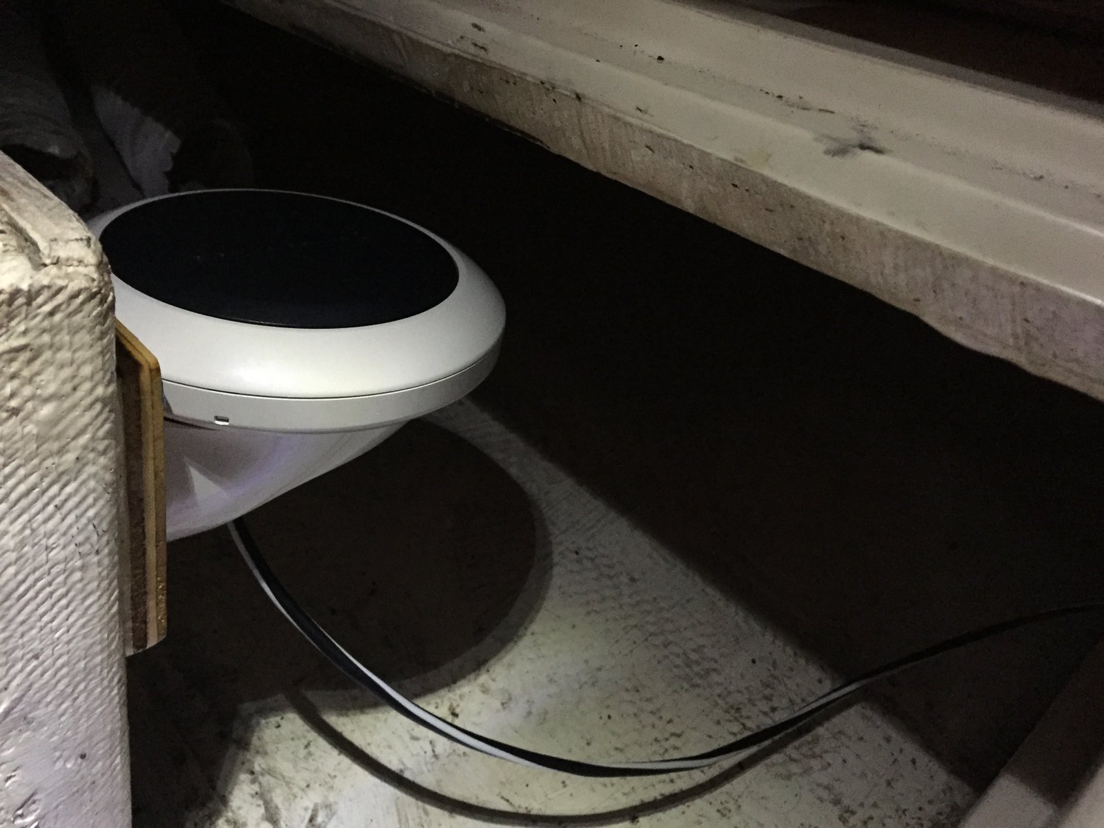

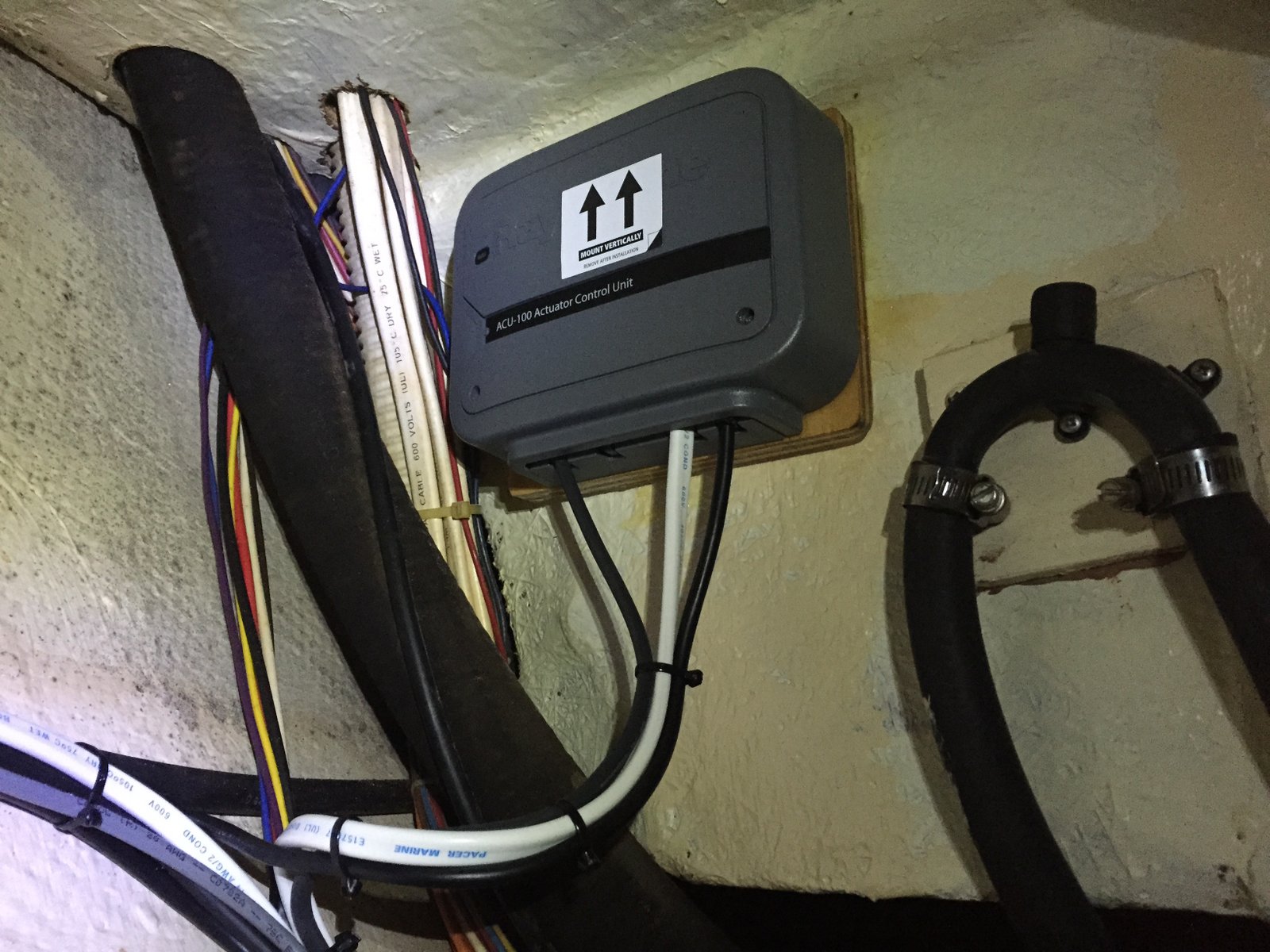

down_shift
Joined: 8/16/14
Posts: 65
On my MK1, mounted the control module in the aft cabin, inside the port storage locker, up high on the forward bulkhead.  The gyro on the port side of the rear center water tank.  No issues so far.  Here are two photos of the locations.
