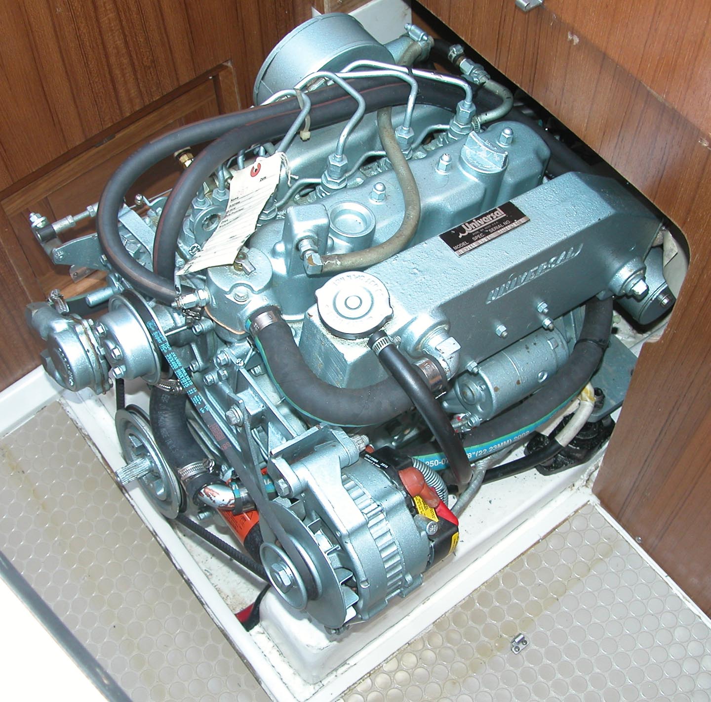

Perhaps you or other readers can confirm my engine model from a photograph.
Here is my engine.

Four cylinder, I would say M35. You can verify by reading the model on the Universal plate that is visible in the picture.

William & All - Given where the raw water pump is located, I think it's just a M35, but not the "B" model.

I have to agree with Craig, on it being a M35. You do not see a gear case either in front under the water pump as a M35 b has. I have this same motor in our 1990 #1057.
