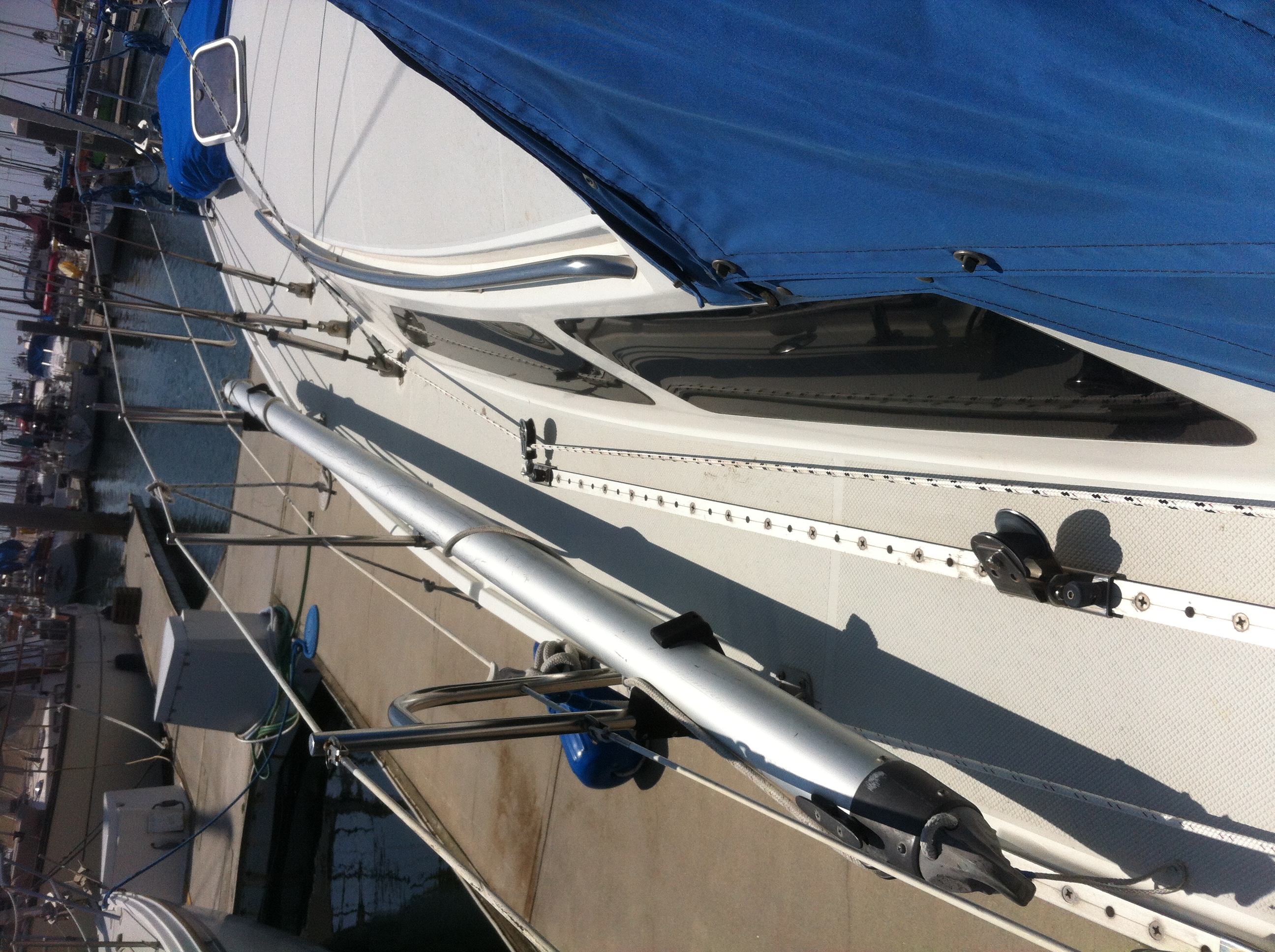

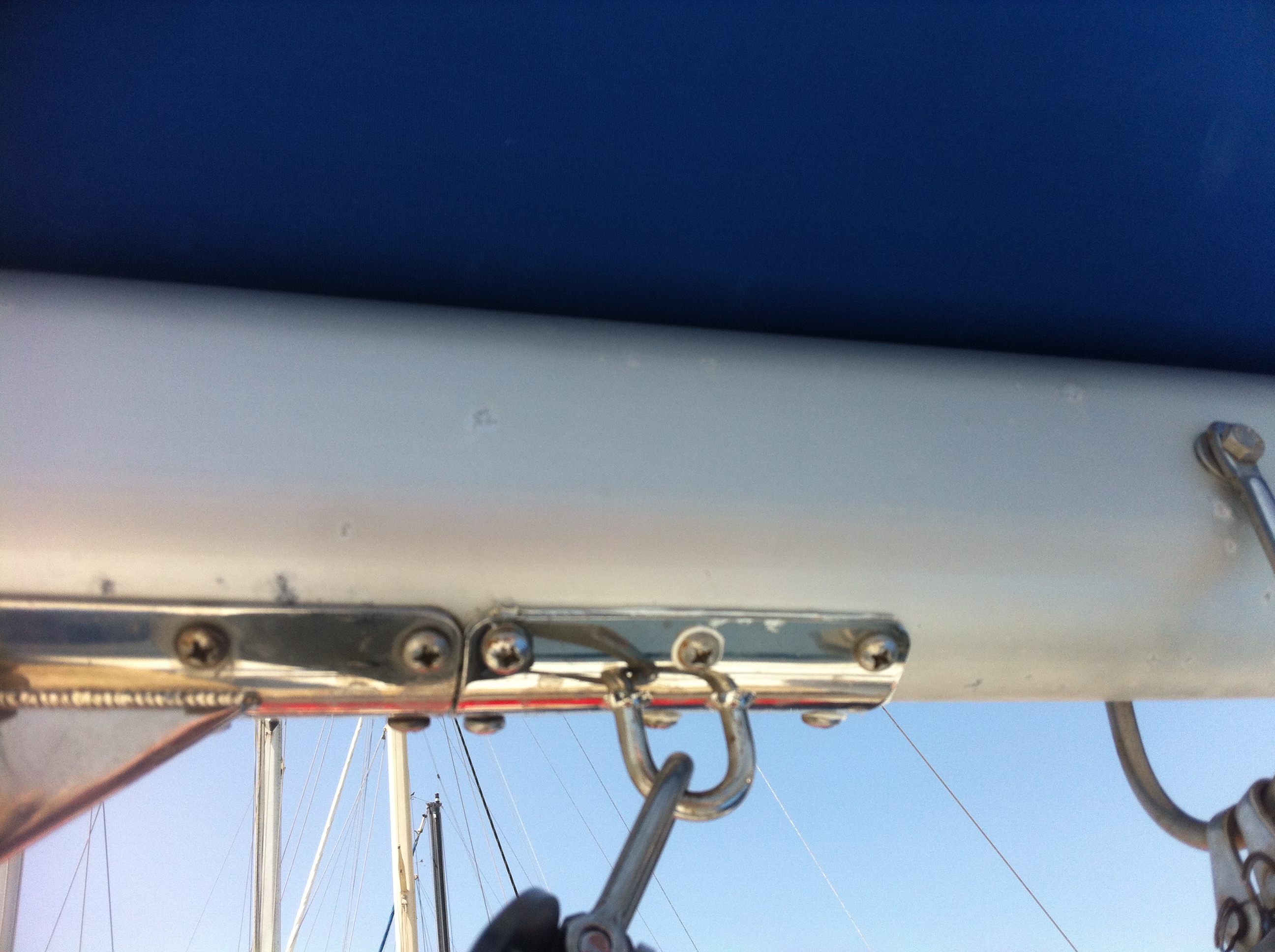

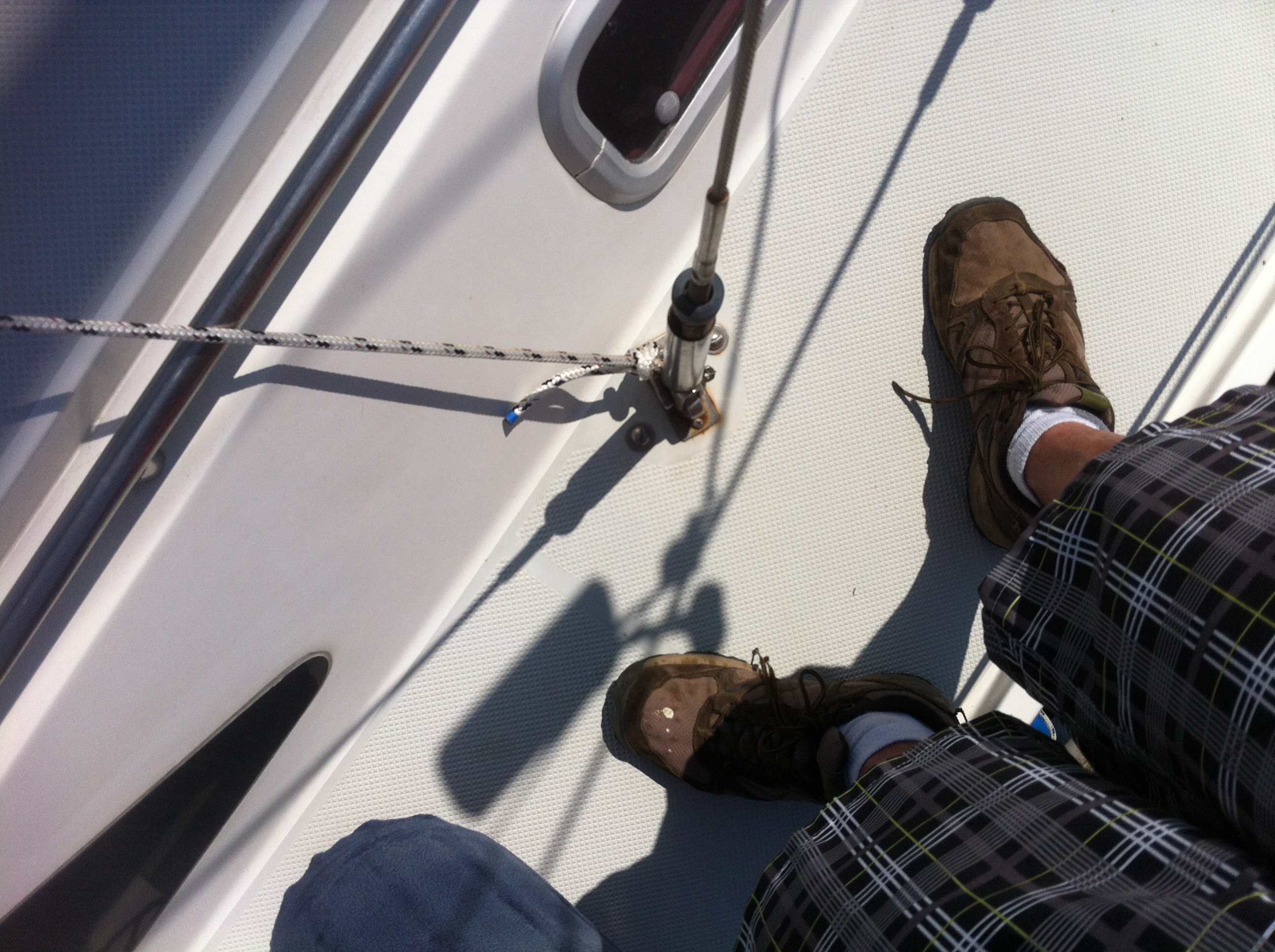

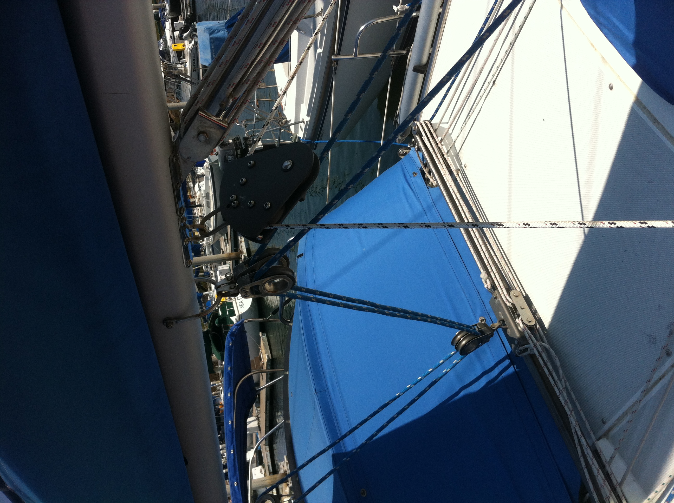

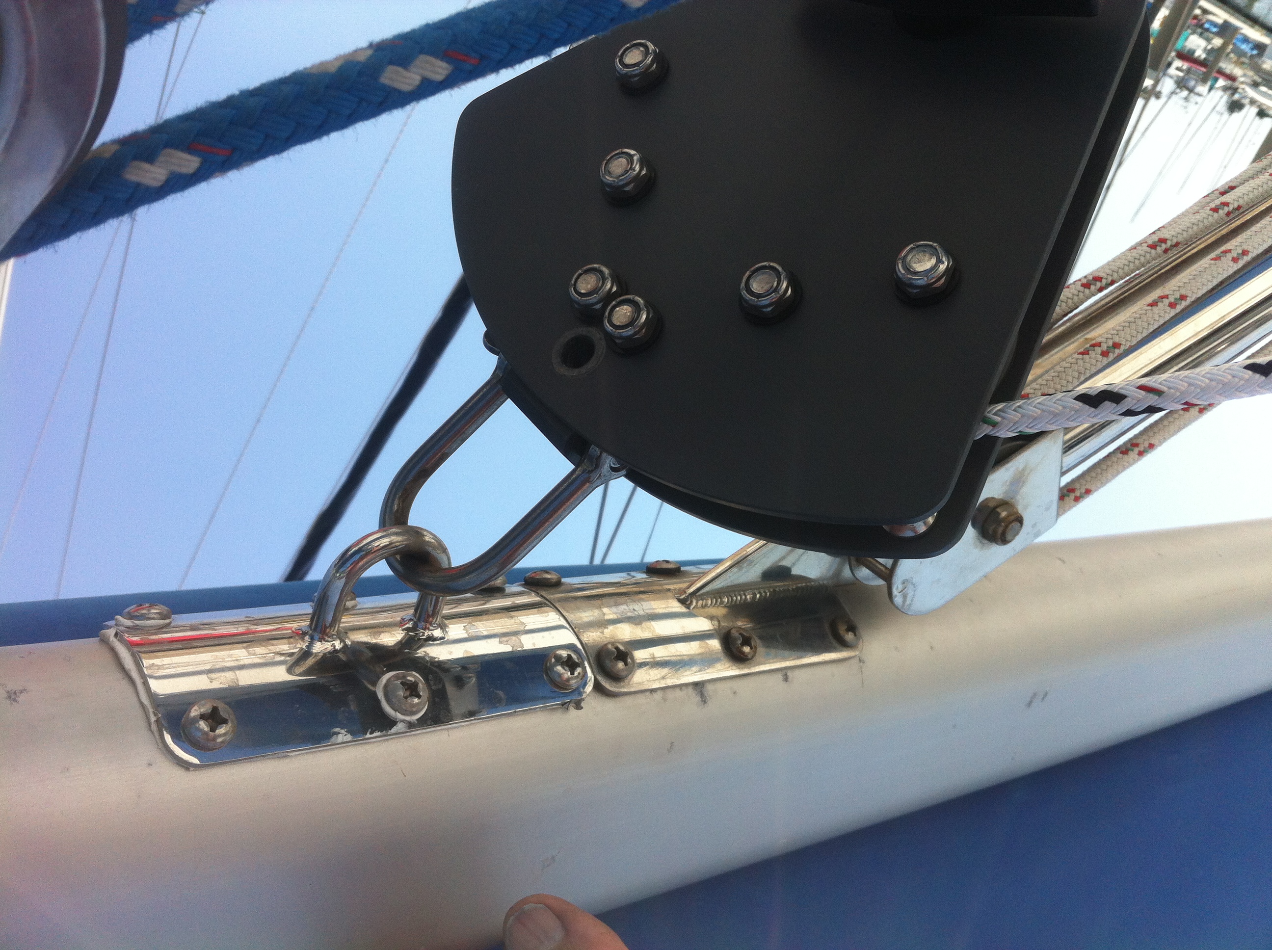

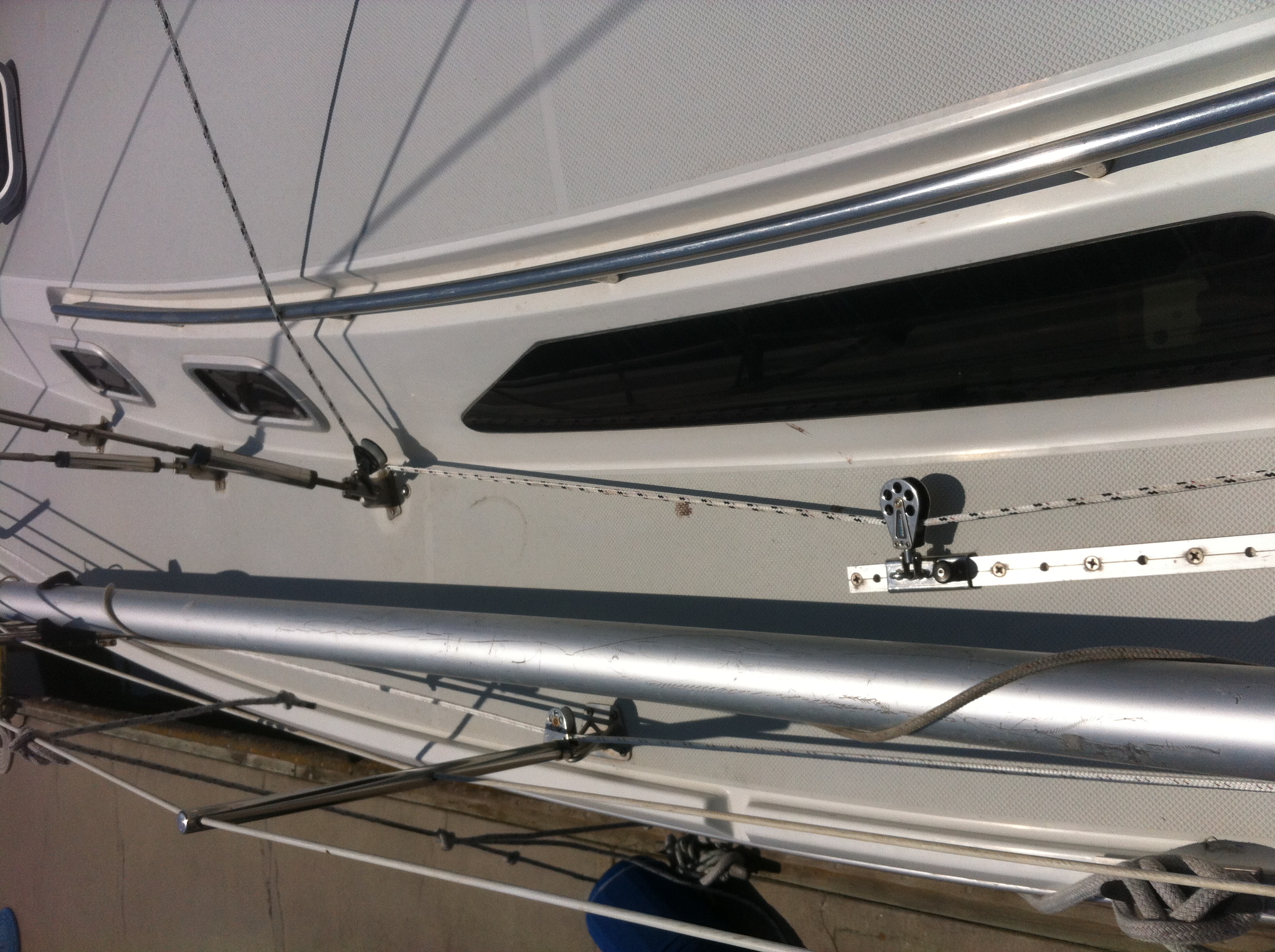

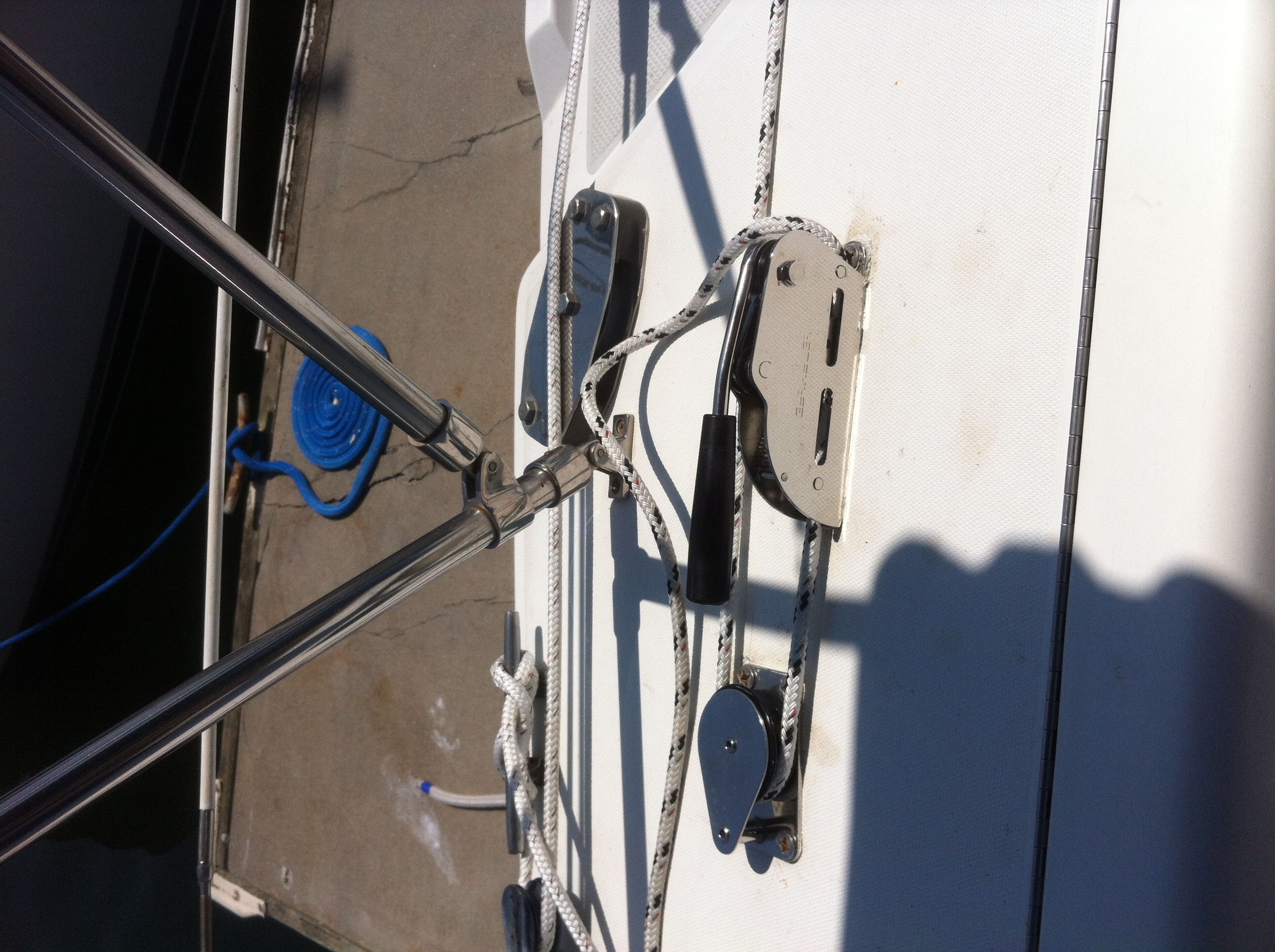

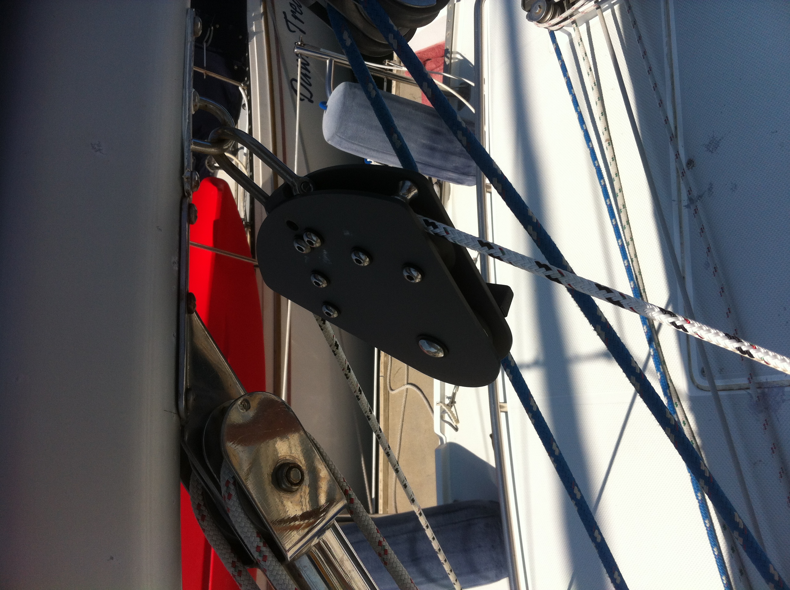

Boom brake pics use phone.

Talisman
Joined: 12/26/07
Posts: 247
Chuck
how did you attach it to the chainplate?  No concerns with a lateral pull on it as opposed to vertical?

clennox's picture
clennox
Joined: 3/31/14
Posts: 212
Yes, I used a shackle on both aft Chainplates. Many other C 36's are rigged the same way. Dutchmen recommends chainplates, toe rail or a pad eye.. The load doesn't same too bad. Time will tell
Getting the arc to be just right is the real trick.I had the bracket made for the boom.  The only thing that bugs me is that the line rides the SS hand rail. The line doesn't move, but it still rides a little.
I really like so far.
I mounted the clutch so I could use the Main winch or even the cabin top. You don't really need a winch unless you want to totally stop the boom.
 I find myself jibing more than ever. Going fwd just feels safer. At anchor the boom is steady and not dancing around. Just a new tool to play with.
