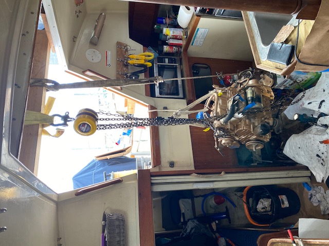

I did this repair a few years ago on our  former '85 C36.   I thought I'd need to remove the engine, but turned out all I needed to do was lift the engine a few inches.  Did not disconnect the transmission, but did disconnect the shaft coupling and the exhaust riser.
 Reaching under to get at all the bolts was not easy, but definitely do-able.

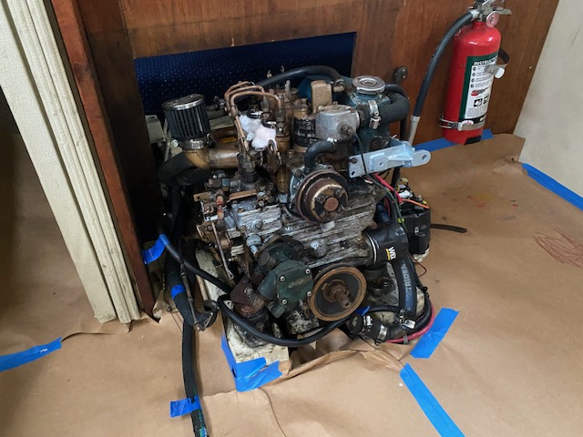

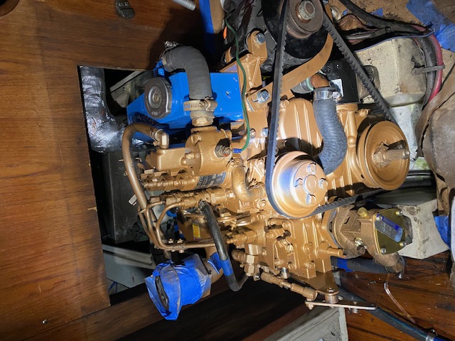

Thanks for all the help on this job. I was able to lift the motor and get a new engine pan, upgraded alternator bracket, raw water pump, and paint job complete.
Here are a few pictures of the before/mid/after.
Mark
