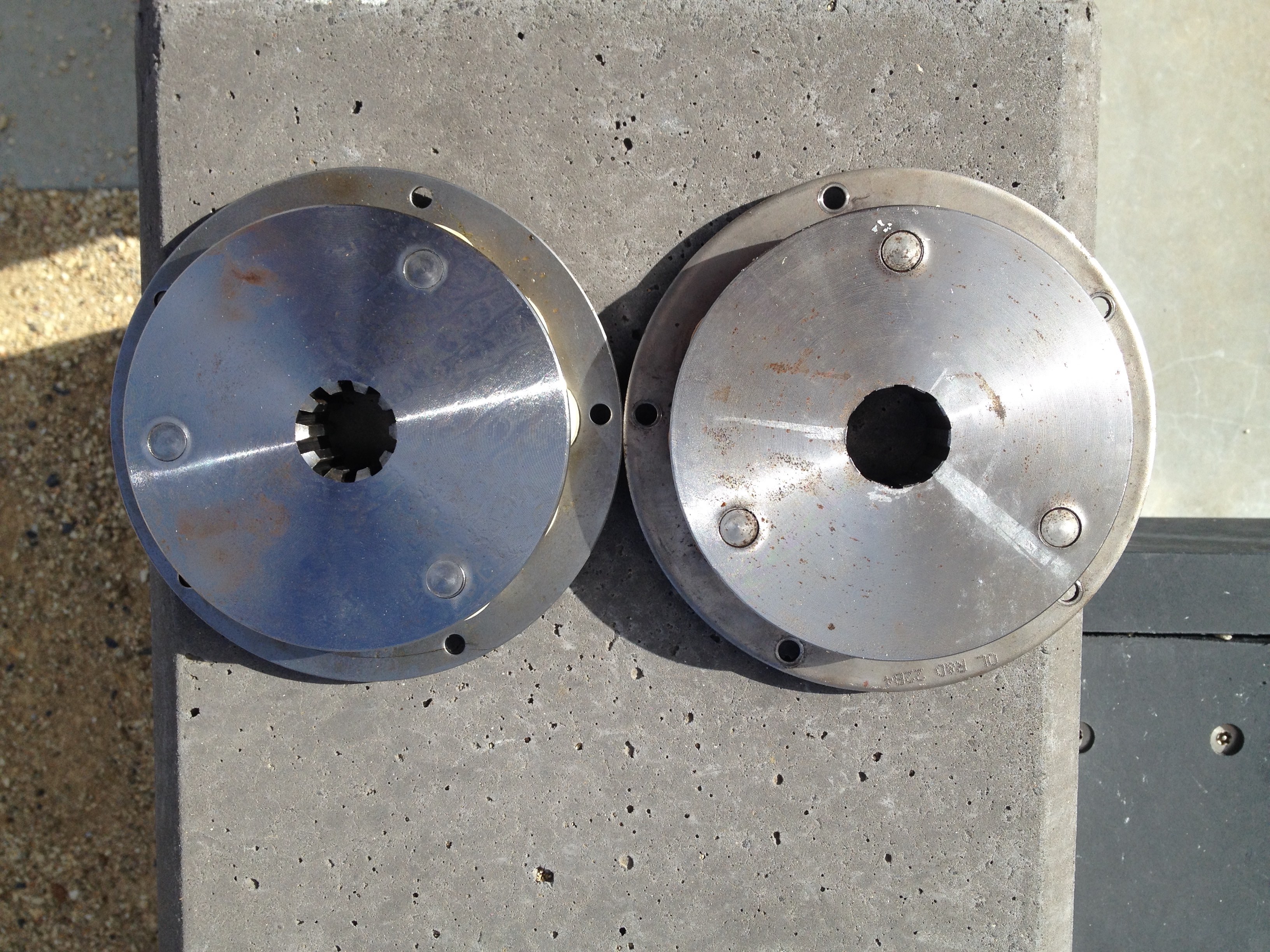

Thought we should pass on our experience with a damper plate issue.
Our engine has done 1200 hours and suddenly we lost all drive.
There was no excessive noise that forwarned us.
Pulled gearbo, which was ok.
Pulled damper plate and found total failure.I have attached photos of old and new.

Wow that’s horrid. I’m surprised it didn’t clatter. I’d be conserned about the splines on the transmission.

No real clatter at all and the gearbox spline is ok.
It would seem that the metal in the damper spline was particularly soft.

There is no problem with shaft prop. or gearbox.
All properly aligne and spinning freely in nuetral.
One mechanic who looked at the plate suggested that the spline may have not been properly hardened.
The housing contained a lot of metal filings.
I obtained the new plate locally in Hobart. It is identical, with the same numbers and markings. I understand that they are made in the UK and imorted in Australia.  Cost A$290.00.

The damper plate was the original and the same as the one you provided the link to.  I understand they are manufactured in the UK. The US price seems verry high.
I am now satisfied that the plate wore prematurley and that there are no other issues before or after with the rest of my drive train.
