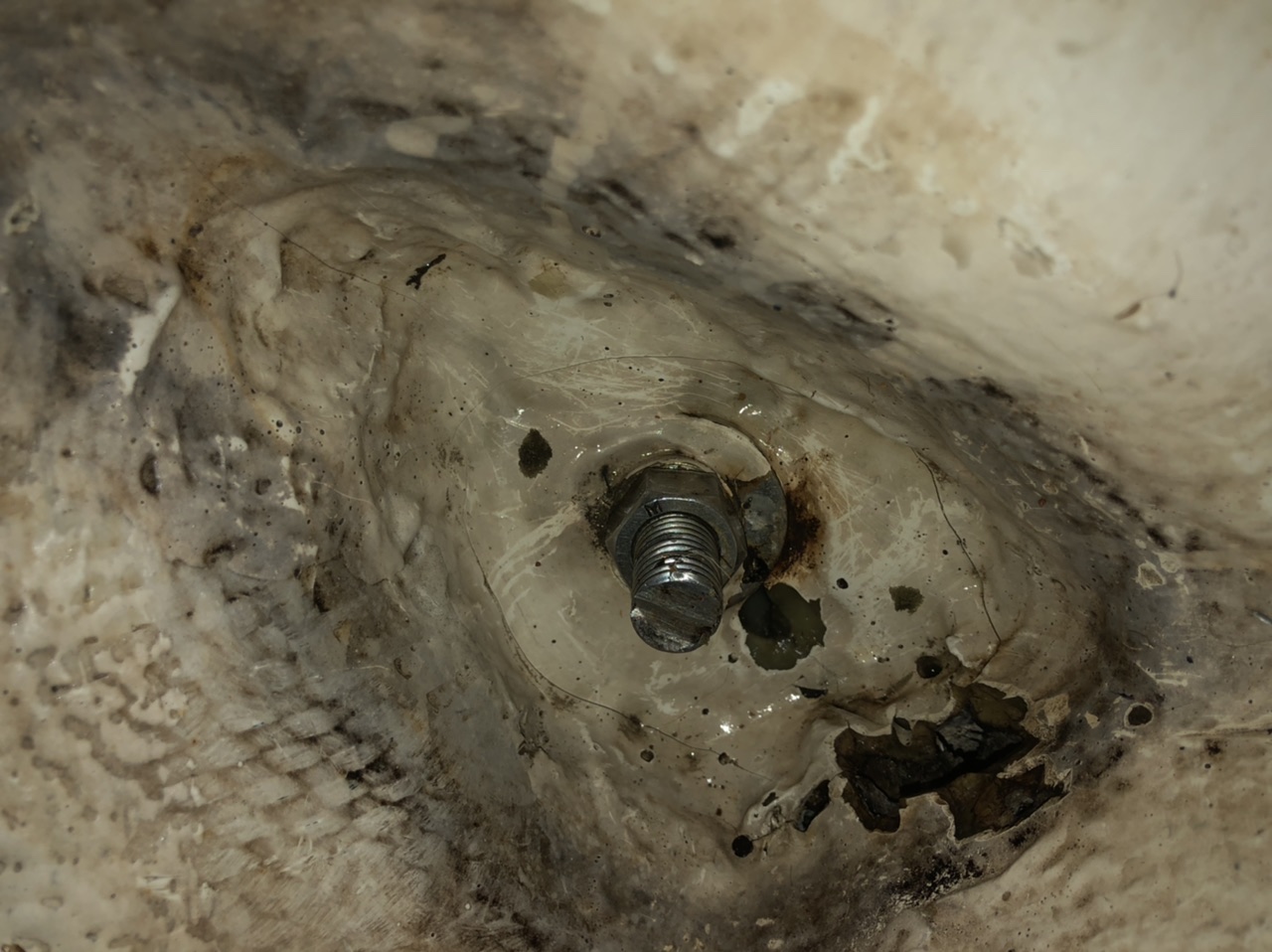

Dear community,

But now we found something new.

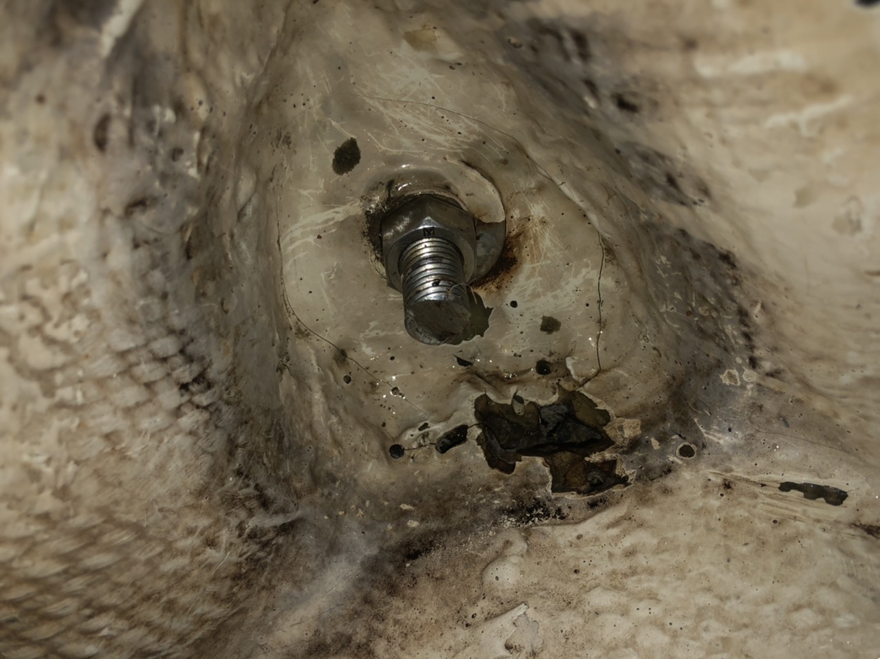

The forward keel bolt has cracks around it.
No water is coming in and the general condition of all keel bolts seems pretty good. So we are wondering where those are coming from. Are those indications for a Catalina smile or worse?

Hm.  We have some similar stress cracks in our hull, though not at the keel bolt.  Likely due to over-tightening or an impact with a rock, or being lowered too aggressively onto a cradle.  You could use a Dremel tool to open the cracks up a bit and fill with gel coat to monitor over time, but I really doubt the cracks are a problem -- the rest of the keel bolts are holding the keel in place.  The Catalina smile only occurred in the early to mid 1980's vessels due to the use of a piece of plywood under the fore-most keel bolt that rotted away.  If you have the boat hauled out you can check for a crack around the front of the keel, but I really doubt you will see one.  Let's see what others have to say, but I don't think you have anything to worry about.

Thanks Kevin, that doesn't sound too bad.
what do you mean with monitoring over time? When it's filled with gel coat how will we see differences?
