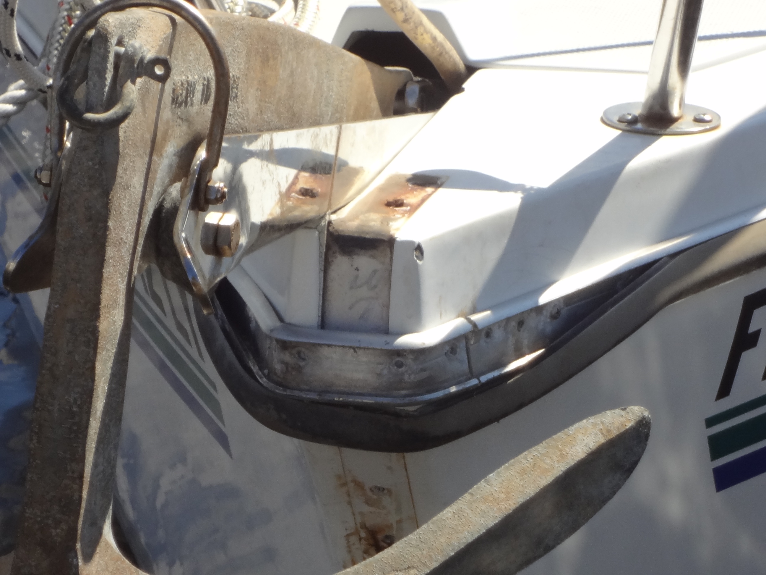

For a progress report, after much discussion with the riggers and considering what some of you suggested, the rigger was able to pull the rubber rub rail out of the aluminum track.  He then removed several of the screws attaching the track to the hull and made a single cut with an oscillating saw on the port side. This allowed him to move the track enough to remove the stem fitting without bending or otherwise creasing the track.  Once this is reasembled, the slot where the cut was made will hardly be noticeable and should look like the other joints along the track.  I have sent the fitting off to Garhauer and will report back when it is returned and installed.

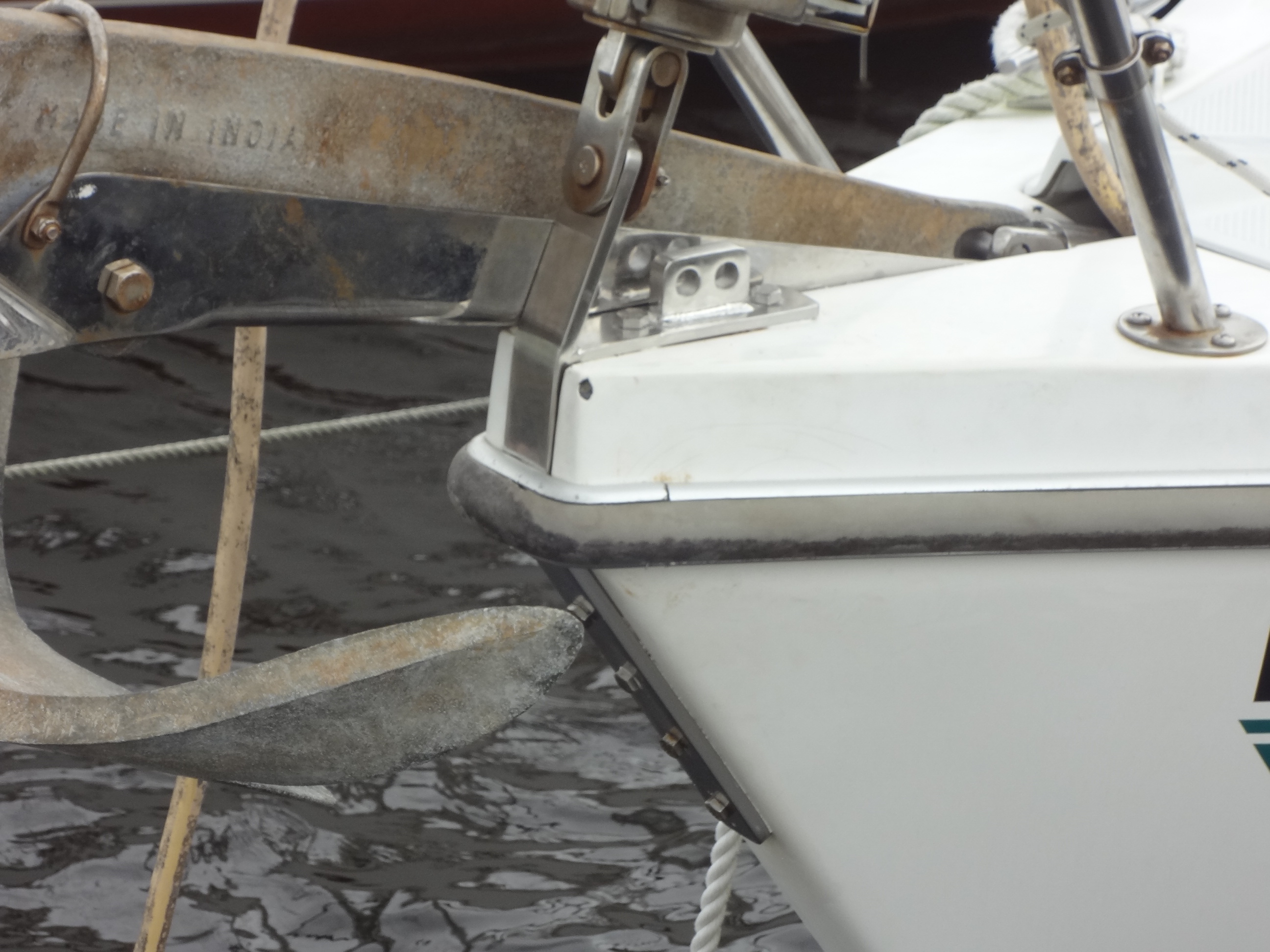

This project is done.  Once the riggers removed the stem fitting, as previously reported, I sent the fitting off to Garhauer to fabricate a new one.  which was returned to us within 11 days.  It was certainly more robust.  The only issue was that the mounting holes on the horizontal portion did not line up with the holes in the deck.  They were also larger, 3/8 vs. 5/16.  After addressing that issue, a terrific fit.  From the attached picture, you will note that the rub rail track went back perfectly, as did the rubber rub rail.  The cut in the track is only noticeable by me.  Although I do support Catalina Direct and have used it in the past, Garhauer provided superior service at less cost and faster turn around time.
