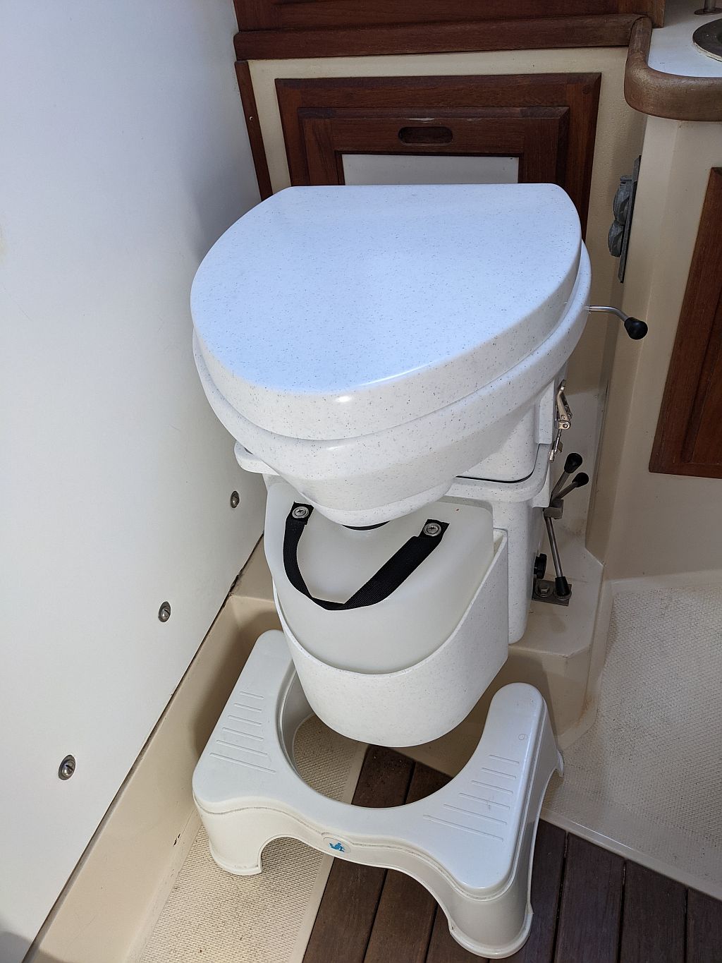

I installed my Nature's Head composting toilet just in time for a weekend cruise. The main issue as can be seen in the picture is that it's way too tall to just replace the original Jabsco. In the picture you can also see a 7" Squatty Potty stool which makes it somewhat usable. On the plus side we really liked the experience of having a composting toilet and forgetting about sewage smells, pumping out and the occasional overflow through the vent...
I have started the process of rebuilding the toilet platform to be as low as the hull allows, which should reduce its final height by about 4". I can share a bit of the process if there's interest.

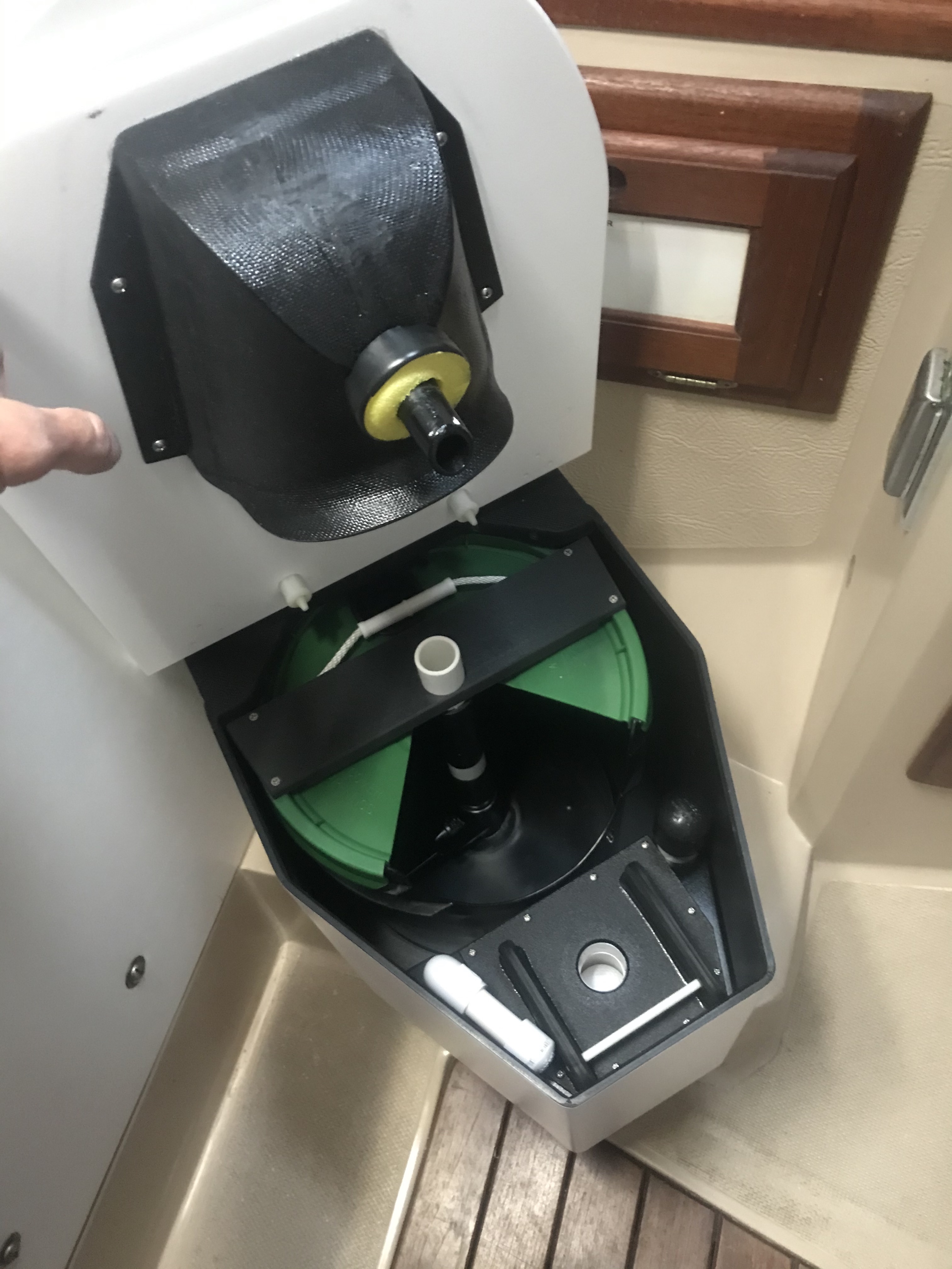

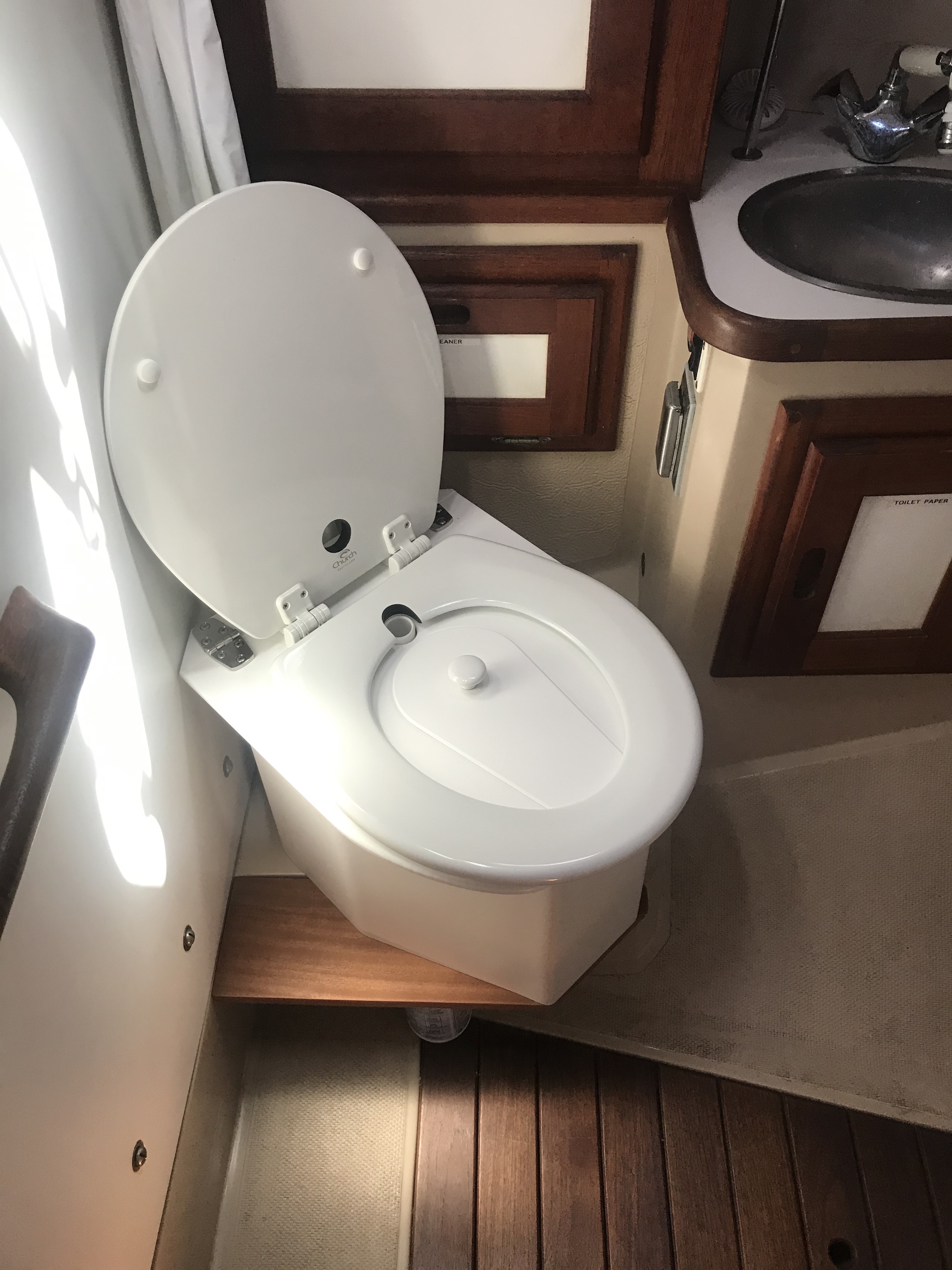

So we went with the C-Head composting toilet and it looks great, simple and very clean.  Here's some photos of the install.  We toyed with position on the pedestal for quite a bit to see what seemed the best and we liked the idea of having it more square to the wall which is angled and immediately to your right when you enter the door.  It provides hand holds via the standard one to the aft on the bulk head as well as the sink, it makes you feel locked in there.  Anyways, if we don't like that after a bit it will be quite simple to turn it to the traditional orientation.   The head itself is only 15" tall, we don't need a step for our feet, only the 13 y/o kiddo's feet don't quite reach the ground, but its a simple fix as others above have noted with the squatty potty or any small step.
