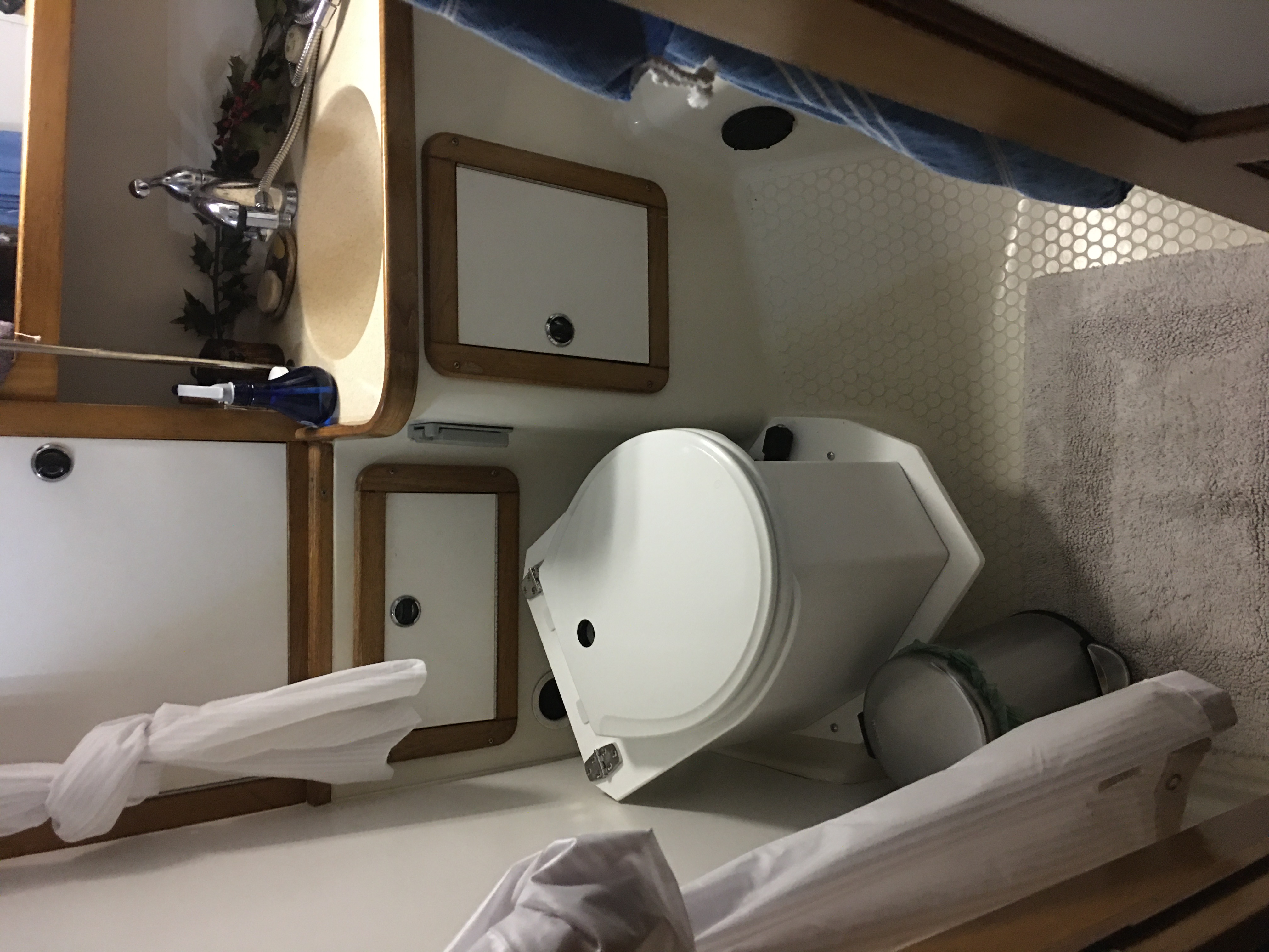

We installed a C Head shorty last December on our live aboard and are very pleased.   Very easy to empty. All I do is place a garbage bag over the top of the bucket and flip it upside down.  Done.  Takes about 15 seconds.  No smell. Nothing gross about it if I don't let myself think too much about it. We use coconut coir as medium which we buy at pet stores (used for reptile cage bedding).
My 5'3" first mate still uses a little step for comfort. Another tip:  in the photo below you can see a small spray bottle.  It holds water which we use in the urine catch after each use.  Simply gives it a little rinse/flush.
We expanded the base the toilet sits on with starboard. I first made a pattern from cardboard.
We also found that placing the head on an angle created more literal elbow room.  And, surprisingly, it looks great in the head as it sort of completes a "circle" given the angle of the door to the v-berth.
Dale and Nikki
1998 C36 mkII SR hailing from Poulsbo, WA
1989 C25 TR/WK

Thanks Dale!  I appreciate this.  looks like turning on an angle it gives the most room to the user.  I will probably do the same.
