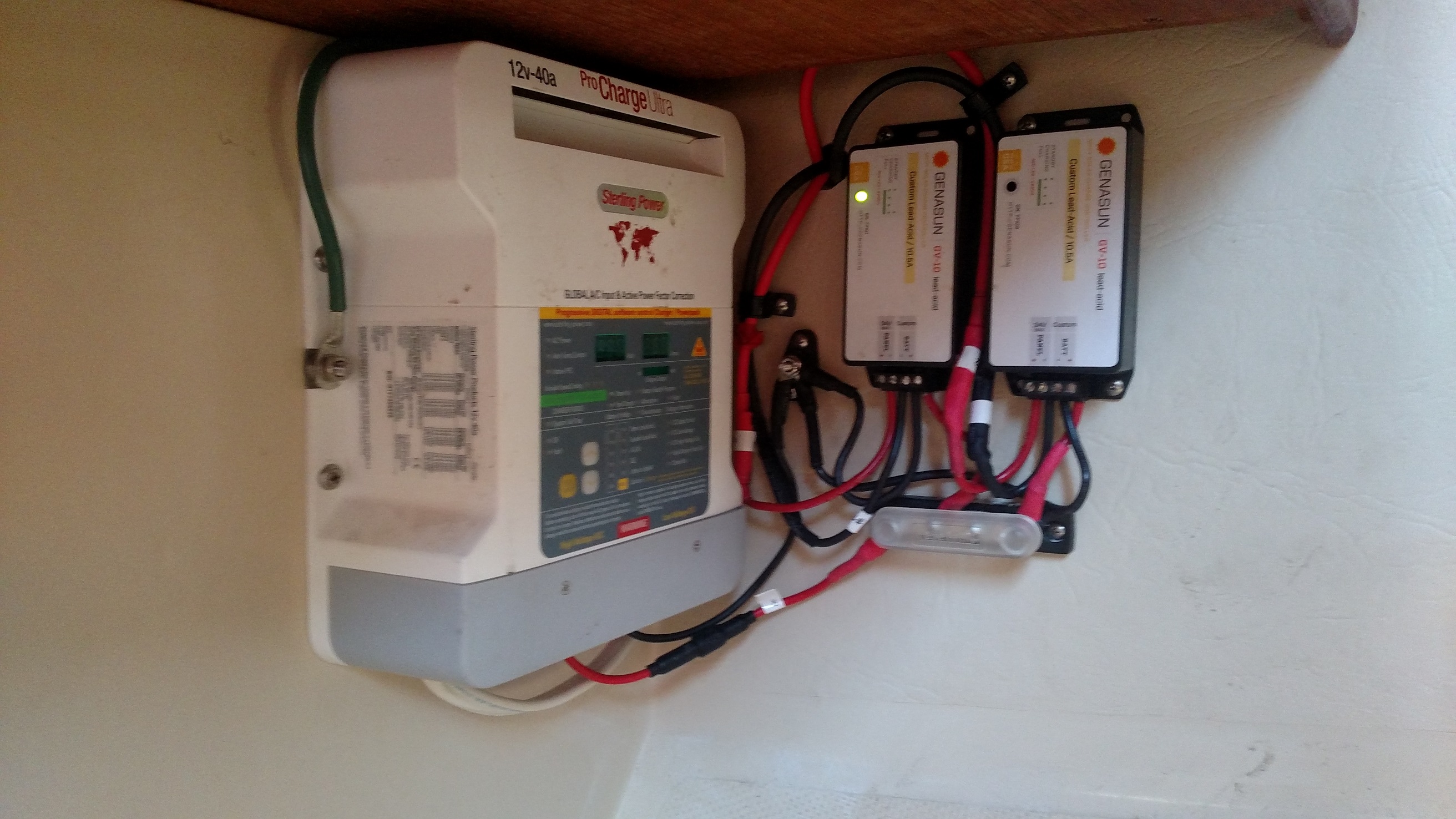

I’m very happy with the Sterling 40 (same as pro Mariner). On my mk1 I mounted it under the nav table and placed the remote above the switch panel.  I got mine for Main Sail (marinehowto.com).   The site has great info on considerations needed to install the charger safely and best for the batteries.  He is a frequent contributor here and past Catalina 36 owner
p
[quote=LeslieTroyer]I’m very happy with the Sterling 40 (same as pro Mariner). On my mk1 I mounted it under the nav table and placed the remote above the switch panel.  I got mine for Main Sail (marinehowto.com).   The site has great info on considerations needed to install the charger safely and best for the batteries.  He is a frequent contributor here and past Catalina 36 owner
p[/quote]
Ditto to everything Les said (including location - see photo).
