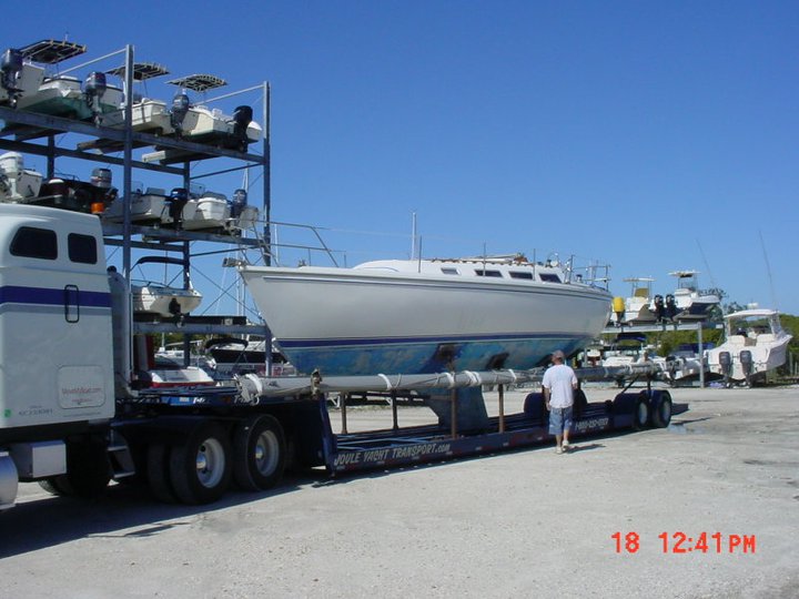

Catalina 36s are routinely trucked around the United States.  According to this thread the height is around 12': https://www.catalina36.org/forum/general-discussion/honest-height-keel-p...
Here is a picture of a fin keel version loaded on a semi-tractor trailer: https://www.catalina36.org/sites/default/files/forum/168119_187230541296...
