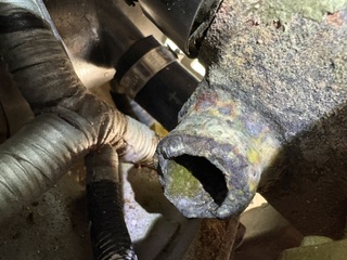

I'm replaced my coolant lines yesterday and couldn't believe how corroded the exhaust manifold fitting was for the hose between the manifold and heat exchange.  See pic.  It has lost a chunk from the bottom and looks like it could crumble any day.  I cleaned it up the best I could and was able to get a new hose on and tighten the hoseclamp as per normal.  The other fittings for the other hoses looked ok.  I ran the engine for a few hours and temp remained at 165F with zero leaks.
So, my first issue/question is:  clearly I need a new manifold.  I think this'll probably last me through the season but I can't see this lasting more than a year.  Who knows, but not a risk I want to take.  I did a quick search and looks like new manifold will run me around $2300.. ouch.  I'd outsource that job (though if someone here has done it and it's not brutal I could do myself).  but figure around $3K with labor if I hire someone.

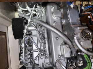

My other question:  while running it yesterday at temp, I was in the aft cabin watching for leaks.  And, I noticed an almost imperceptible vapor/fog/steam/smoke (?) coming from the breather hose that comes from top of crankcase.  First off, the hose is sitting right next to the air intake and I'm guessing that's not ideal as it's just recirculating whatever is coming from hose.  I'd say there's a very faint exhaust smell, but no more than usual for a diesel.  CO detector in that cabin hasn't alarmed, for what it's worth, though I understand there's not as much CO in diesel exhaust compared with gas.

The level of corrosion on the manifold does look odd. I wonder if plain water was used for coolant in the past? I pulled our manifold off on our Universal M25 on our Catalina 30. I had to do it because the iron pipe exhaust elbow needed replacement and the only way to break the rust holding it was to pull the manifold and have a shop wrestle the elbow off.  The manifold removal really wasn't a lot of work. Use penetrating oil on the bolts. Drain the antifreeze prior to the work. The M35BC is a similar design to the M25. You will need a new manifold gasket.
Regarding the engine condition. It is normal for a slight amount of oil vapor to be released from the crankcase. It should be a light colored vapor. The vent hose near or, in the air cleaner is common  so that the vapor is sent into the combustion chambers rather than into the boat. I can't recall if our vent hose is directly attached to the air filter housing.

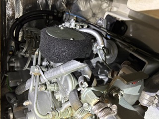

In your picture, it looks like there's a hose that's been cut at an angle and ends next to the air filter. It also looks like this hose originates somewhere from the front of the engine. This doesn't make sense.  I wonder if something other than crankcase fumes are being vented?
The crankcase venting should originate from the valve cover. The M35BC crankcase vent hose originates from the back starboard side of the valve cover to a fitting on the air intake behind the air filter. This design prevents oil vapors from clogging the foam filter.

Paul- I think you're correct about water having been used at one point.  It just seems like a crazy amount of corrosion and if it was circulating tap water chronically perhaps this might result.   That hose does originate from the crank case- but the port side of the case itself and not from the cap.
