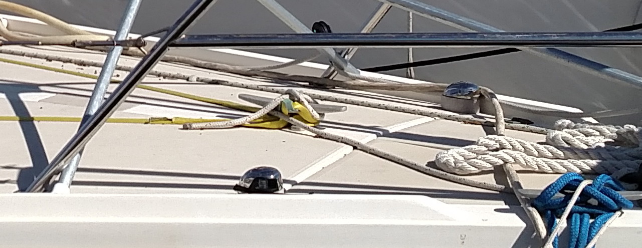

One possible work around to consider:  On our '85, the location of the bow light was such that it was very vulnerable to damage (our slip is head-in to a bulkhead, and inevitably every year or so the thing would get smashed).   We eventually replaced with seperate port and starboard LED lights, mounted on the deck on raised wooden blocks, somewhat forward of the aft legs of the bow pulpit (see picture).   Problem solved (and no need to thread wire through the pulpit tubes).
