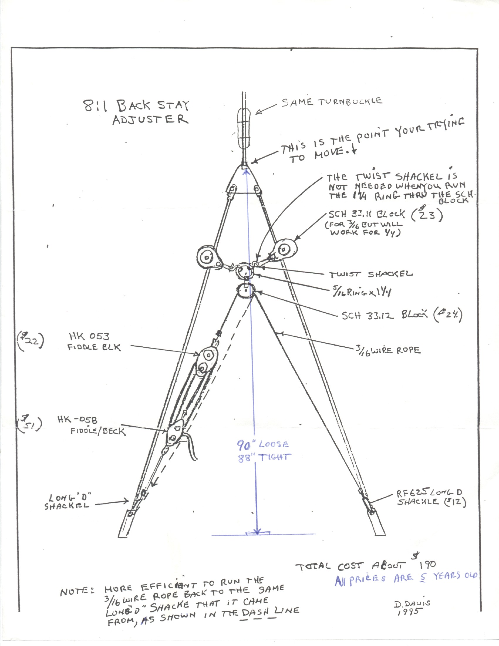

I respectfully disagree with bb. The adjustable backstay is perfect for providing just the small amount of added tension to the forestay, even with our "telephone pole" masts. We have a Garhauer backstay fitting with a 4:1 Garhauer vang on it, works great. We moved the backstay split WAY up to eliminate the head banging from the old split. The drawing is different than the install and is meant to show moving the split up and various other ways to make an adjuster.
Don't have one on my boat yet, but I have extensive racing experience on other boats and I am certain that the C36 would benefit from a backstay adjuster. It is not for adjusting mainsail shape, it is for controlling headstay tension. I made this change on my previous Ranger 29, which also had a tree trunk of a masthead rig and it changed the boat dramatically.
Another benefit is you can sail with adequate rig tension but let the backstay off when the boat sits at the dock, which de-stresses the whole boat, and the mast step in particular.
