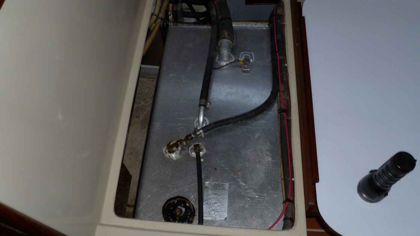

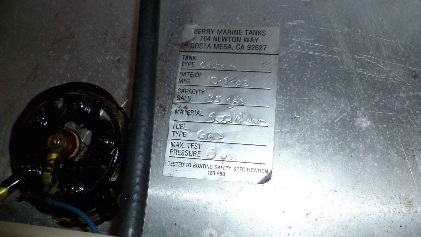

Coast Rider, I'll rest easier on your behalf now that you're not adding ATF to your fuel.
But you say a 35 gal fuel tank was added to the boat. Now THAT intrigues me. If you ever gain access to it for photography, how about sharing a couple photos with the rest of us?
Happy sailing.
Coast Rider's picture
Coast Rider
Joined: 10/17/14
Posts: 43
Here are the photos Larry....35 gallon tank on my 1986 Cat
Coast Rider
Joined: 10/17/14
Posts: 43
Hi Larry,
Mitchman installed a 32 gallon tank he ordered from Catalina Direct. See his posting above yours. I'll try to post a photo of my tank. Could be one reason my boat lists to port.
