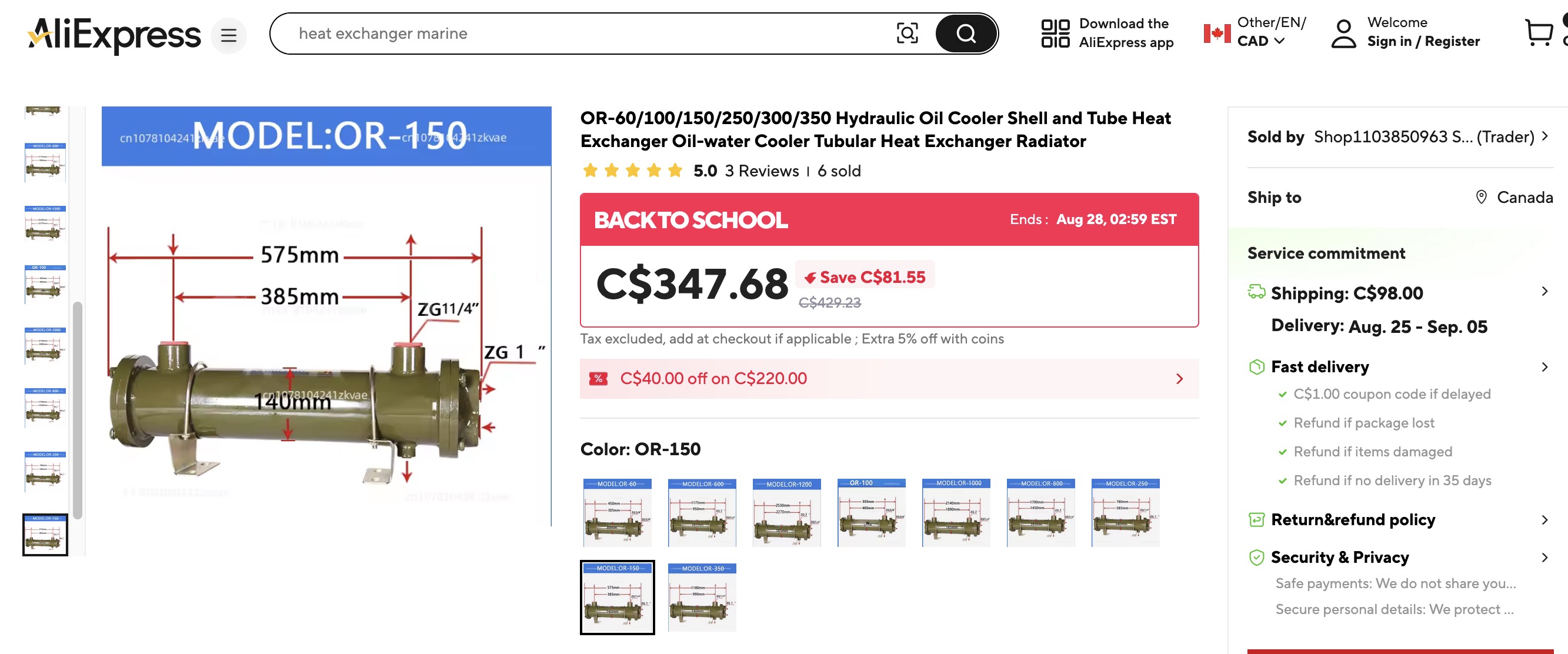

So it's SUPER frustrating to read so many fellow owners repeat that, as was the case during my early years of owning this old girl, they can run up to 2300 RPM at ~180 degrees (buries the transom above 1800 RPM and gets to max hull speed at about 7-8 MPH, but you could probably pull a wake-boarder...).  My last remaining effort (I'm pretty sure it's not a wiring or gauge issue since the IR gun confirms the temps, but I'm open to suggestions) was to consider a larger heat exchanger, but reading more posts here it sounds like the HEX we have is already the larger 3" diameter by 17 5/8" length vs. the earlier M25 size.  I'm not seeing any references to larger ones being used on the M35 to address the problem from anyone else, so I'm back to square one, not understanding how my system has been 'corrupted' over time without a workable solution...
I have seen some lower cost HEX options I could try from China, but it seems like there must be a solution if other C36 owners with the same engine are operating in tropical salt water at NORMAL coolant temps.
