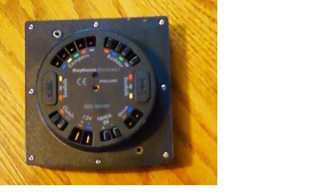

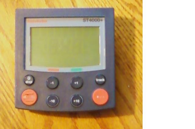

It's an ST4000+ control head. I took a couple lousy cell phone pics, just so you can see it. The text on the buttons is somewhat worn and there is a very slight scuff in the middle of the display; smaller than your little fingernail. I think the connections on the back are the same as the ST4000, but you can check the pic.
PM me and make me an offer. I'm not looking to make money on the thing but it's doing no one any good sitting in my attic. I'm assuming it works; it did when I replaced it with the S1 a couple years ago. That was primarily due to my old black drive failing one too many times. BTW, I have a spare belt for the black drive, but that's on the boat, I'd have to mail that later as I'm not going to be there until later next week (I know where that is too..!!).
