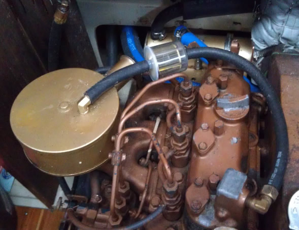

I put a $2.00 clear fuel filter in the breather line. Works great and I can see if any thing gets caught.

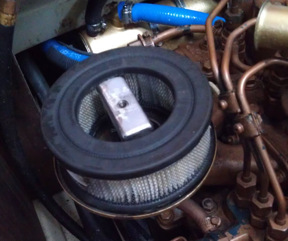

I put a 90 degree fitting in the top of air filter case and connected the other end of the hose to it. Seems to have worked very well all summer and reduced the engine smell a lot. There has been no evidence of moisture, or oil in the filter.
I also modified the original air filter to accept an off the shelf round filter. If I remember I will take a couple of photos.

So I took a couple of pictures . They are attached. what I did find different was there was some oil in the filter..... Not sure why as a month ago there was none. The engine has been a bit hard starting as well. Any ideas? Also is a pic of the air filter modified.

I looked into the K&N filters but they seemed too expensive for what you get. The round filter was $10.00 and stock item at the auto parts store.
The crank case filter will have to be revisited. I was surprised to see how much oil was trapped by the filter.
