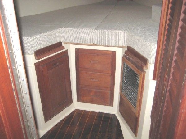

A prior owner installed the heat pump/AC in our boat that way.  In response to another owner's query, I posted  bunch of photos  a few years ago in this thread: https://www.catalina36.org/forum/technical-discussion/ac-advice-mk-i , but, alas, when the site changed over from a different forum program many (but not all) of the photos disappeared, including of the return grate.
  I've attached an older shot from a few years back, below.
 Bottom line is that 1) the starboard tilt out locker was replaced with a grille that is substantially the size of the drawer front, and 2) the ducting inside the hanging locker takes up some room, but not that much (https://www.catalina36.org/sites/default/files/forum/07_3.JPG )

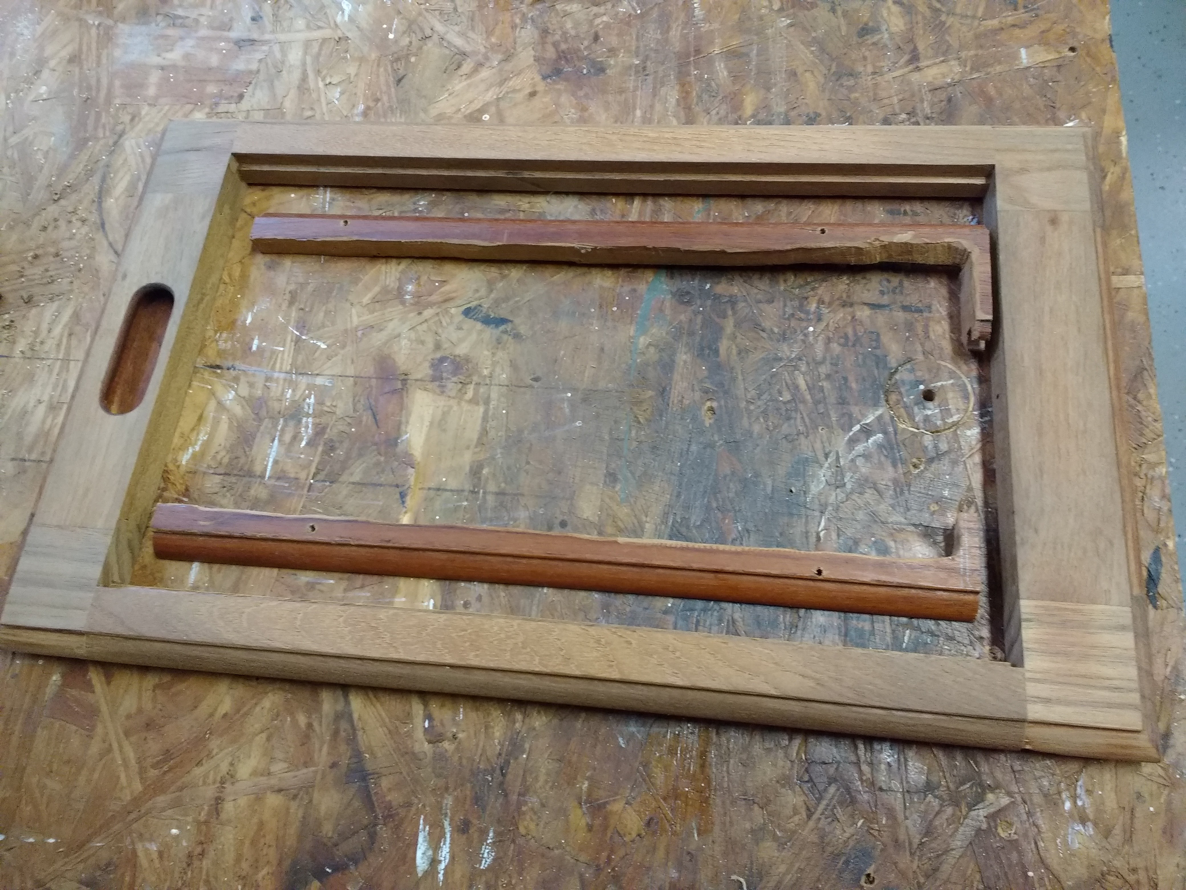

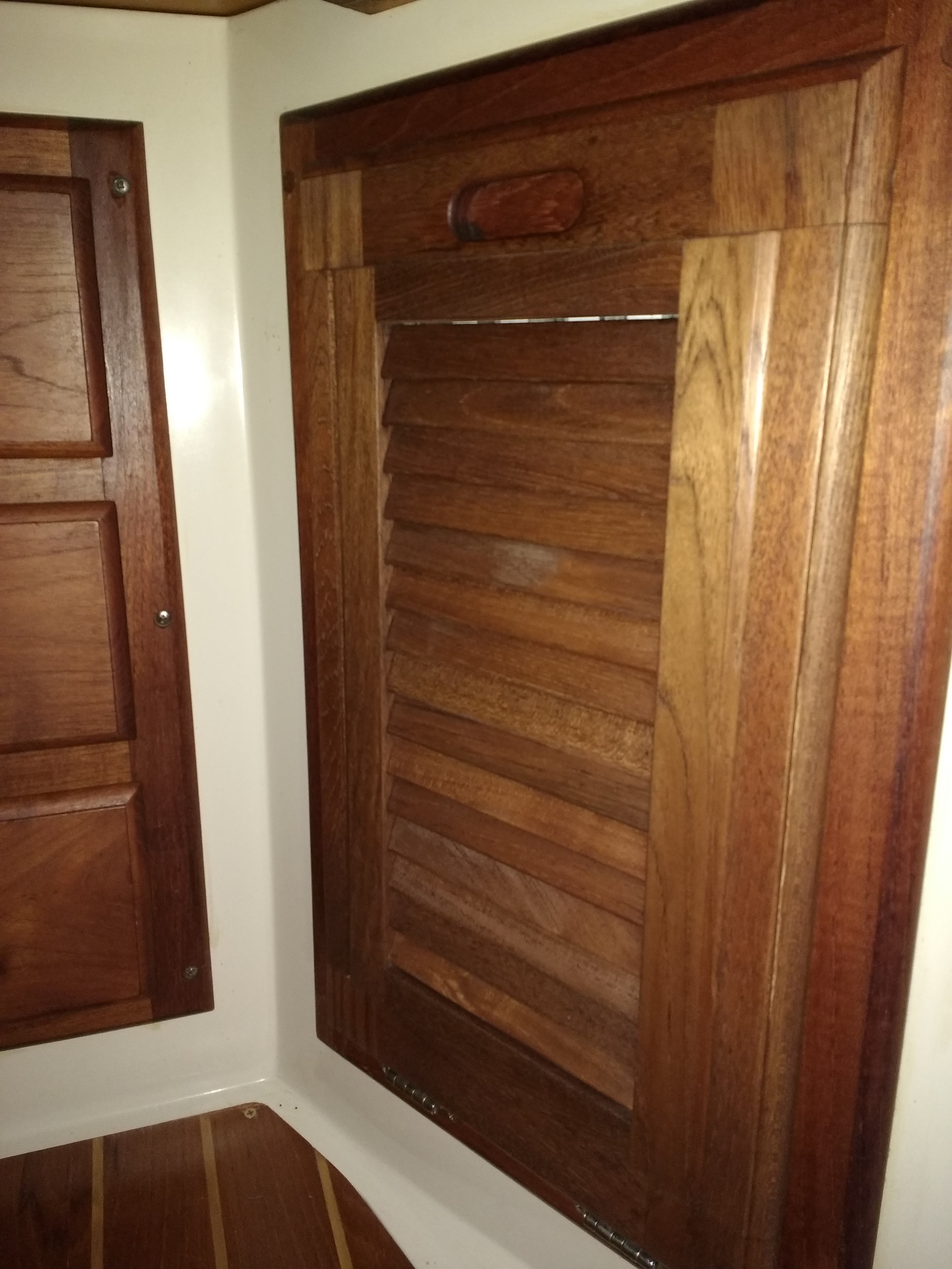

My AC is also in the V-berth.  The PO installed it and did a horrible job. It was mounted to the side with a mount Glued to the hull that had broken loose and the whole unit slid into the V.  It still ran though???
He also mounted a large aluminum intake grate by cutting out the starboard tilt out drawer face - Doh!

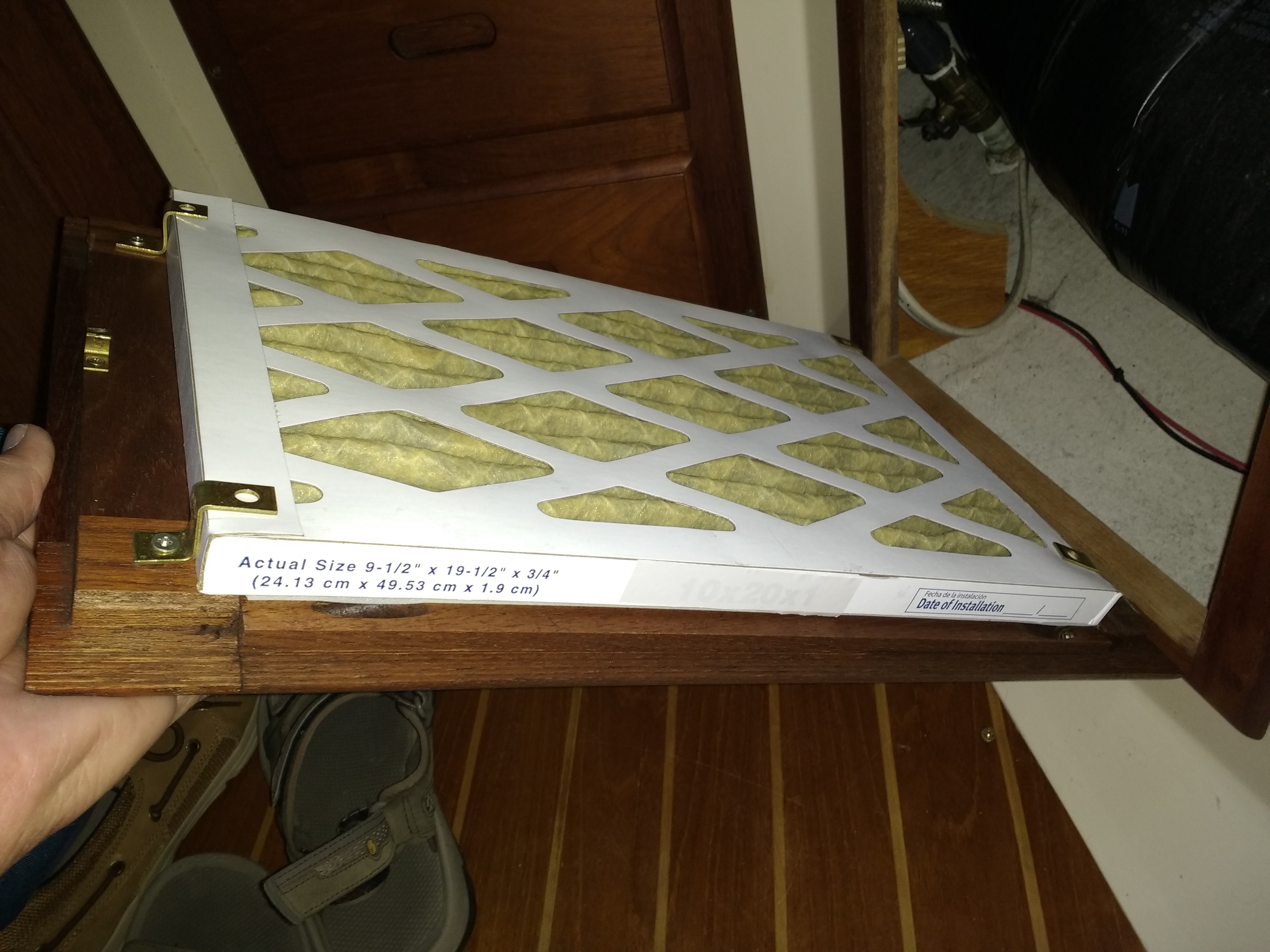

I hated it.  So I rebuilt the door face frame and purchased a new louver insert - looks much better. Also mounted a filter on the back to try to control dust getting to the cooling fins.  Seems to work fine.
I have not addressed the bilge odor issue mentioned above - and it is very noticeable when we close things up and run the AC or heat. I place a Tea-Tree oil canister inside the door -  not sure it helps.

That teak louvre grate looks really nice!  Did you custom order that?

I rebuilt the tip out face (best I could) and purchased a teak insert from Amazon for ~$50 (Seateak Louvered insert).  The door was pretty badly chopped up so I didn't have anything to loose by trying to make my own. I did not really find any other solution that would have been that cheap.
If you don't want to cut up your tip out you could make a frame from scratch and insert that louver. it does take a few wood working tools to make that happen and I realize that not everyone is in to that.
