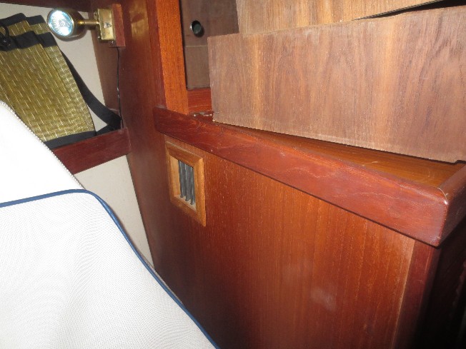

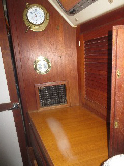

Here are some pictures I took today of the installed Cruisair heatpump/ac on our Mk I. As I mentioned earlier, this had been installed by a prior owner.
#1 is the air outlet in the salon, on the starboard side
#2 is the air outlet in the forepeak. The ducts to both of these are run in the hanging locker (the photos of the ductwork will be attached in another posting)
#3 is the control panel, on the starboard side (near the game table)

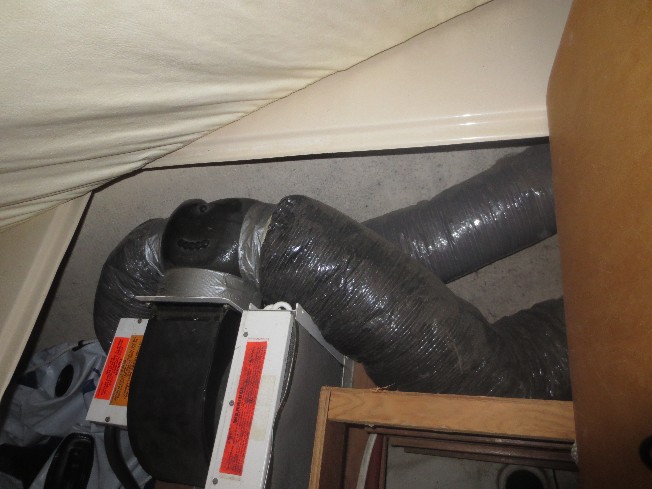

Continuing... here are some photos of the ductwork
#6 - ducts leading from the unit
#7 - ducts entering at the bottom of the hanging locker
#8 - duct in the hanging locker connected to the back of the outlet grate that serves the salon (see photo #1)
#9 - duct in the hanging lockerconnected to the back of the outlet grate that serves the forepeak (see photo #2)
The ductwork does eat up a bit of space in the hanging locker, but its still useable.

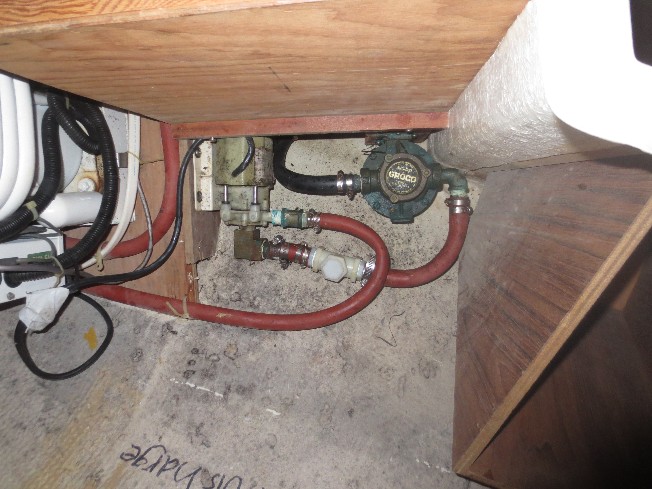

Lastly, some of the plumbing
#10 shows the intake water connection to the through-hull, located underneath the drawer unit in the forepeak (the drawers are all out so you can see straight down in the photo). This is a somewhat mickey-mouse set-up, IMO, that includes an elbow apparently machined out of a block of bronze, and a (non-marine) ball-valve used as a sea-cock. This was apparently done because there was no room under the bottom drawer for a normal sea-cock, but I don't have much confidence in that ball-valve (you can see the handle is already rusting), and next time the boat is out of the water I intend to close off this through-hull entirely, and instead tee the intake supply into one of the lines served by the sea-cocks in the head (that certainly would have been an easier way to do this in the first place, and since the unit is only operable when we're on dock-power, I'm not concerned about heeling)
#11 shows the area to port of the drawer unit under the bed in the forepeak. You can see the intake run to the strainer, thence to the water pump, and then to the heat-pump unit. I added a tee with a plug so that I can temporarily screw a hose in to pour antifreeze for winterizing. I also have added a bracket for a false floor that normally covers this area, so we can use it for storage.
#12 shows the output hose run to the sea cock for discharge; its just above the waterline. I was rather surprised when I got the boat that there was no seacock on the discharge, just a cheap through-hull that the installer had not even bedded (duh-oh). I glassed in a backing block, replaced the through-hull and added a sea cock.
Other than these small installation issues, the unit itself has worked flawlessly. Although we don't often use it, when we do it makes our boat very comfortable, and very quickly. No condensation issues.
