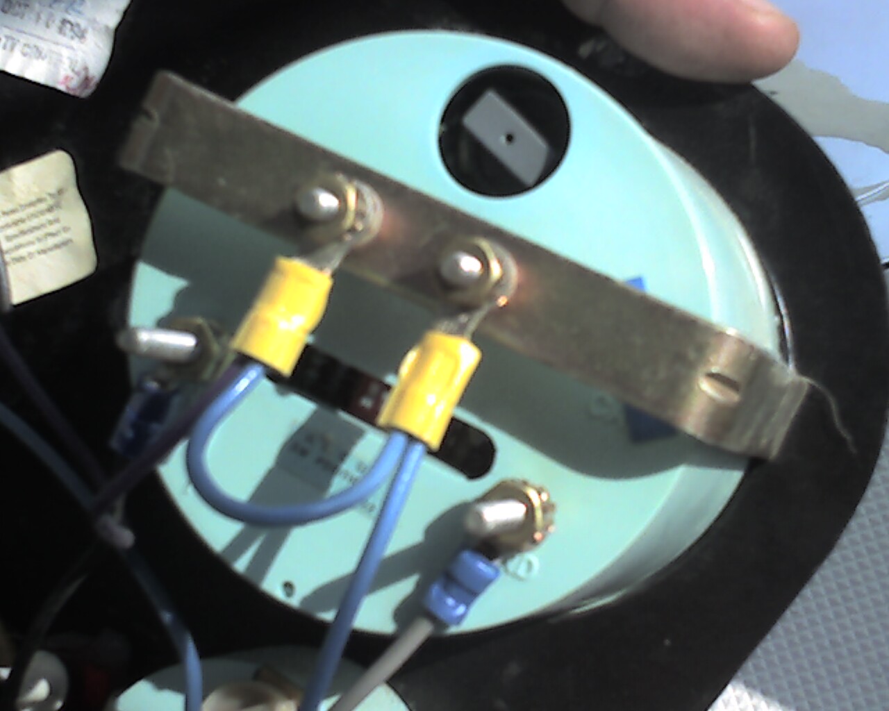

here's a picture....I may be wrong, but it seemed that access hole "on top" was an on/off knob switch for the bulb and did not adjust the tach RPM. The access towards the "bottom" is the 4 position switch and measures approx 1/4" x 1"

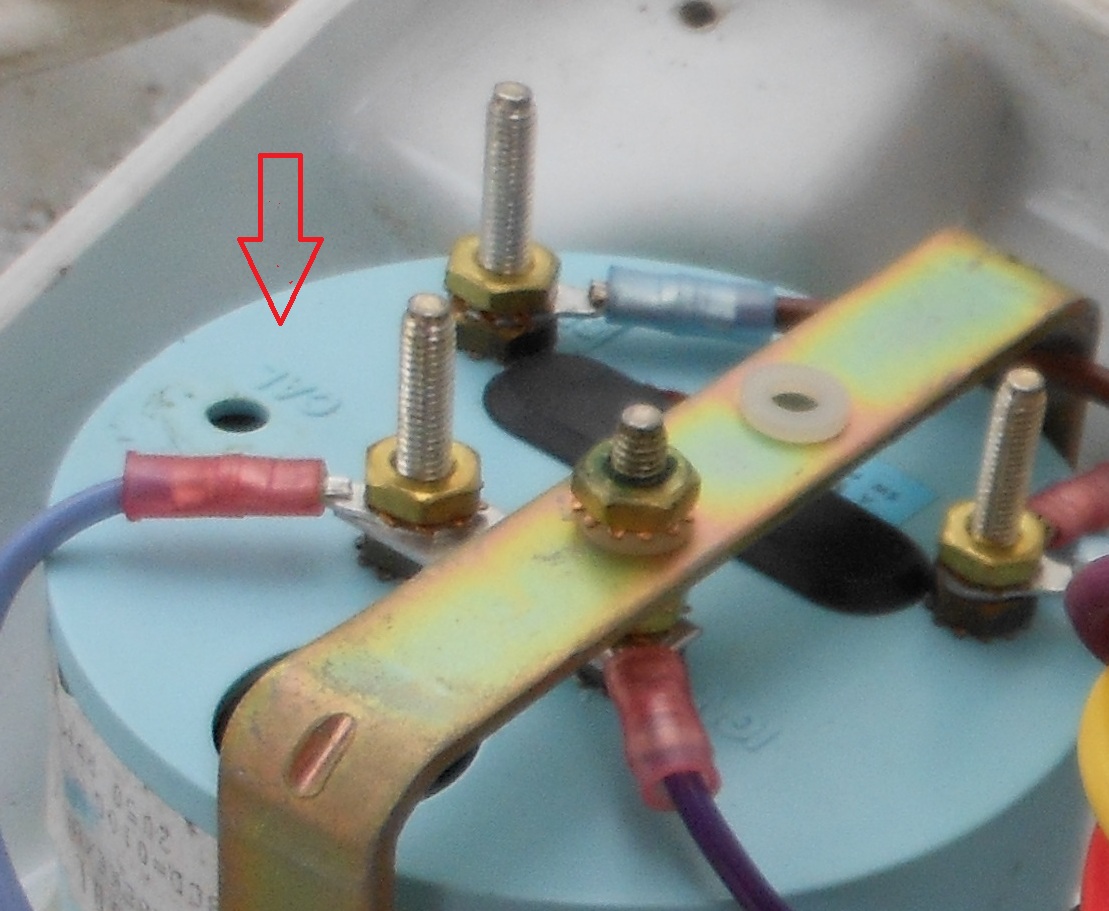

Well, maybe your tach doesn't have an adjustment. It's a small hole in the back of the tach, and "CAL" is embossed in the plastic case beneath the hole.
See photo.
I see part of the "CAL" appearing in your photo. It's just near what appears to be a small piece of blue tape, beneath the metal bracket, right side of your photo.
Thanks Larry, I believe you are right! I'll check it out next time at the boat...hopefully this weekend.

Update....I made it back to the boat and adjusted the tachometer. Larry was correct that my calibration hole was mostly covered by some tape and "hidden" behind a mounting bracket.
