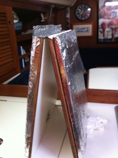

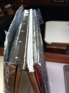

Just a couple of simple thoughts; I like the idea of a different thermostat control. Gary's comment about the space between the lid hinge is real as well as the seal around the whole lid. I played a bit this year as the two projections under the lids annoyed me with the space they took. I purchased (felt like robbed) last year one of the blankets advertised in the back of boating magazines. It was bubble wrap with foil facing on each side. This year I placed under the lid two layers of this material ($25 per roll 24"X 25') at HD. I then put a plastic angle iron (also HD product) about 1.5" below the lid on each side. I made two more pcs double thickness seperated by a piece cardboard that I could slide and remove and covered them with 1 pc the width and length of the opening, just layed on top of two pcs.
This past 10 days we were out cruzing and the refer maintained 37-41 deg. all the while and I actually shut it off a couple of nights. First time I ever had to remind someone to take food out of the freezer to allow for thawing. At this stage it is somewhat crude but I have the idea of what to make this winter.

Duane this was rather simple and perhaps explains itself a little better 3rd pic I ended up making it 2 pieces as it did not work as well as originally planned. Put the channel for it to sit on below and allowed room for a single piece over the top. There are 5 layers of the foil faced insulator with approximately 3/4" air space between lid and lower (3rd pic) allows me to slide either side.

Is this the top lid of your fefer? Mine has about 6 in of formed plastic under it that looks like it came from factory that way

yes my lid had that on it as well and althogh I believe it is to occupy space to keep the cold air down it also eliminated space to stand a 2 liter bottle up on the top shelf. I found that annoying and it appeared that the plastic that encapsulated the foam was distorting.
Now I can stand items up vs. laying them down,also now that I know this works I intend to redo over the winter for better fit and form.
