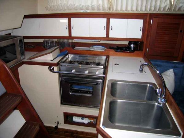

Has anyone tried to replace the ice box foot pump? I can't imagine how anyone can get to the thing which is encapsulated by the moulded liner which forms the structure for the galley/ice box area.
Catalina Yachts have suggested removing the teak "box" below the stove (see picture attached) which is forward of the foot pump. However, removing attached pipes from the pump to extract it from "around the corner" in this way, seems likely to bring on words I don't usually utter in polite company..:mad:
Are there any tricks of the trade to make this relatively painless?
BTW: the reason I need to replace the pump is becuase the plastic encased steel shelving in the ice box has rusted so badly that bits of metal fell down with the melted ice water to enter the pump and deliver it a fatal blow. Catalina Yachts can replace these shelves, but need the measurements from your specific vessel since it seems these were made up to fit on a boat by boat basis.

Catalina Yachts is correct. The only way to access the foot pump is to remove the storage box under the stove. There will be 5 teak plugs with screws behind them that needs to be removed as this was the case on our boat. Then pull out the box. There you have full access to the pump. Hose's came off easy on our pump as each was held on by a screw clamp. Good luck!:)
Randy

Hi Glen:
On our 1989 C36, hull #949 the box only had one screw at each corner. As Randy said, you have to remove the teak plugs to gain access to the screws.
To remove the plugs, drill a 3/32" hole through the center of the plug and screw a #8 or #10 wood screw into the plug. Keep turning the screw in until it bottoms on the screw head inside. Then keep turning to jack the plug out of the hole. You may end up with a part of the plug still blocking access to the screw head, but the teak is easy enough to clean out. The box will slide out once all screws are removed.
Good luck
Tom & Janis Grover
C36 #0949
SR/WK, M25XP
Midland, ON

Tom, your installation may be different from Triatica's. The photo attached to Glenn's post shows the pump located beneath the fridge, which would accessable only via the box opening beneath the stove.
Glenn, once the box has been removed, it shouldn't be too difficult to get the pump out where you can work on it. And the overhaul isn't bad, either...with the O/H kit avail from West Marine. You do have to pay close attention to how things come apart in order to make sure they go back together the same way. Once you have the pump back together, try blowing on ports to validate the valve logic. I actually reassembled mine with the output/input reversed, which I discovered by this validation test. So I just connected the hoses the other way around to accomodate that.
The only concern I would have is whether the "fatal blow" you describe was indeed fatal...that is, whether one of the plastic parts has been irrevocably damaged. Those plastic parts aren't available in the O/H kit.
