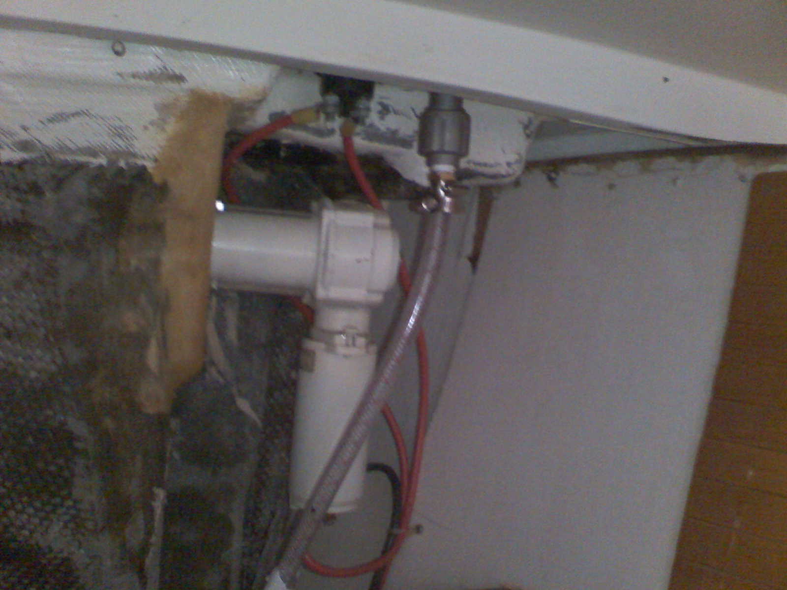

I found a picture (taken by my cell phone) of my 1996 MKII when I put in the washdown pump fitting. I did need to remove all the headliner trim (Front and sides) before I could remove the face cover. It is only a decorative cover. The 1997s and newer models have a different anchor locker design.
Hope it helps future projects.
