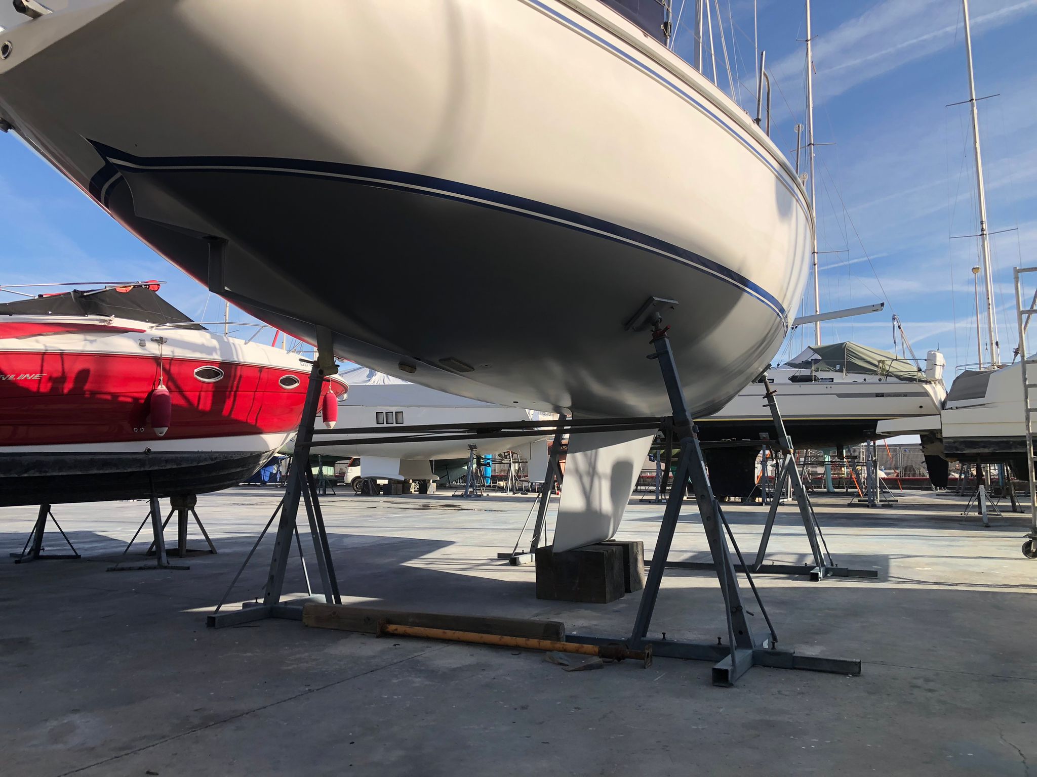

We mainly race our C36 TR hull 1122, we had her since new back in 1991.
What we have done is to profiled the keel, but I must say that in our case keel was rather symmetric. Would like to change the rudder form but will be heavily penalise under the ORC rule.

John, how did you reshape the keel to make it symmetrical on your C&C? Added fiberglass? I can't imagine doing it with lead.
John Hopkins
Joined: 9/16/24
Posts: 4
For the most part the keel was bigger than design. Soo a grinder was my friend to shape it to the template.  Then fairing compound and sanding to complete the task.  It too the better part of a month working nights and weekends. In the end barrier coat and bottom paint completed the job.  As mentioned it greatly improved the performance of the boat.
