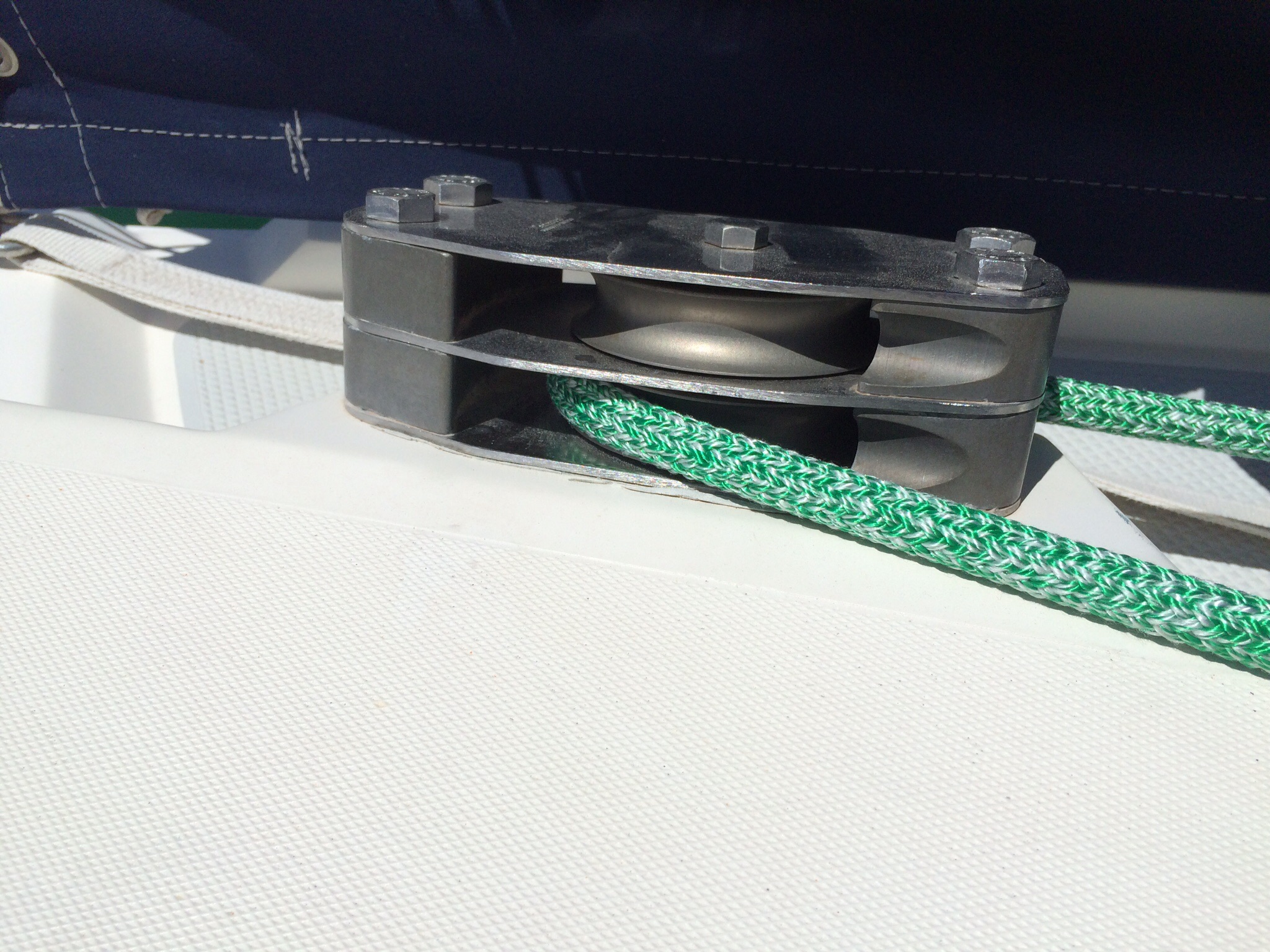

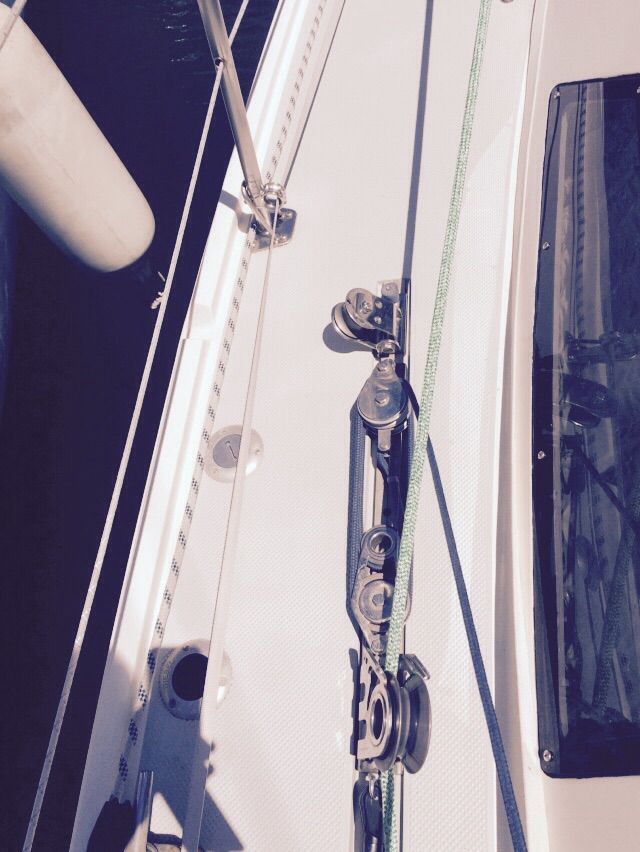

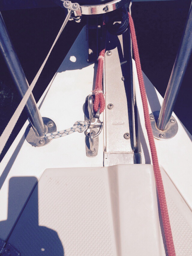

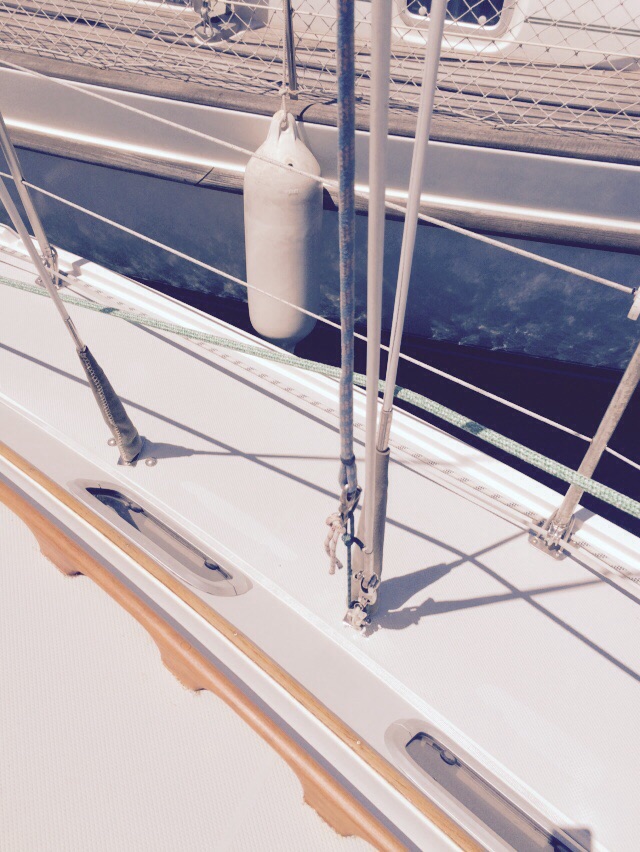

Alain,
Tomorrow I will be onboard and take some pictures. The inner stay is tensioned with a mechanical tensioner.
At deck there are two hooks, one for the inner stay one for the sail, both close to the main stay. Internally there is a solid steel plate with a turnbuckle attached to the stem fitting. It has been working fine for the last 15 years.
At mast there is a special fitting for attaching inner stays. It also helps if you have a double Genoa car, so you do not have to remove the Genoa sheets. I put a second pair of sheets for the inner sails. Also double foot block for the Genoa sheets.
You can see in the pictures how I keep the inner stay when not in use. I use the second genoa  halyard to secure the stay.
Regards,
Eladio
​pictures attached.
Eladio Vallina
C-36 TR EUREKA II
Hull 1122 (1991)
Home port Barcelona (Spain).
