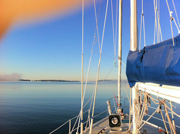

Bill,
I purchased the stack pack from Hallett Canvas and Sail in Falmouth, Maine. Along with the stack pack they made "Lazy Jacks" I can not tell you how much easier this has made dropping the sail. I do not have the threads going up through the main as my thought is it would become problamatic. This arrangement works fine.
I found this picture which shows most of the pack with the lazy jacks. The LJ's are adjustable another feature to consider as with a full batten main many times you cannot point directly into the wind. When lowering though with the LJ's taught the sail just drops into the pack and you just zipper the top...no ties, no sail on the deck, & no sail cover to install.
The only negative factor was that unknown to me it has a tendancy to funnel rain into the boom. A small hole in the bottom is planned to allow the rain to drain....no big deal.
