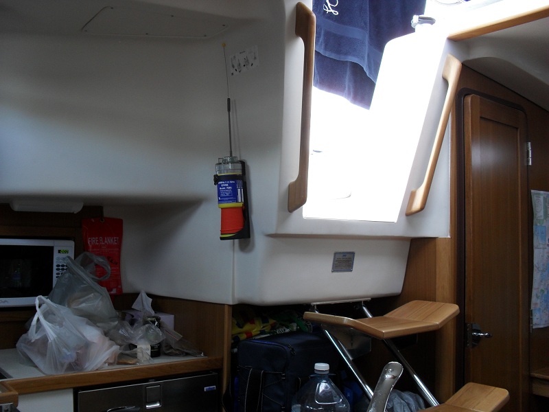

We mounted ours just inside the hatchway, on the galley wall. You can reach down from the cockpit and flick the retaining clip, and remove the EPIRB.
I would recommend that you practice grabbing the EPIRB, before you actually need to. These sort of things are usually needed when its dark, rough, wet, windy and the last thing you need is to be worried about "how do I work this bloody thing!"
