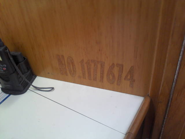

My personal preference would be to avoid having any visible documentation number. It isn't necessary and it adds to visual clutter. Just get 3" high registration numbers at your local boat store and stick them to the inside of the aft cabin closet. Slap some resin over them and call it quits. See photo which shows a portion of my documentation number located inside the aft cabin closet.

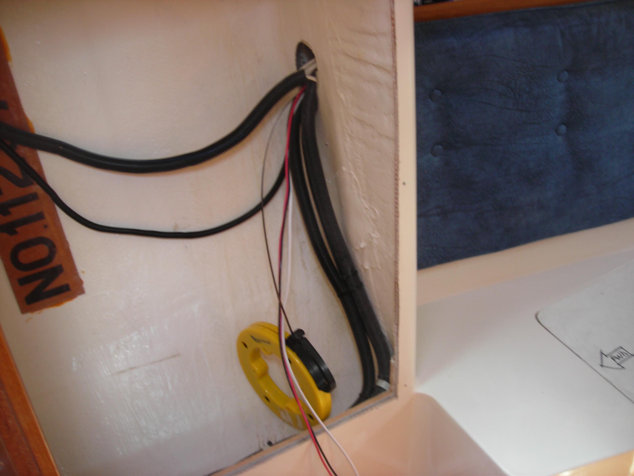

It’s been a month since SV Lori Lee’s original post but here's mine…
Marc & Susan Garcia
"Solla Sollew" #1473, Mk.II
 San Buenaventura, Ca.
