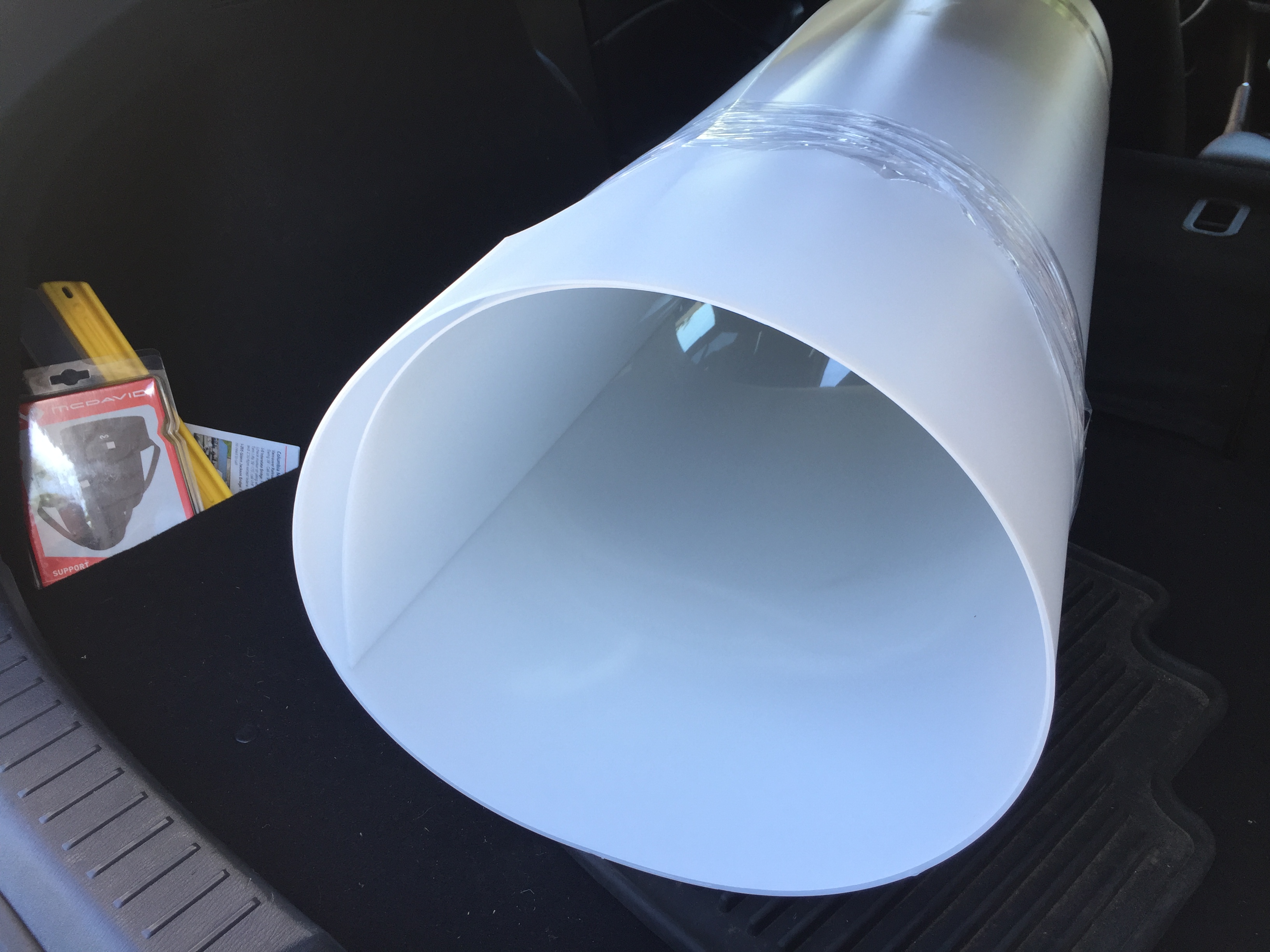

New problem is I needed to buy a huge sheet of plastic 48" x 92" to get (2) 1"x 72" x 1/16.  So needless to say I have the ability to make a lot of strips.  If you have a screeching hatch  $15.00 paid to paypal will deliver a set of pre cut strips to your door.  These really work they install in minutes with no removal or alteration to the hatch assembly.  Please include your mailing address and email address.  www.paypal.me/markholzmann/15  Questions? email me at holzie at gmail dot com. https://youtu.be/1AOsPGluaDs

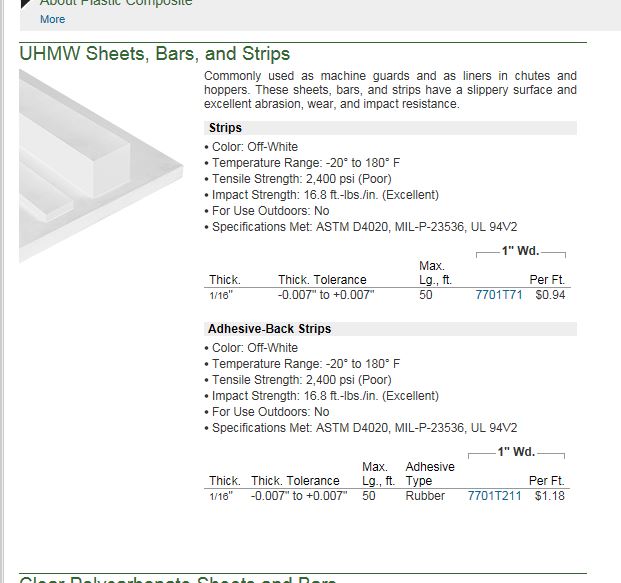

Another source is McMaster Carr. Strips of UHMW sized at 1" x 1/16" are sold at less than $1 per ft

For what its worth the product you mention is not for outdoor use.  I think HDPE is better suited.
