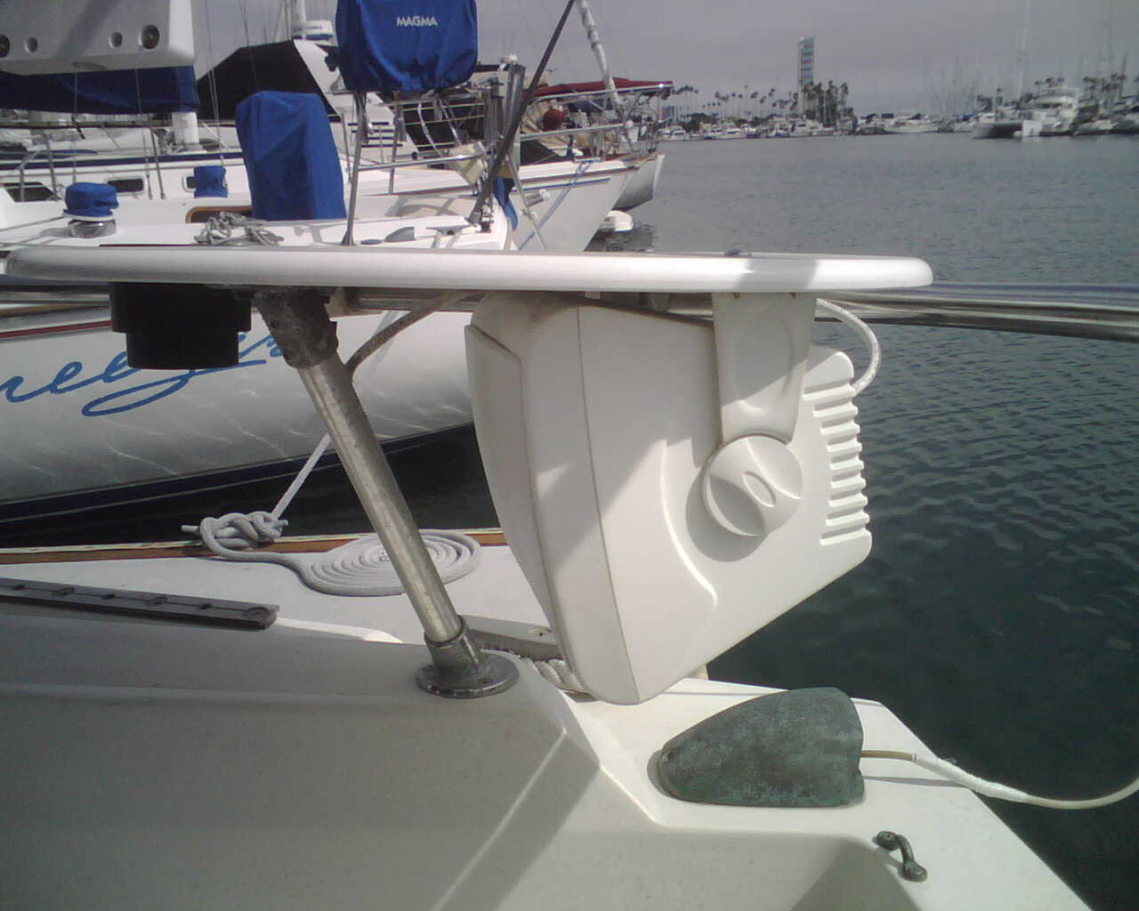

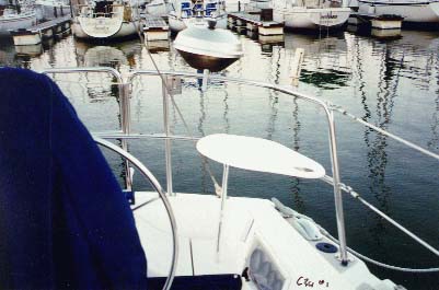

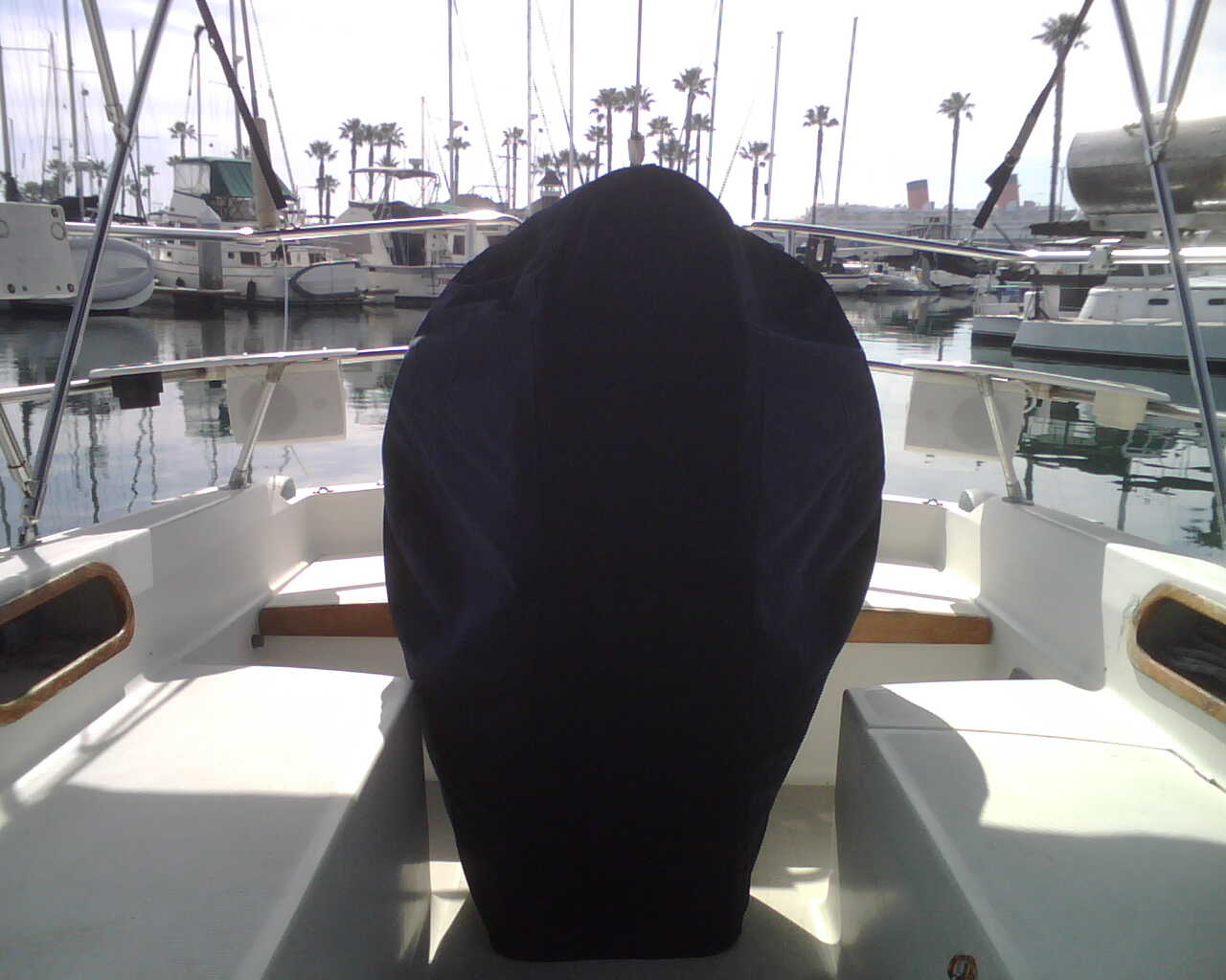

I installed the stern rail seats 4-5 years ago and wanted to share my modification of the vertical post to an angle post that allows the aft lazerette to open without having to raise the seats. When working the geometry make sure the aft end of the seat overhangs the aft stern rail. I did not do this and my stern rail seats are beginning to crack along the drilled holes for the post. I did this to use the orginal drilled holes for the vertical post. If you are constructing from scratch that will not be a problem. I purchased four 30 or 40 degree (standard) mounting brackets from WM and mounted the base onto the aft end of the coaming as shown. Also makes a great place for speakers and I ran the wires down the support post inot the coaming box. From one picture you can see how my aft seat side does not over hang the aft stern rail and this caused the star board to start to crack. I will rebuild using thicker star-board and rotate the support post brackets aft so the seats do overhang.
We have a bimini that allows 6'4" of headroom and a 6'3" friend of mine sitting on stern rail seats had ample head room. I also canted my seats to match the slope of the aft stern rail for asthetics and fuction as it holds you in better in rough conditions. Just do not sit anything on them of value except your bum as you will be diving for tools as I did in Catalina one weekend.

Looks nicely done, Mark. Thanks for sharing that.
mablamb
Joined: 6/27/07
Posts: 11
Thanks Duane, One other thing. I think I had to buy larging tubing to fit the standard 1" brackets from WM and do not buy the cheap ones like I did as you can see after 5 years they show considerable corrosion. Go with SS - and SS tubing.
