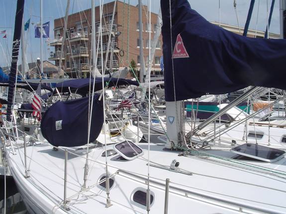

I saw it up at a Catalina Rendezvous in the early 2000's. I think I wrote up something about it in a Mainsheet Tech note. Right now I do not recall the specifics, but I kind of think it was rigged as a 3/4 set up (versus a Solent to top of mast) But I can't be sure, I am not even sure if they had running backstays, I think he might have terminated the Stay-Sail near the spreaders and with our stout mast and lower afts, maybe didn't need any. Below is an ok picture of that boat.

I question how the above pictured setup could have adequate below decks support without putting a chainplate through the middle of the V-berth? If this is the sail I am going to use in heavy air I think it is going to need some serious backing.

I agree with that assessment, Nimue.
Do you have a name we can use?
I Agree. I believe that this boat had a very beefy attachment point and bracing in the v-berth. I am sorry i don't have any pictures of the below decks, but I do know it was beefed up and also with an additional sort of rod that was attached forward at an angle to the forward area under the chain locker. Yes it did obstruct the v-berth somwhat but it wasn't terrible and it was livaable

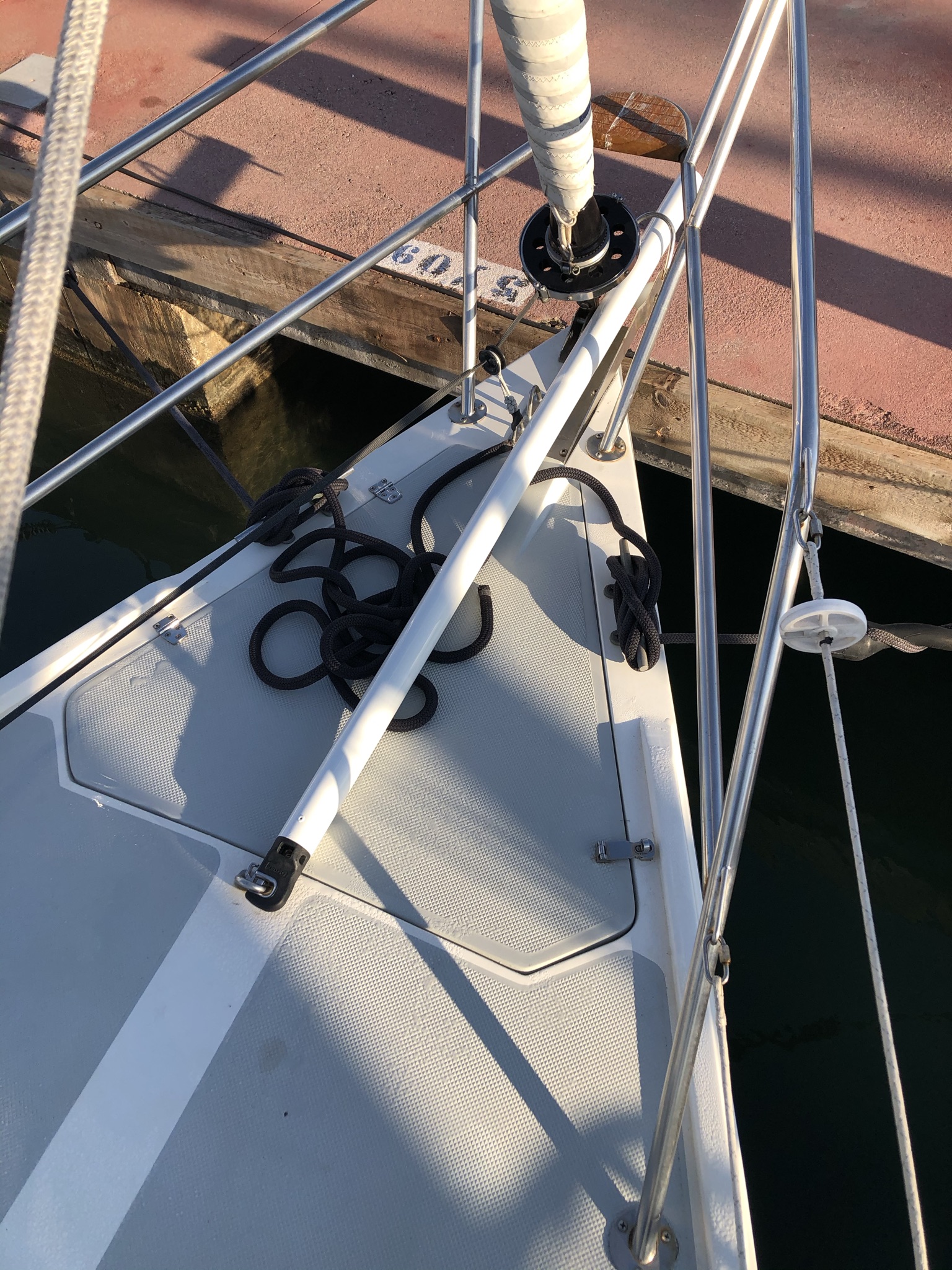

Hi,
I installed some 30 years ago a Solent (remouble inner stay) on my C36. It works great when blowing more than 20 TWS, roll the Genoa and set the Solente. Sail is a Yankee with hanks. The main issue is to reinforce internally the attachment of the inner stay and the tack point of the Yankee.
I include some pictures, on the backboard of the bowsprit, you can see the two "bridges" for the inner stay and the Yankee.
Hope it helps!

Hard to see what you really did in that picture. I am interested though in this still if anyone else can chime in.
