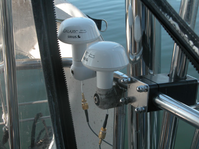

I have 2 Sirius mushroom antennas mounted on the starboard stern railing. I see no interference issues.
The previous owner had a GPS antenna installed in this railing location and ran the GPS cable inside the steel railing, down and into the stern storage locker. From there the cable went into the electrical panel.
I eliminated this GPS antenna when I installed my Raymarine C80 Chartplotter and put a new GPS antenna on my radar pole. I used the old GPS base with my new Sirius antenna and ran the Sirius wires in the same manner as the old GPS cable.
Now why do I have 2 Sirius mushroom antennas?
I get my Sirius music from a portable receiver that I move from car to home to boat. The receiver is placed on the shelf above the nav station and plugs into my stereo radio receiver. The Sirius receiver needs it's own antenna to get music. I tried using a portable antenna the way others have mentioned but it was never nautical enough to just have a portable antenna flopping about. It became a project to properly install the Sirius antenna.

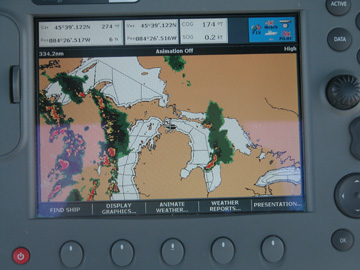

The second Sirius antenna is for Sirius weather data that is connected to my Raymarine chart plotter.
Now the Raymarine Chart plotter software will allow you to get music delivered to your chart plotter and you can tune Sirius channels from the helm BUT! You need a separate music subscription and that adds a monthly fee. Plus you have to power up the chart plotter and keep it running while you listen to music. That's a large power draw and I already have a music subscription so it's a lot cheaper to just mount another antenna and move my portable Sirius receiver to the boat.
I found the antenna in the bargain room at Cabellas for $25.00 so it was no big deal to add a second antenna.
I have included pictures of the antennas and of the basic weather radar image from Sirius Weather.
