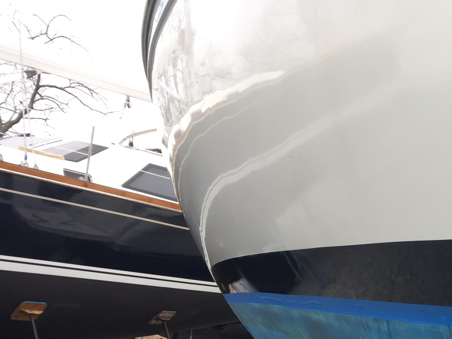

When I took off the lower winter cover (aka "skirt") was reminded about the nasty scratch in gel coat 8" above water line.  See picture.  Was a great day to sail last fall but an SOB wind coming out of the dock.   Another to do list item to check on.  I've got some research to do on that job as it has to be done b4 waxing...I ve got to do some research on that repair.
