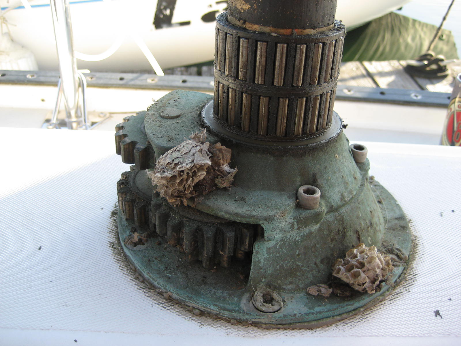

Spider nests, paper wasp hives, and cocoons... in the winches.  Is that what they mean by "mothballing a boat" ?
2 winches cleaned 5 to go.

Well I have never see that before.....   Maybe time for me to clean my winches as well.

I just received my boat, it's been on the hard for around two years. I've been dutifully fixing the broken bits, ya know, a thousand here, a thousand there. Here I was thinking I was close to ready, and you go and show me something I would have never thought of!
