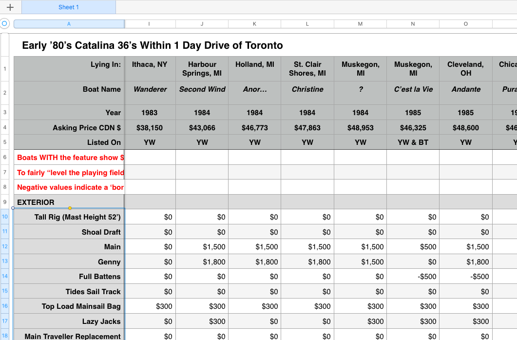

Ludo, I am more than somewhat obsessive-compulsive, but to 'level the playing field' when choosing our 1991 C36 I actually created a spreadsheet (attached) and listed ALL the features each boat had and assigned a value of what it might cost us to both build and install each feature.  This then gave me a fairly accurate read on what the real value of each boat was to us.  Some features are more important (valuable) to one person than another, so it is a personalized list, but it did allow me to 'short list' the boats with precision for our needs, as well as argue the value with the sellers with more certainty than would normally be the case (many sellers unrealistically price their vessels based upon their emotional attachment and unrealistic expectations: "I heard a similar boat sold for $NNN,NNN!").
Check out the spreadsheet if you like.  We ended up getting a real 'steal' on the vessel in Manitowoc, WI (and the Admiral decided she wanted the walk-thru transom that came out in '91) and bought it sight-unseen (we'd seen many C36s by that point and had an inspector look it over and send detailed photos) and then had it shipped to Toronto last April.  The C36 is an amazingly good layout inside and out and is a lovely boat to sail and use as a 'floating cottage'. Good luck with your shopping!

Hi Kevin! Thank you for your document it's helping me a lot! :)
