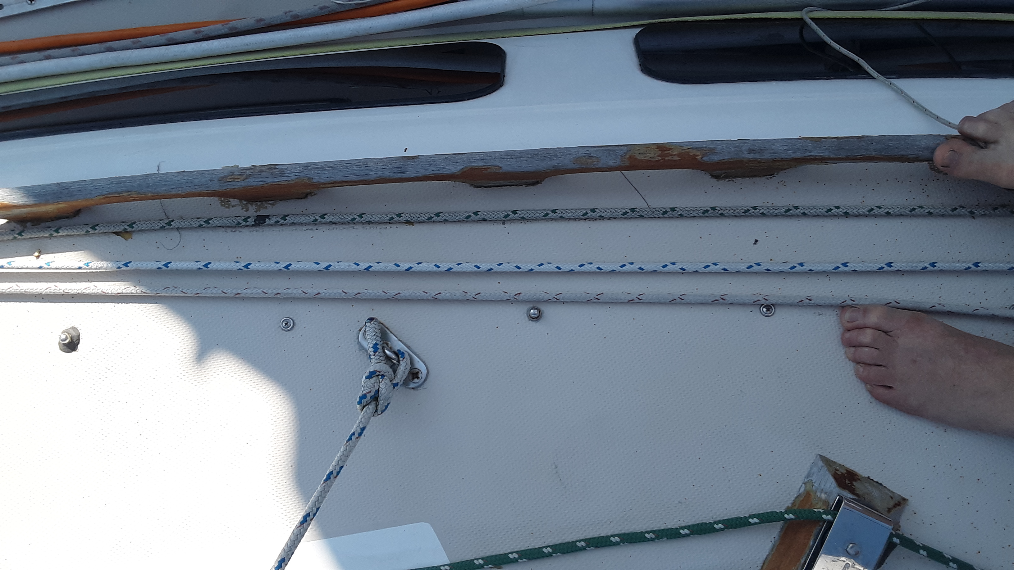

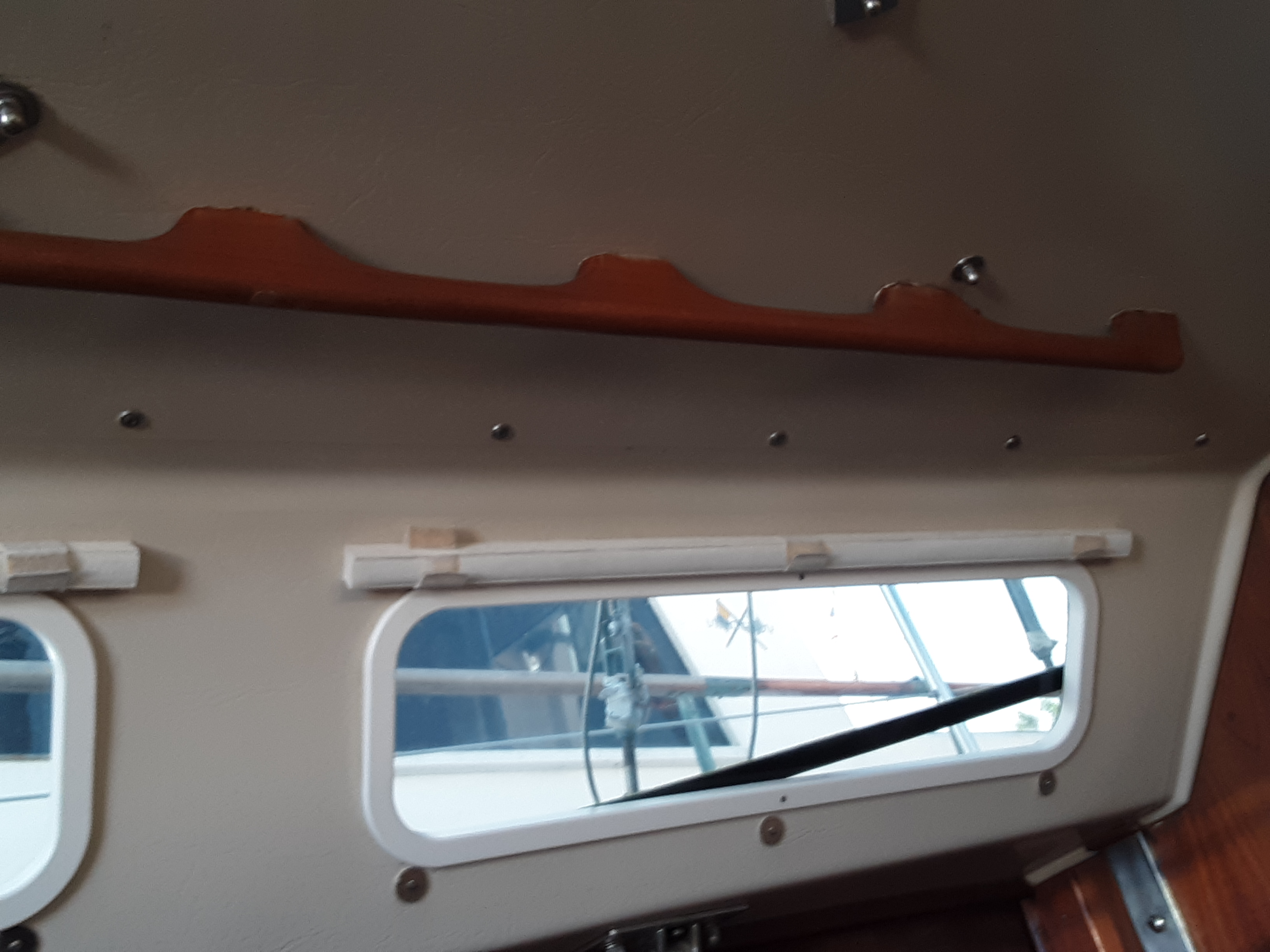

Yours is a Mk1 like ours, albeit 7 years newer. As can be seen in the attached photos, the screws for the outside rails are accessible from the inside in a line of screwheads outboard of the inside grab rails, and vice versa the fasteners for inside rails are visible on the outside in a line on screwheads inboard of the outside rails. I take it yours doesn't look like this?
