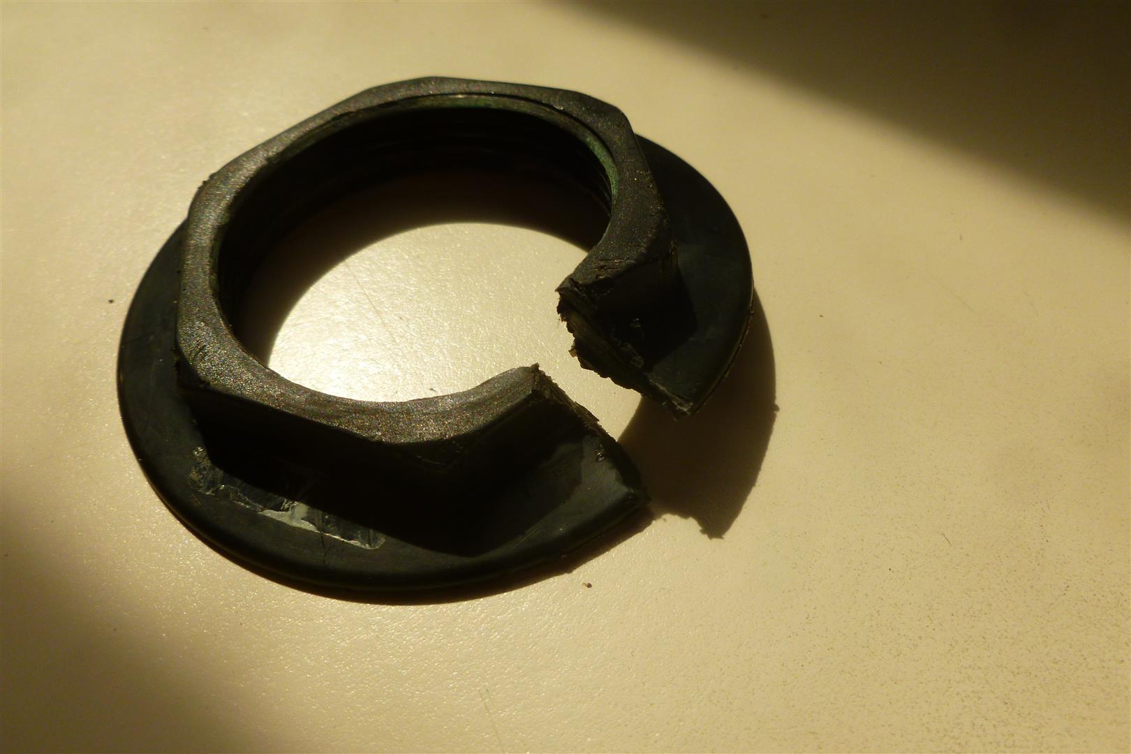

[U]Background [/U]- The sink drains themselves are plastic. I have purchased new Forespar SW4 1" drains. They, like the old ones, are plastic and I know all about the pros & cons of them. Not an issue for me.
[U]Question [/U]- I am having an incredibly difficult time getting the OEM drains off the sink. Anybody have experience with them??? I'm getting ready to use dynamite on them. :eek:
For all we know, the drains were installed with a 'permanent' type of sealant. I have no experience to help you.
When you remove the first locking collar for the drain hose connections, what remains is the larger black collar that holds the plastic insert in place against the bottom of the sink. The caulking used to bed the drain to the top of the sink is not glue. The problem I'm having is that when I turn the remaining collar, the plastic drain insert itself also turns and there's little to hld with no leverage.
I'm taking the Dremel to it this afternoon. :eek:

Since you have tried everything - dremal tool is not out of question. I would cut the plastic or metal lock nut from both sided then pry the nut off the drain fixture. I would use a soldering iron to melt the ring first - if possible. A photo would be nice.
Coyote Point, San Mateo, CA.
Dremel is the RIGHT answer.
Thanks.
Here's the result.
BTW, BOTH the collar and the drain are PLASTIC. You might want to look carefully at what you have in your sinks, 'cuz that's waht they installed at the factory.
I'm going to write the whole saga up for a [I]Mainsheet [/I]article. With flix. :)

Nice job - Stu.
dejavu's picture
dejavu
Joined: 11/6/08
Posts: 433
Looks like what I had to do to get one of my deck fills out.:(
