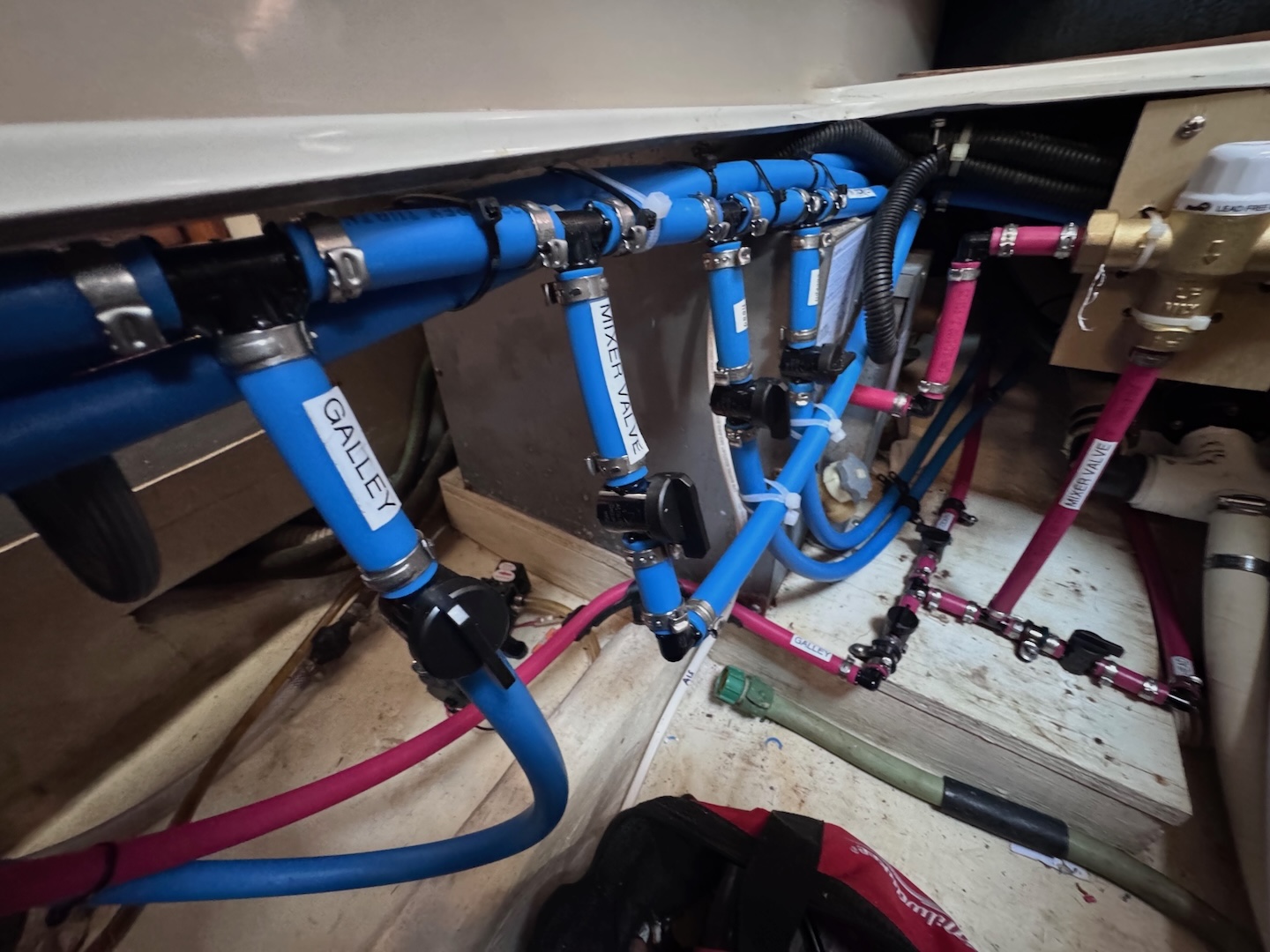

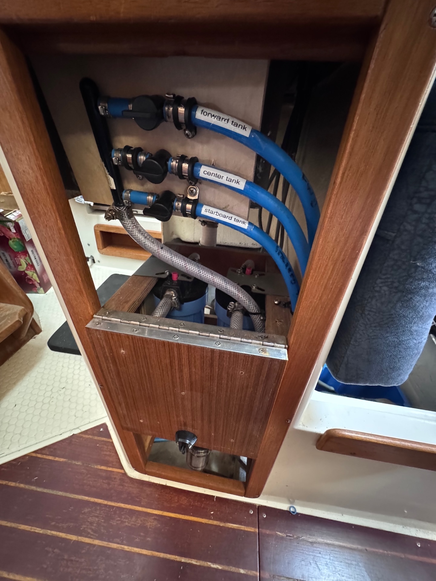

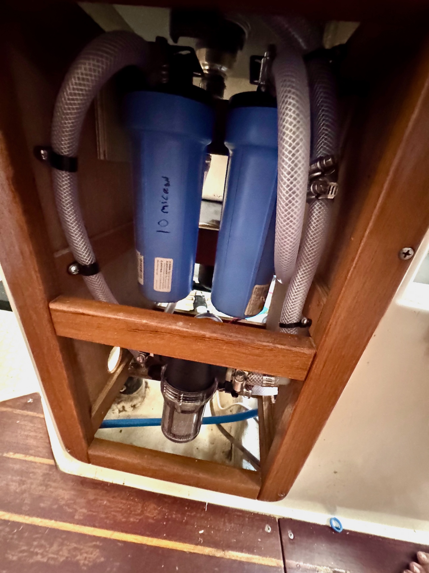

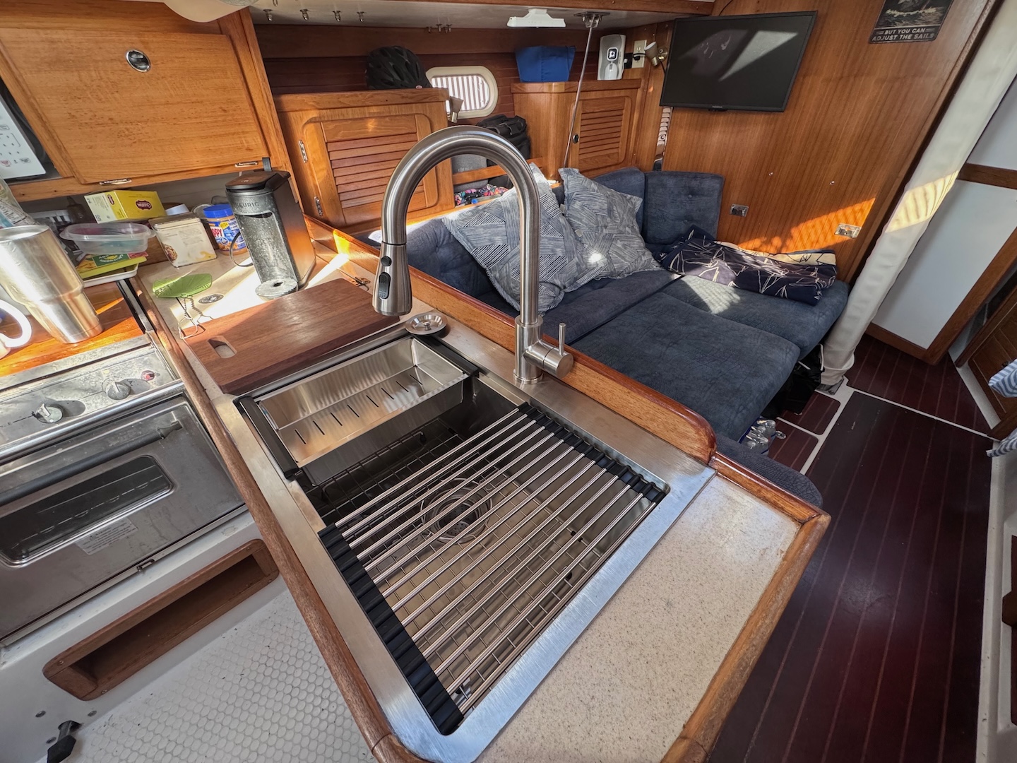

I'm a day or so away from completing a conversion to PEX. It was added while changing the sink (thanks to Army Sailor for the suggestions!) and installing a dual stage filtration system.
The 25 year old hoses and connections well overdue for change, I decided to use PEX B with stainless steel crimp clamps. The tank valves were relocated to the silverware drawer and I added a dual stage (10 micron / 1 micron) filter and moved the water pump and strainer to where the two small drawers were below the silverware. The drawer fronts will be reinstalled on hinges.
Each distribution line has a valve in the settee that backs up to the sink and I added an anti scald mixer.
I've used PEX in houses - the runs are longer and spaces bigger so it is pretty simple. On the boat the turns are tight, I ended up using a lot of elbows in tight quarters. The clamp tool worked well in small spots too.
