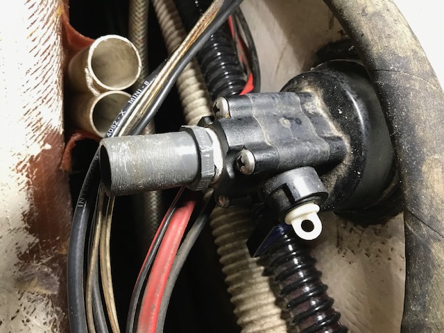

We discovered last week that we also had bilge hose as a drain hose for the galley sink.  It broke while we were moving it out of the way while removing that cabinet to replace the water heater.  What we discovered when we went to replace the hose with proper drain hose was that it appears that someone had shaved (maybe dremeled) the barbs off of the connector on the thru-hull.  We would be very disappointed if this is how it came from Catalina.  Just curious if anyone else has come across this?  We have hull number 1388 which is a 1995 MKII.
Robert Clyde
Image icon shaved hose barb137.48 KB
Never seen that on our boat.  Looks like you could replace the tailpiece with a new one (with barbs!) without removing the seacock, however..
