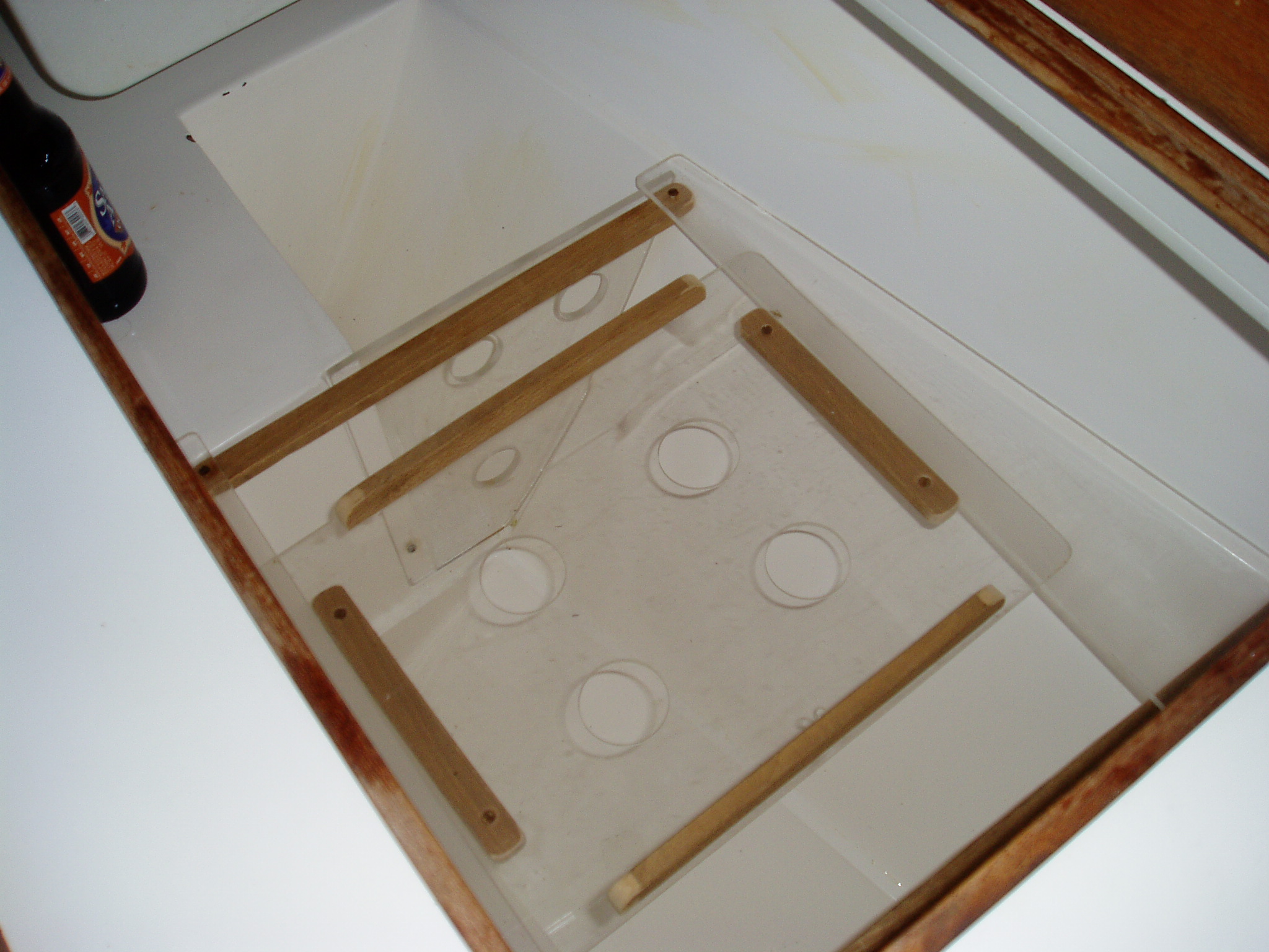

I cut two pieces of clear plexi to fit on the ledges molded into the fridge, connected by small strips of wood to keep them in place.  On top of those pieces is third piece of plexi, with small wooden fiddles on its top and bottom.  The bottom fiddles were to keep it aligned with the bottom pieces, and the top fiddles were to keep items on top of it from falling into the bottom of the fridge.  The size was just big enough for the molded white bin that comes in the larger Igloo coolers.  The bin holds lots of smaller stuff, and you can slide it back and forth to access items in the bottom part of the fridge. I had always planned to re-cut the wooden pieces out of teak, but I never got around to it.  Worked well for many years, and more importantly, it was Admiral approved!  Hope this helps.

Tom...SO GLAD that you are still active in the world of C36s!! Thanks for the detailed description AND...especially...the photo.  As I look at the holes you cut into the clear plexi, do I see a second set of holes?   possibly in a lower shelf?

I think those are shadows of the holes, showing on the white gelcoat in the bottom of the fridge.  Probably from the light above the fridge/stove area.  I only had one layer of plexi.  There are also holes in the vertical piece of plexi between the small triangular section and the larger square section below.
