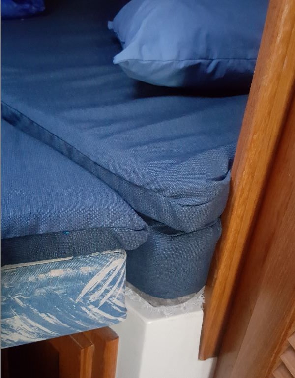

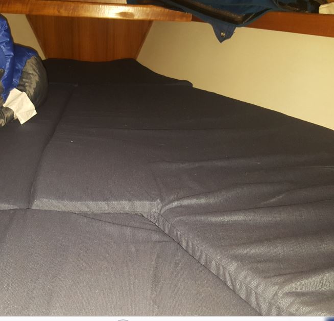

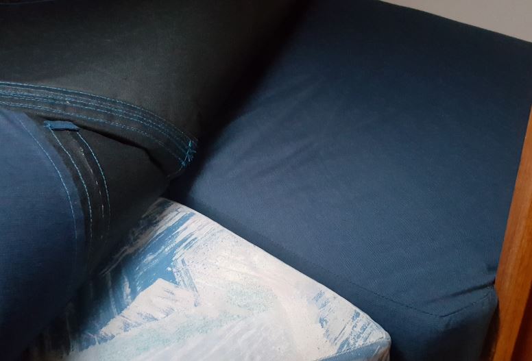

My husband got a great deal last year on a 1995 with sad horrible stinky, moldy, engine oiled cushons in the back and front.  I was not so thrilled.  BUT he also bought me a Sailrite LSZ-1 sewing machine which I love.  I got to work on this.... getting 4 inch foam from Amazon for front and back, a queen size 2 inch topper called Serene ( better than memory foam for comfort) for the V birth.  I followed the Sailrite videos which were great.  Made a pattern from scrim. I made a cover for the topper to protect it and sewed on velcro flaps to avoid gaps.  It is AMAZINGLY comfortable.  We put Hypervent under the V Birth mattress to prevent further mold and moisture.  The back area also had the gigantic piece which you have to fight with to get under or move and my husband wanted to have storage space in the unused back area... so I divided up the big piece into 3 smaller ones which fit nicely and there is room for storage boxes now.  I haven't made a topper for the back due to needing to get back under this space often.  We didn't put hypervent under because it is so easy to open up with the smaller sized cushons.   Total cost was $700 for foam and materials.  $1200 for the sewing machine,  Plus I've replaced dodger windows, patched up the older front sail and made a mainsail cover from a Sailrite kit.  I truly love this boat now... And this summer has been the best.   Bonnie
