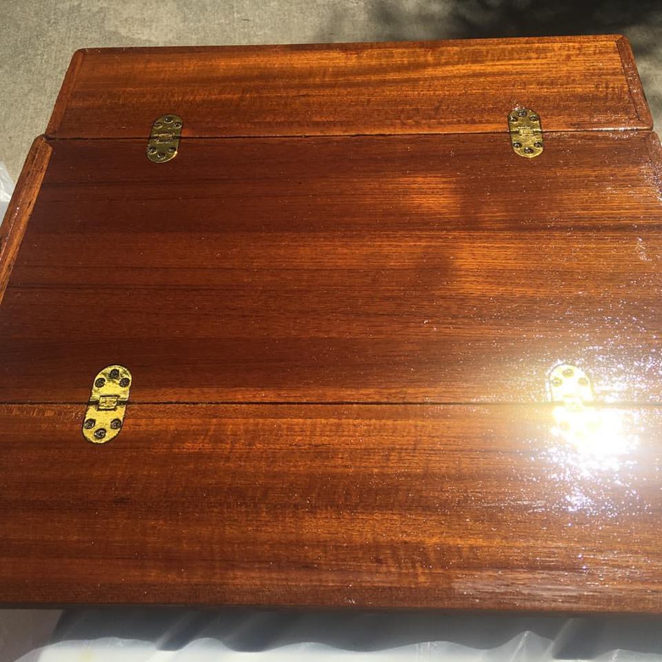

Hi all, wondering if anyone could offer the best way to rejuvenate the teak cockpit table? This one is in decent shape but needs to be spruced up. Has anyone ever used any of the Starbrite products for teak?
See attached pics.
Thanks!

For the past 5 years I've been using Semco teak sealer for the cockpit grate that we build back in '14 (first picture below, before sealer applied), as it would have beena huge PITA to varnish something like that (much less maintain it).   Its super easy to apply (plastic spray bottle, brush, foam brush or cloth), its not sticky, and dries in an hour or so.  A quick recoat  once a year is all it takes (no sanding or other prep).  Its not in the slightest degree glossy, but it does seem to protect the wood and still looks nice after 5 years with just a wipe on application once a year (see second picture below, taken last week -- although you can see the cockpit table, which I last varnished a few years back, needs some love!).
I'm contemplating switching to the teak sealer treatment for all the other outdoor teak at somepoint.  Its definitely not as pretty as a nicely varnished piece of brightwork, but I have to acknowledge that revarnishing has fallen way down my maintenance priorities list over time.

All of my exterior teak is oiled, except my cockpit table, which is varnished.  I don't like the thought of spilling on oiled wood, which I would invariably do, and dealing with it potentially staining.  I put 4 coats of varnish on and everything just wipes up easily.  I got it pretty cheap from an outfit I loved but that seems to have gone out of business- Thai Teak Marine- that had all sorts of great teak products direct from Thailand.

Looks amazing. I agree with you, I think varnish is the way to go. This boat has so little teak, and the table detaches and comes home pretty easy, so no real excuse to care for the small amount of teak in the off season. I'll post my results when I get'er done.

Phil, now that I have used teak cleaner and brightener, can I still varnish?  I have only oiled the cup holder, have yet to oil the actual table.  Wondering if it's too late to varnish.  Can I still varnish the parts that have been oiled?

I sand minedown and then use 2 coats of Cetal Light and a coat or two of Cetal Gloss. Not as attractive as varnish but I only have to do it every 3-4 years at best. With varnish you have to use many coats.

What about not using varnish at all?  Just a light sanding then Teak Cleaner / Brightener / Oil ??

I use Minwax Helmsman gloss varnish. Multiple coats, (till it looks right). I have a pedestal cover that extends nearly to the floor. Keeps the sun and rain off the instruments and table. The varnish holds up for a couple of seasons easily. When it gets iffy, home it comes for a redo. As previously said, the table cleans up spills easily.

i used the Starbrite brightener and teak oil and looked great.  This time I think I am going to varnish as it looks so much better.
Note, the teak oil keeps spills from being a problem as it just pools and cannot penetrate.  As it ages, this protection will fade.
