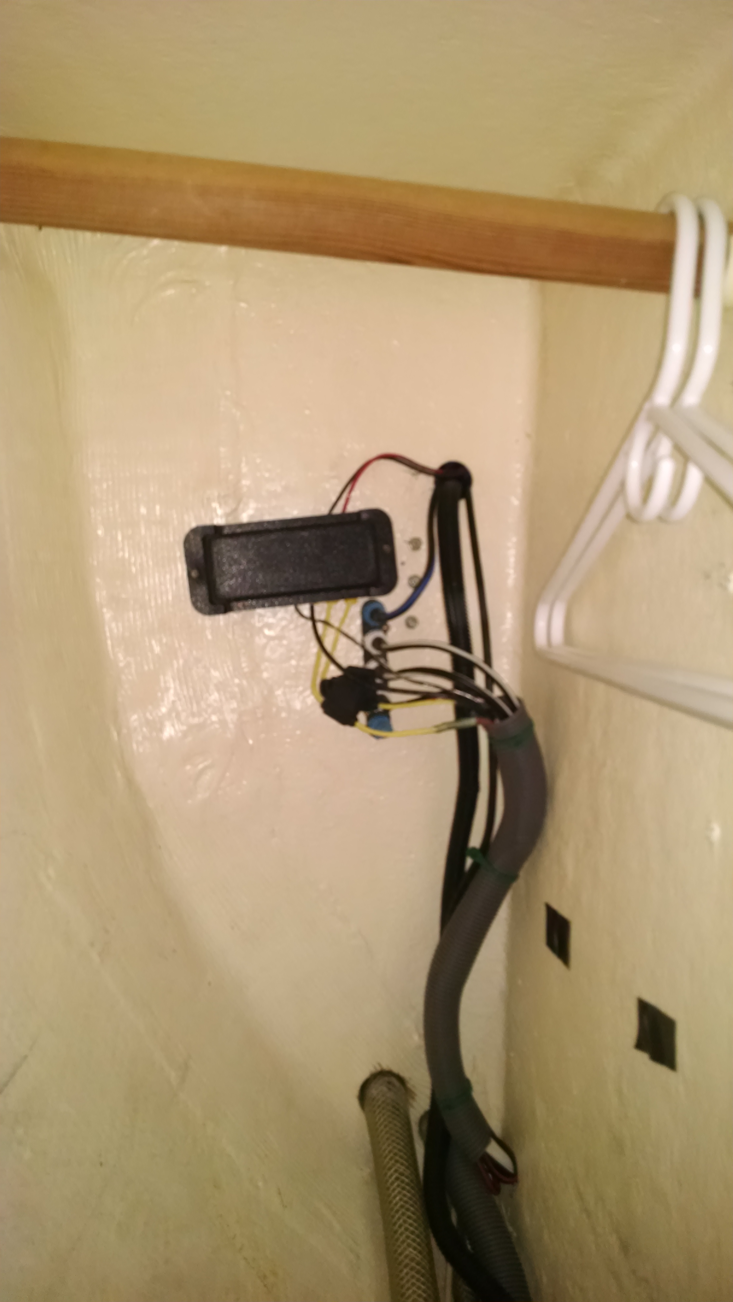

I'm sorry to say I do not know of a less expense way to purchase and install an auto pilot on C-36.  There are four primary components to Raymarine Wheel Pilot.
  1. The wheel drive, simple and straight forward to install.
  2. The control head, for me it was a simple replace.  I have Garmin instruments so it was necessary purchase a NMEA 2000 to SEATalk cable.
  3. Electronic compass unit.
  4. The ACU unit device that links the other three components an supplies the power and direction control to the wheel drive.  (Left hand picture) The ACU is on the left and the compass is on the right, on the outside of the hanging locker in aft cabin. (Right hand picture) The VDC power and communication conections are show inside the hanging locker.
It's not necessary to show the control head, just another instrument to be mounted on or near the helm.  The wheel pilot is stand alonedevice  mounted on the wheel itself.
Hope this helps,
