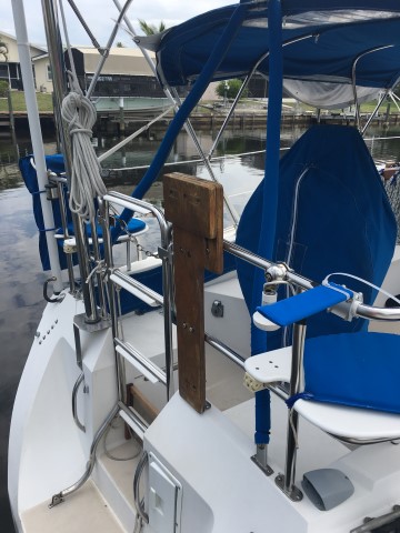

We have two wooden blocks that form a sandwich around the stern pulpit (routed out for the railing).
Pictures below, one with the motor off and the other with our old gas outboard attached (we switched over to a Torqeedo electric a few years ago).
Ours is a MkI, but you should be able to fabricate something similar for a MkII....

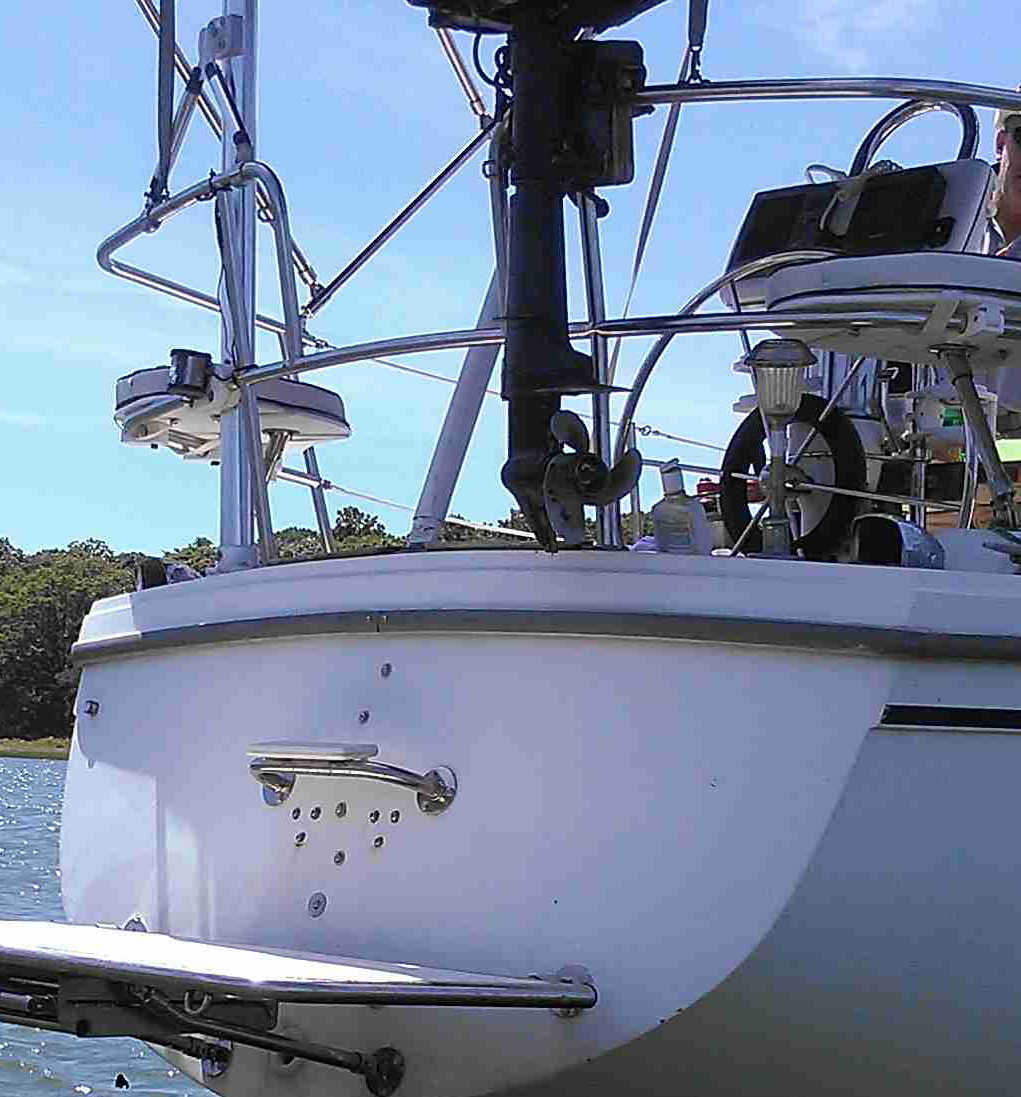

Posts: 738
MIke-
Here's a shot of our outboard mount. The davits adequately support the dinghy with outboard when we use our smaller 3.5hp engine. WIth our 9.9hp outboard, we remove it from the dinghy and store it on the stern rail mount. I had to add a 1" thick PVC block to the top of the stern rail mount to raise the outboard so the lower part of it would clear the swim seat.
Paul

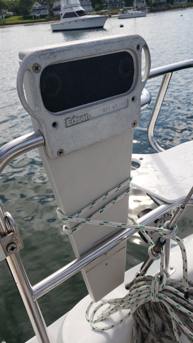

**UPDATE**
Found this nice Edson motor bracket at a marine consignment shop for $200. The motor isn't actually that heavy, about 30#. The important thing is tying the port aft side of the dinghy to the transom while removing or placing the engine. See pic... (note the safety rope so my $200 didn't go over board).

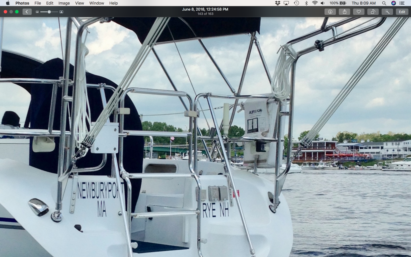

Anchorsaweigh's picture
Anchorsaweigh
Joined: 5/30/16
Posts: 30
Did mine on the side. Perfect position for the lifting tackle and doesn't interfere with the seat.
Cheers
Bob
Lazybones - 1999 Catalina 36 MkII, M35B, #1731
E. Greenwich, RI
McFly
Joined: 10/22/18
Posts: 200
Hey Bob, that looks great.  I ended up with the Edson motor mount, has been a good solution for us.  It does interfere with the seat which kinda stinks when the kids are swimming off the back.  I'll look for lazy bones in Cutty this summer!

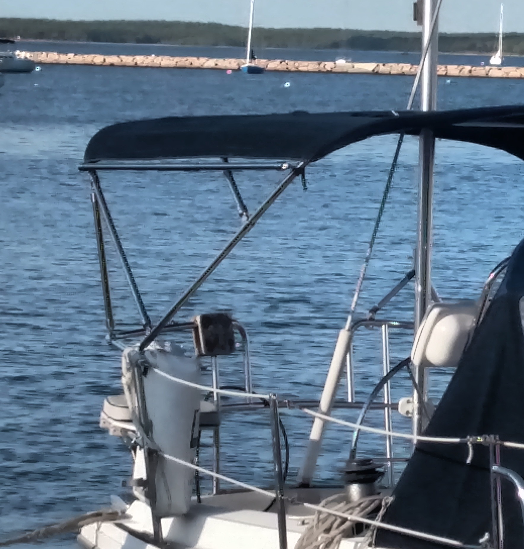

Posts: 392
Mike;
 After looking at the Edson bracket,  we built our own motor bracket out of marine plywood. What was important to us, was that the entire weight of the outboard was not placed directly on the stern pulpit rails and applying a rearward pressure. As you might be able to see from the attached picture,  the 'leg' of this bracket comes all the way down to deck allowing the weight of the motor to rest more on the deck rail than the stern pulpit. The wooden bracket is attached to the pulpit with 1" u-bolts. We also wanted the bracket to rise a little higher in the air to ease in handleing as we have a long shaft engine.
One other crazy thing we did was make a contraption to rinse the salt water out of our outboard in order that we would not have to remove the engine from the boat every time we used the outboard. This is nothing more than a five gallon bucket with a few lines on the top to secure it to the top of the engine with a fresh water hose placed in it. The engine's exhaust water tube is extended outside of the bucket using a small fitting we found at the airplane model shop and a piece of similar size hose (White in the picture).
Crude - but saves our back from having to lift the engine off the boat every time we return from a cruise.
