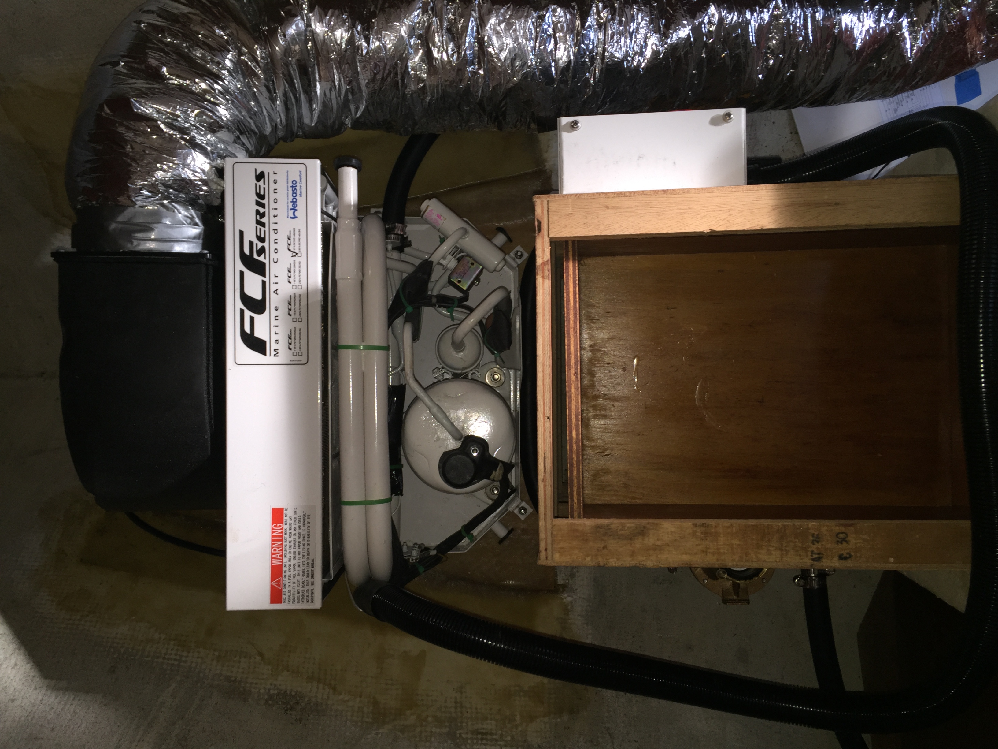

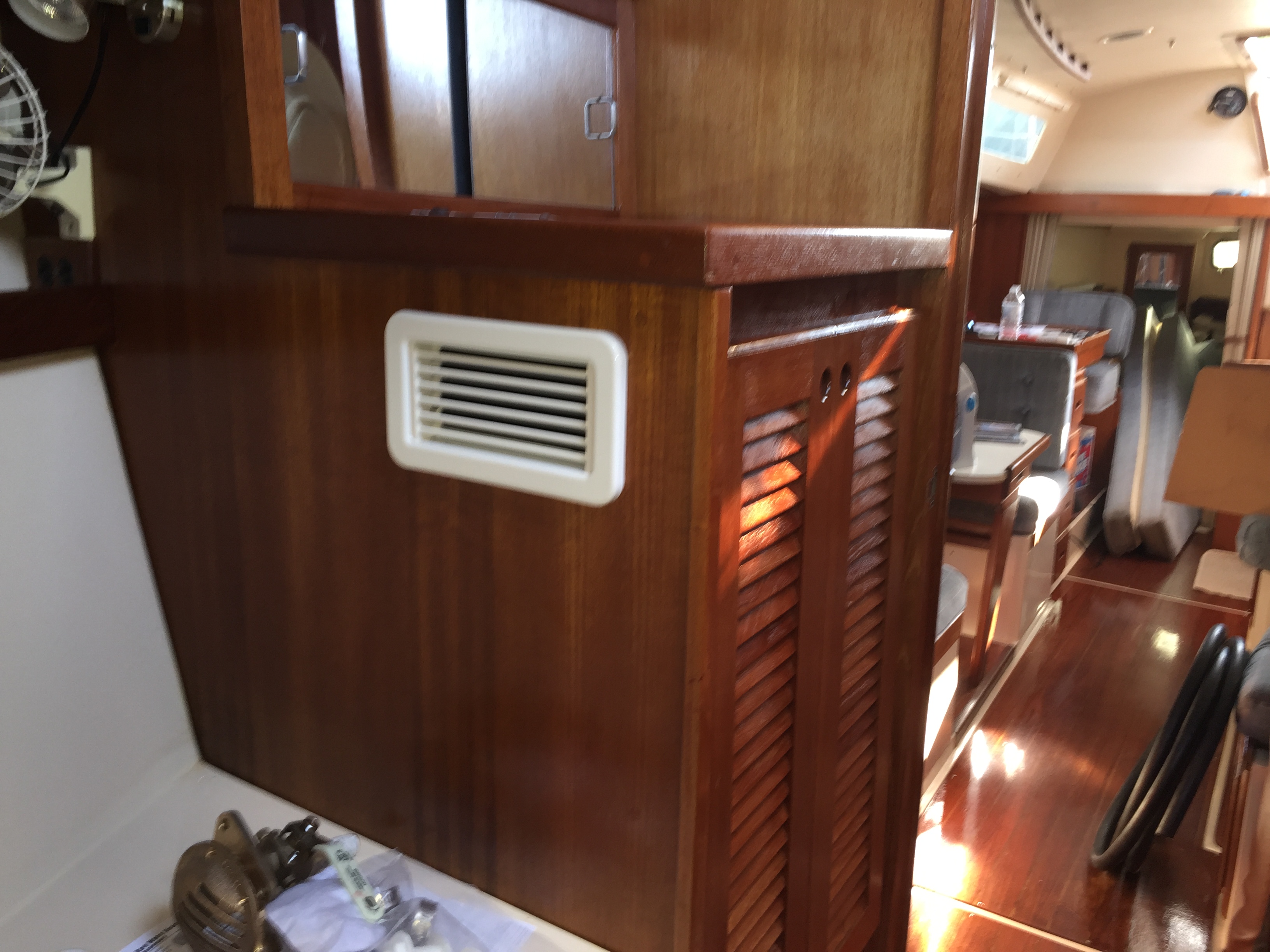

I installed a Webasto 16000 BTU unit in our V-berth last year. We have one vent register in the v-berth starboard locker and the other register goes into the main cabin via the same locker but the opposite side. I glassed in a shelf for the unit to set on. We purchased the complete kit that had everything needed to install it. It has worked great in the hottest days and the coldest nights. In North Carolina we get a bit of both.
