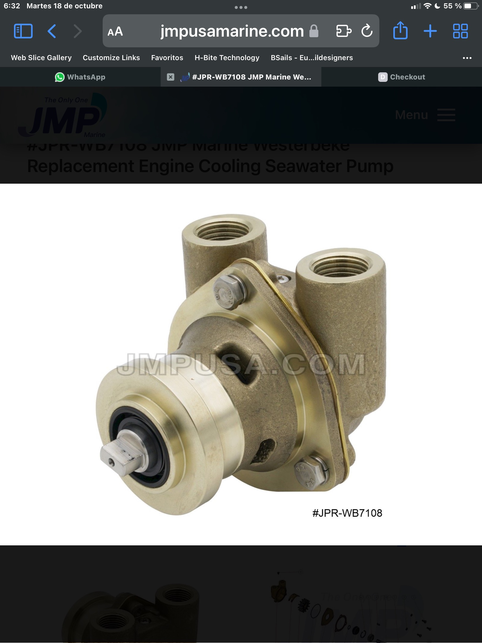

I will replace without any doubt. JMP manufactures marine pumps as OE for many engines. We installed one and works perfect, I'm not sure the oberdorfer has the same flow as the original Sherwood, you can find it, in many places. www.jmpusamarine.com

Which JMP Model did you buy? Seems like there are none available on that site for a Universal M35B

Our engine is M35A, row water pump looks to be different to M35B, I guess you can ask JMB pumps, they are all full bronce and around $400.
We bought the pump from www.bigblueoceanmarine.com you might want to ask them.
