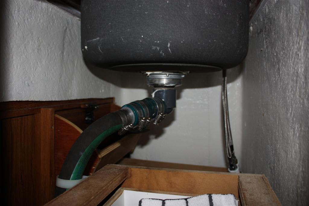

Just for my benefit learning how to post photos, here's some of the sink replacement we did some time ago.

Nice work Dave, it looks good.

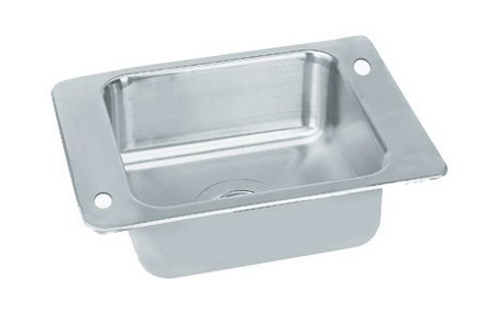

   We always found the small double basin sink to be a pain to use -- too small to work comfortably in.   After searching around, I found a single sink that fit the overall dimensions of the existing sink's cut-out, so that we didn't have to redo the cabinet top.  Elkay model DRKR2517C, cost about $350.   The stock hole patterns would not have worked for us, but it can be ordered - as we did -- with no faucet holes, allowing us to cut and place the various faucets we have (hot/cold pressure water faucet, filtered water faucet, and fridge pump-out drain spout) where we wanted them.  The overall sink is 25" x 17" (same as the existing double basin sink), but the actual bowl is about 16" x 13.5", and about 7.5" deep.

Note that after some searching the model that Matthew bought from Elkay is in early 2018 listing for between $600 and $1,600 USD!  There is a competitor's model that comes with only two pre-cut holes back right and front left for about $350 USD on the WebstaurantStore online: manufacturer is Advance Tabco SCH-1-2317 is the model number.  It's called a top mount or drop in classroom sink.  Likely the high prices are 'institutional prices' for impoverished school boards as the realistic cost of a press-formed stainless steel sink is the same for a home kitchen as a school...
That's odd that the price jumped up so much.   We bought ours from a local plumbing supply house; perhaps they gave us the "trade" price.
