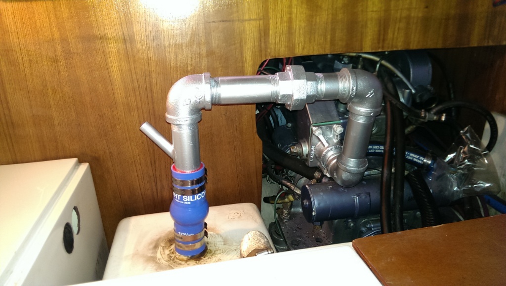

Exhaust Riser Rebuild

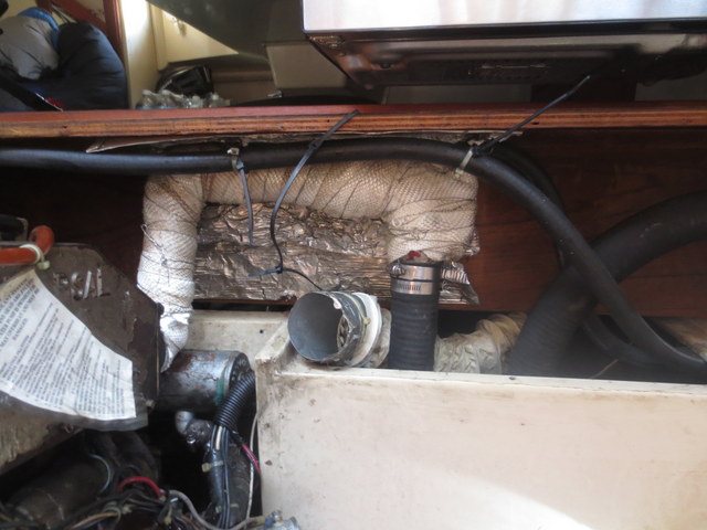

This is the thread I was going to post before the electricity to my engine panel went dead. Now that the electricity to my engine panel has been restored via the "reset" button, I can finally post a blurb on my new DIY exhaust riser!
I made it out of black pipe and sprayed it with silver Rustoleum high heat BBQ paint like so many of you before me.
I used 1 1/4" black pipe and 2" x 15' of titanium heat wrap to prevent the noxious smoke that comes from galvanized pipe and fiberglass heat wrap during the initial break-in period. I am happy to report that no smoke came off my exhaust whatsoever. BTW, the titanium heat wrap is not made out of titanium, but it has a beautiful titanium-like sheen, which is how it gets its name. The wrap is actually made out of pulverized volcanic rock...how cool is that?!
I used hose clamps instead of those little heat wrap straps they sell, as hose clamps seemed more secure and are reusable.
For pipe dope I used Real-Tuff with Teflon as per Maine Sail's suggestion. I really caked it into all male and female threads to prevent exhaust fumes from escaping. So far no exhaust fumes have escaped whatsoever.
I included a union on my riser because I read some who claim it makes adjustment/alignment easier. Mine aligned pretty much perfectly, so I guess they were right.
I reused the exhaust flange and and studs, thus saving myself $90 and $30 respectively (not including shipping). I just took all the rust off of them with a wire wheel and they were good to go. As per advice I received reading this site, I was very careful NOT to scratch the mating surface of the exhaust flange while cleaning it up.
I bought a blue hump hose from Catalina Direct in the hopes of reducing vibration to, and thus extending the life of, my aqualift.
I bought two exhaust flange gaskets as per Stu Jackson's advice. As it turns out I didn't need it, so now I have a spare just in case (or for next time around). Also, I put the gasket on dry because I learned that's how they do it at the factory.
I had to make several trips to various pipe stores because nobody had exactly what I needed. The upshot of course is now I know where all the local pipe stores are located!
I would say the hardest part of the job was removing the exhaust flange from the nipple that connected it to the exhaust riser. It required a vice, lots of rust loosening penetrating spray, a large pipe wrench, and a long pipe to fit over the handle of the pipe wrench to give me leverage. This step alone took hours before the exhaust flange finally budged and began to slowly turn off the nipple it was frozen to. I'm not sure that I would have kept at it until the flange broke free if I had not read accounts of other C36IA members relating similar struggles to get that sucker to break free!
[B]QUESTION: When I hooked up the hoses from the riser injector nipple and heat exchanger to the anti-siphon in the cockpit locker, I couldn't remember which hose went on each side of the anti-siphon. My question is does it even matter which side of the anti-siphon they go on, or is it possible that I put them on wrong? [/B]
PS Almost forgot, I spent about $70.00 on black pipe. The stainless steel prefabricated M-35 exhaust at Catalina Direct costs $400, not including shipping. Big savings!

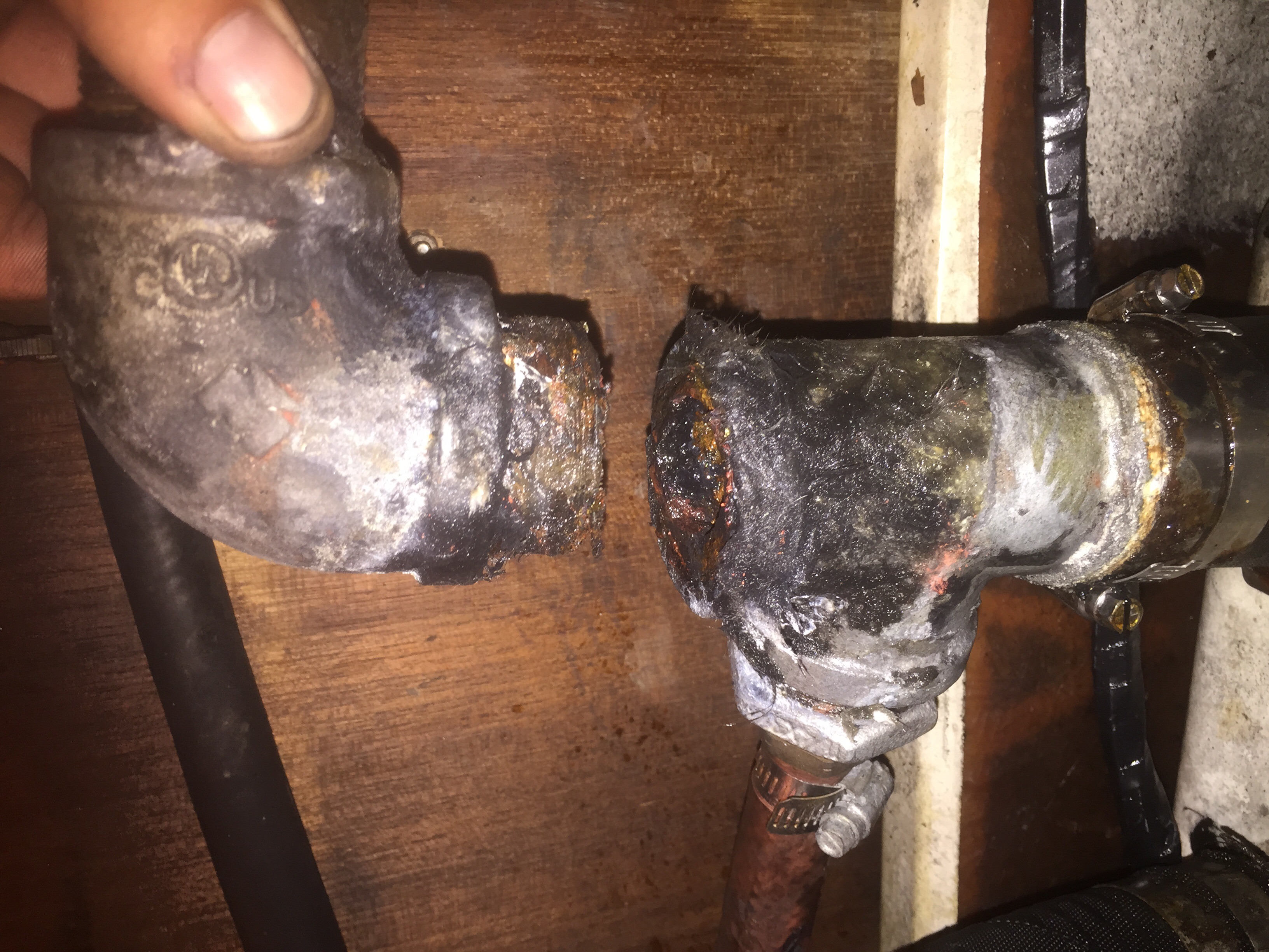

I want to thank you for this. I used it for reference in my rebuild.

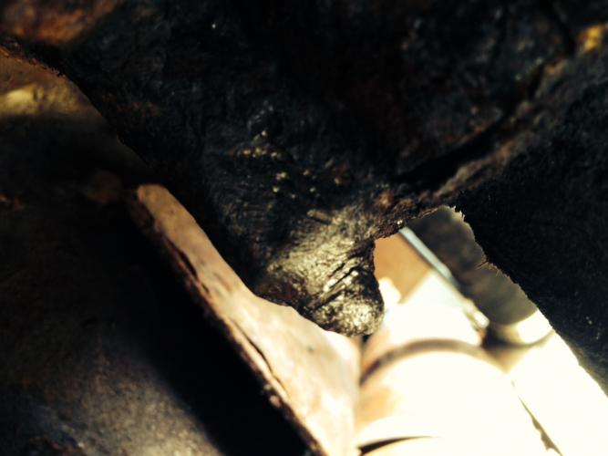

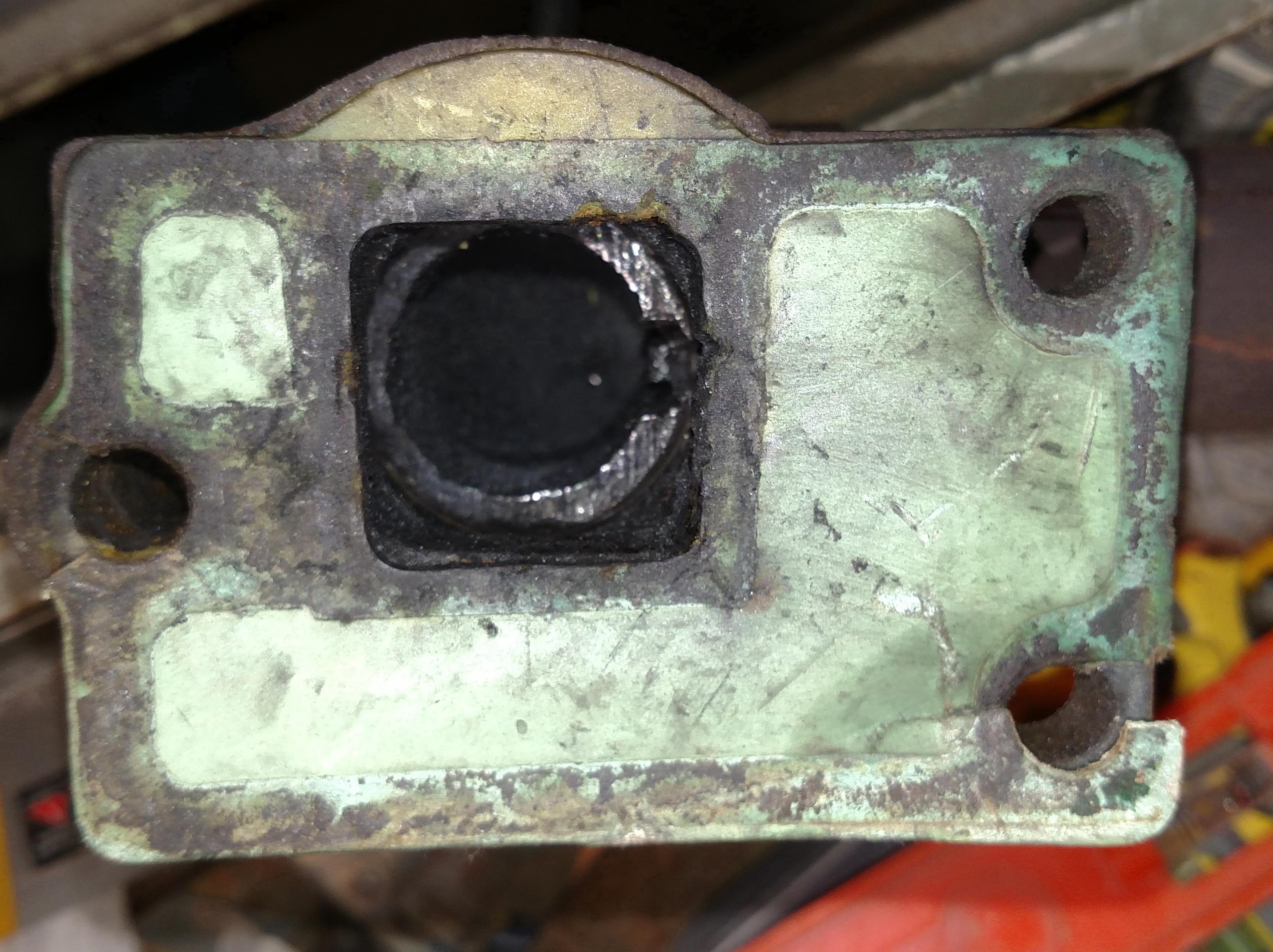

My flange was so rusted that the bottom bolt was just a dome (see photo), so my wrench could find no purchase, so I had to use a cut off. I was bummed, because I would have to order new studs from Catalina Direct and make another four hour drive to the marina the next week. On a whim, I tried NAPA auto parts, it turns out studs are common, and a whole heck of a lot cheaper than from CD! I too used the union, but things weren't matching up with the black pipe, so I had to buy some galvanized (it's all they had) from the local small town hardware store.
In all my rush to get all the tasks I wanted to get done with a valuable just-dad-no-kids-no-dog-no-wife-work-on-the-boat weekend, I didn't even start the engine! (I still want to replace the fuel filters, and I ran out of time). I guess I'll find out this weekend how much the galvanized stinks.

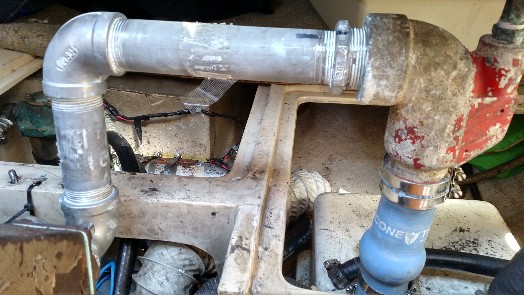

[quote=JAS] I would say the hardest part of the job was removing the exhaust flange from the nipple that connected it to the exhaust riser. It required a vice, lots of rust loosening penetrating spray, a large pipe wrench, and a long pipe to fit over the handle of the pipe wrench to give me leverage. This step alone took hours before the exhaust flange finally budged and began to slowly turn off the nipple it was frozen to. I'm not sure that I would have kept at it until the flange broke free if I had not read accounts of other C36IA members relating similar struggles to get that sucker to break free! [/quote]
Last month, during the first week of a month-long summer vacation cruise to Maine, our exhaust riser broke at the elbow by the exhaust flange. Having read the posts here about either the delay in getting  a replacement from CD or the arduousness of fabricating one with pipe fittings (and the need for some hefty shop tools), I had serious concern that the vacation was over for now.
As luck would have it, however, we were about 1/2 an hour away from a fabulous boatyard, Eaton's, in Castine, Maine.   As soon as I saw the inside of the shop (see picture below), littered with tools and old parts, I knew they could fix anything.  The owner, Ken Eaton, was fabulous, we worked together for much of the next day (with breaks so he could launch schooners and so forth) and got the job done by the afternoon, after a 40 mile drive to get plumbing parts.

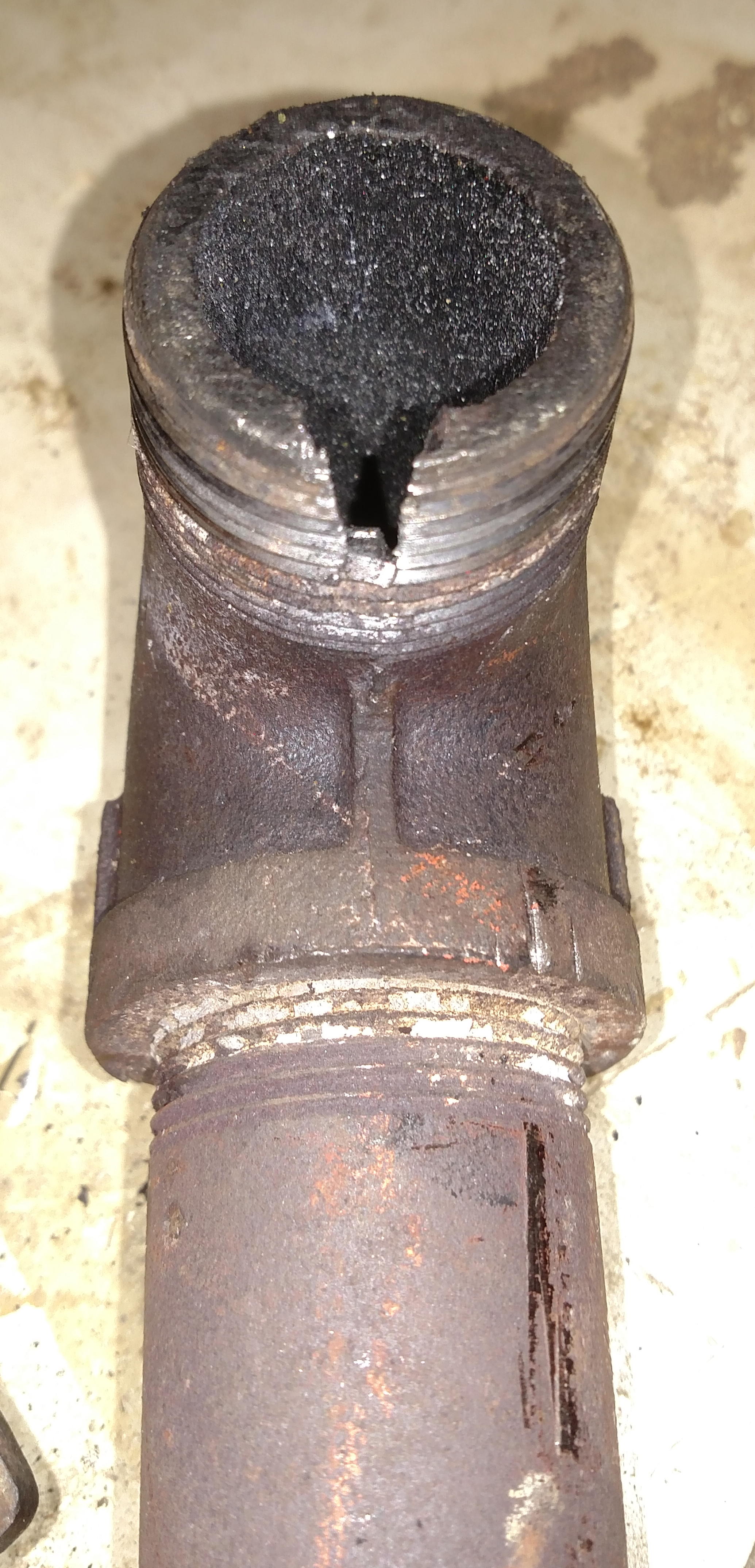

Anyway, the secret to getting the rusted in pipe elbow out of the flange is the very careful use of a Sawzall on the inside of the elbow (in my instance, a fragment of an elbow); a cut or two just deep enough to allow it to be tapped with a chisel and collapsed inward on itself frees it from the threads on the flange (same with the injection elbow).
Of the 3 items that had worked their way to the top of the list of remaining winter service projects that I hadn't gotten to -- rebuild the head, repack the stuffing box, and replace the exhaust riser --  all 3 managed to fail in the first week of our summer cruise. (At least we didn't get to #4 -- standing rigging). After that, it was all smooth sailing!
[quote=Chachere][quote=JAS] I would say the hardest part of the job was removing the exhaust flange from the nipple that connected it to the exhaust riser. It required a vice, lots of rust loosening penetrating spray, a large pipe wrench, and a long pipe to fit over the handle of the pipe wrench to give me leverage. This step alone took hours before the exhaust flange finally budged and began to slowly turn off the nipple it was frozen to. I'm not sure that I would have kept at it until the flange broke free if I had not read accounts of other C36IA members relating similar struggles to get that sucker to break free! [/quote]
Anyway, the secret to getting the rusted in pipe elbow out of the flange is the very careful use of a Sawzall on the inside of the elbow; a cut or two just deep enough to allow it to be tapped with a chisel and collapsed inward on itself frees it from the threads on the flange (same with the injection elbow).
[/quote]

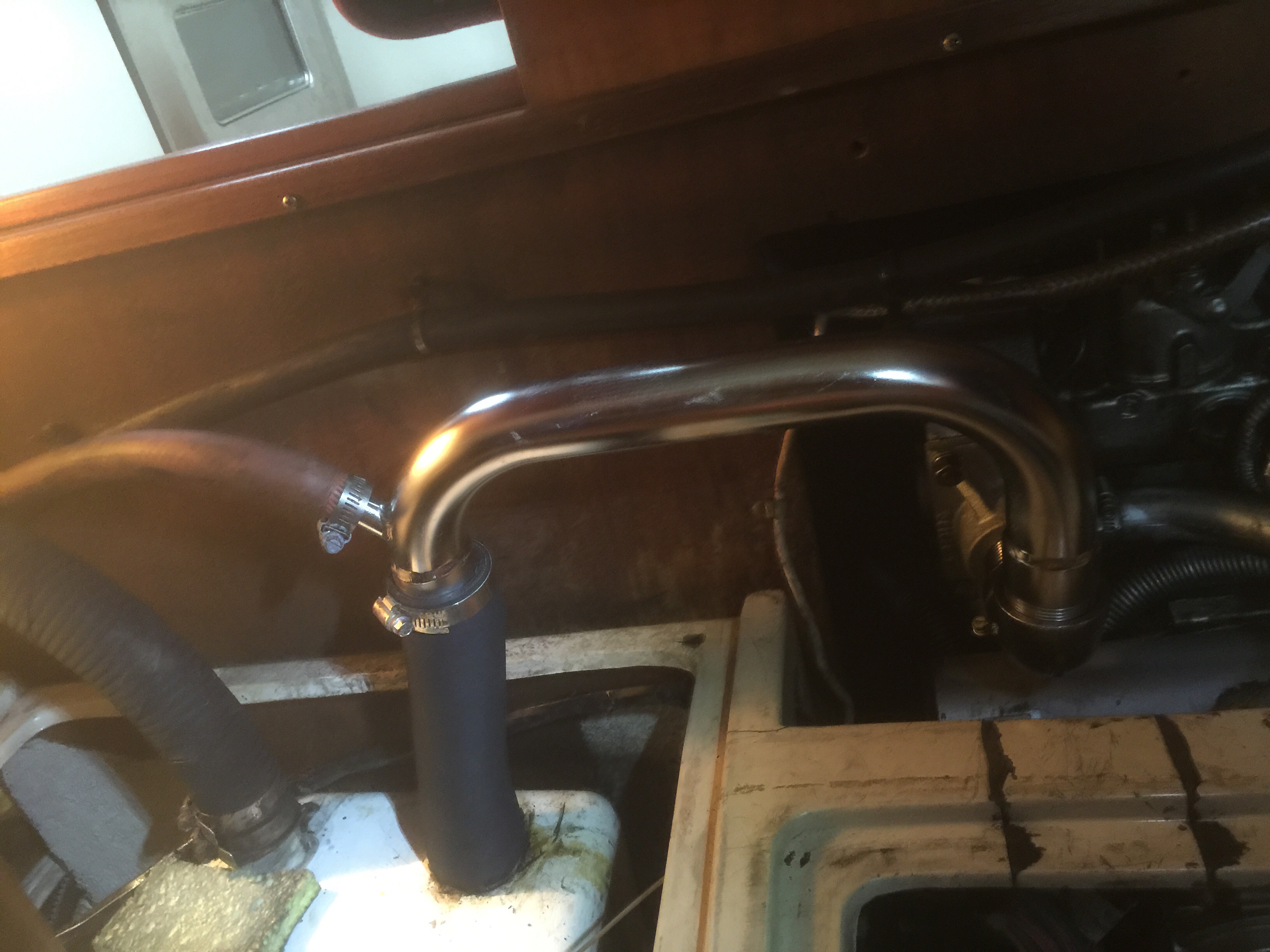

I'm rebuilding the riser over the winter, this time out of Schedule 80 seamless stainless pipe and fittings.

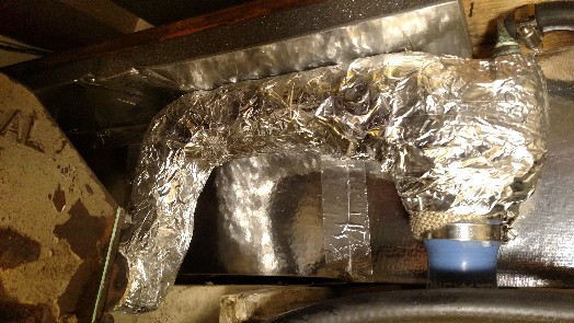

So I took a couple of pictures to illustrate the technique of cutting some slots into the pipe fitting from inside the exhaust flange. (I only had 1.5 seasons on it and it was still impossible to unscrew).   Works like a charm.  Once you've made 2 cuts from the inside of the pipe almost -- but not quite -- to the threads of the flange, wedge a screwdriver in the slots and whack it a few times with a hammer.  The notched segment will be torn out. Whack the outside of the pipe near the cuts a couple of times to loosen, and it will now unscrew easily.
[quote=Chachere]
I'm rebuilding the riser over the winter, this time out of Schedule 80 seamless stainless pipe and fittings..... [/quote]
Here are some pictures of the assembled replacement, fabricated from schedule 80 seamless stainless pipe (not galvanized).   Stainless seamless schedule 80 pipe is tricky to find at your average plumbing supply or big box hardware store, but Grainger's has it and can be purchased online or delivered to their store.  Last picture shows it after wrapped first with fibreglass heat insulation tape and then metal tape.

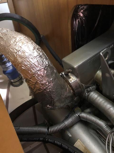

I own hull 1897, 2000 model, with m-35B engine.  Recently developed leak on top of water muffler.  I suspect leak is in the blue hump connector.  I cleaned the tank top surrounding area adjacent to lowest clamp with alcohol and wire brush - wiping away some dried mineral deposits and could occasionally see a water bubble form while running motor.  My gut feel is the hump hose has a slight crack in it and should be replaced.
1) What is the size of the replacement hump hose blue connector? I don’t want to cut out the original connector with out having replacement on hand.
2) Will I have to remove the metal insulated connector tube coming out of the engine to slide the hump connector ?
(The 15 page article on this subject in the C36 Facebook page is very well done)
Thanks in advance for your hints.
peter g
2000 C36, MK2, Hull. #1897

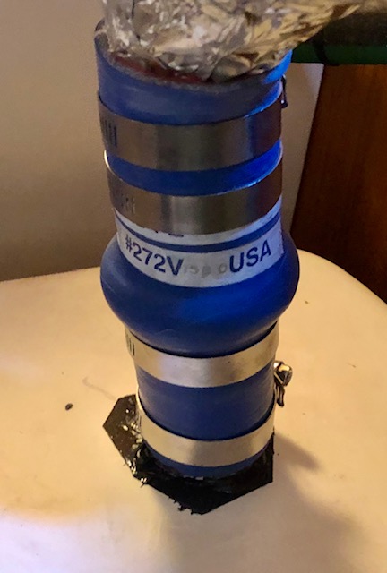

See two pictures.  Riser pipe is stainless steel.  There is no drip evidence of water at the water injection tube (6-8” above tank).  When engine was running I was able to spot a few intermittent bubbles where there black sharpie mark by the tube coming out of the tank.
I will buy a measuring caliper and probably order a new hump connector.
Larry Brandt-please also give us your opinions.
Thoughts? And many thanks.

I ground down the crack in the intake of my muffler and reglassed the nipple to the muffler.  Still folding after 2 years.
Pgutierrez's picture
Pgutierrez
Joined: 5/14/12
Posts: 233
Might be getting lucky-first try the easy way.

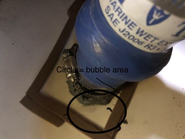

- I suspect leak is a small crack on top of tank near nipple (see picture post 28 with sharpie marks)
-,with others assistance on the forum I built up my courage... and have attempted to fix myself
-,loosened four stainless clamps and EASILY twisted blue hump connector, raising about 1/4" up above tank
- cleaned top of tank 360 degrees around tank top nipple where hump connector connects:  used wire brush, sand paper & alcohol to scruff up and clean the area.
- used painters tape (blue & green) to mask off area 1/2" around nipple, and under side of hump connector ( surface parallel is to tank top)
- mixed High temp (550 degrees) JB weld epoxy, applied layer twice. 2 days apart.
- re tightened four clamps, removing blue green masking tape
- did two ten minute runs & no leaks so far.
crossing my fingers fix is complete
