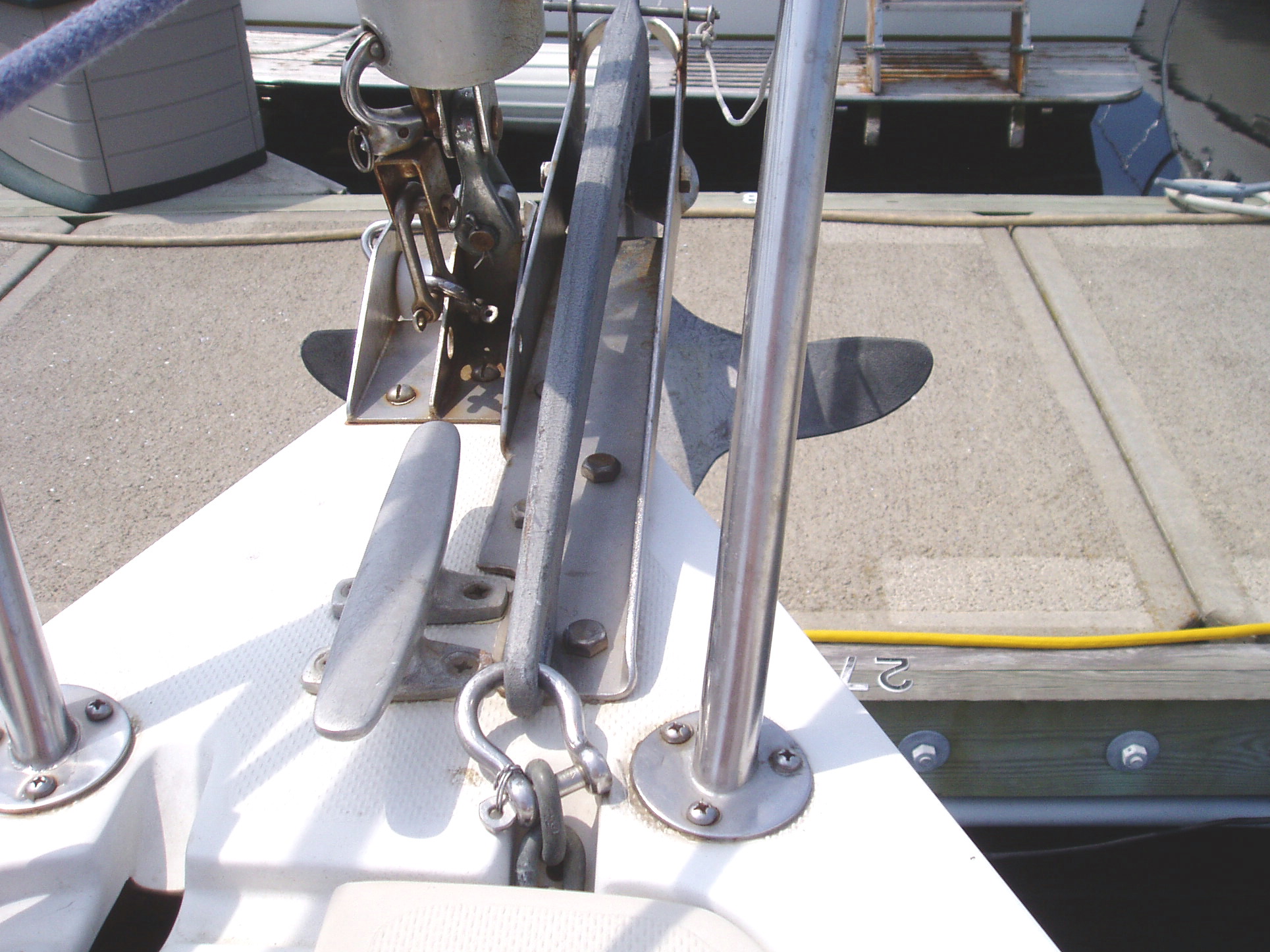

Russell,
When I cut the tiny stbd roller off, I found that a URM-6 anchor roller fit pretty well.  I had to trim it a bit to fit around the center-line cleat, but the result was worth it.  Below is a pic of a Bruce anchor mounted in it, but I think that a Rocna or Manson Supreme would also fit (don't know anything about a Rocan Vulcan). Hope this helps.

Russell,

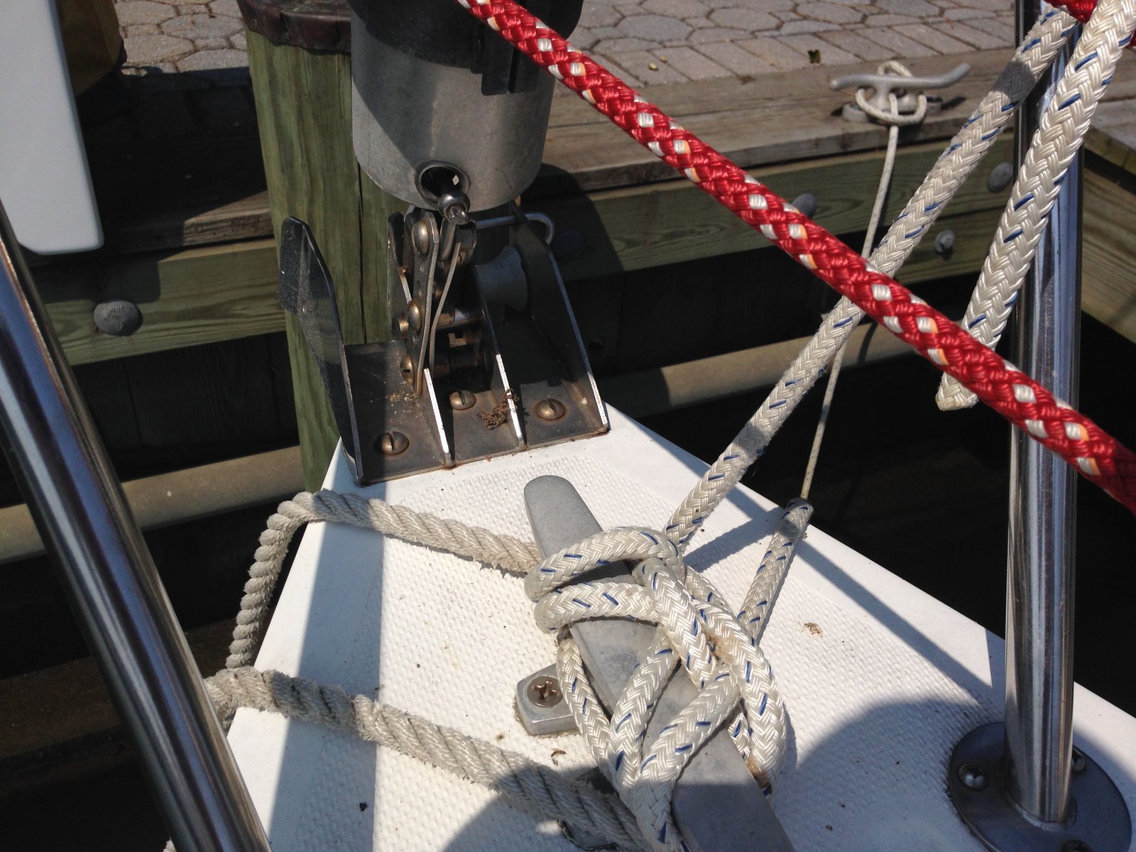

I cut off just the vertical part of the small OEM stbd roller, and used existing bolt holes where I could.  If you look carefully at the pic I posted above, you can see the construction of the stem fitting on the port side.  I believe the fitting is one horizontal piece, with four vertical pieces welded to it, plus the thicker piece for attaching the forestay to.  Hope this helps.

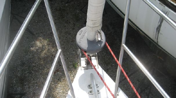

Tom,
I just located the attached photo I took when examining the boat when it was for sale.  Same setup as you described.  So your replacement roller was placed on top of the remaining horizontal piece on the starboard side?  Did you end up making a shim for the replacement roller aft of the remaining OEM piece?  Or cinch it down and fill the small gap to the deck?  Thinking I will try the original stubby roller based on Stu's feedback for now and see how it works.  Might drill a hole through its shank to key it with the existing pin.  Will retain the center cleat for the rode but add a dedicated pair of cleats for the dock lines.  Looks like with the anchor up there, there will not be adequate clearance to use the exiting center cleat.  Great feedback everyone.  Thanks

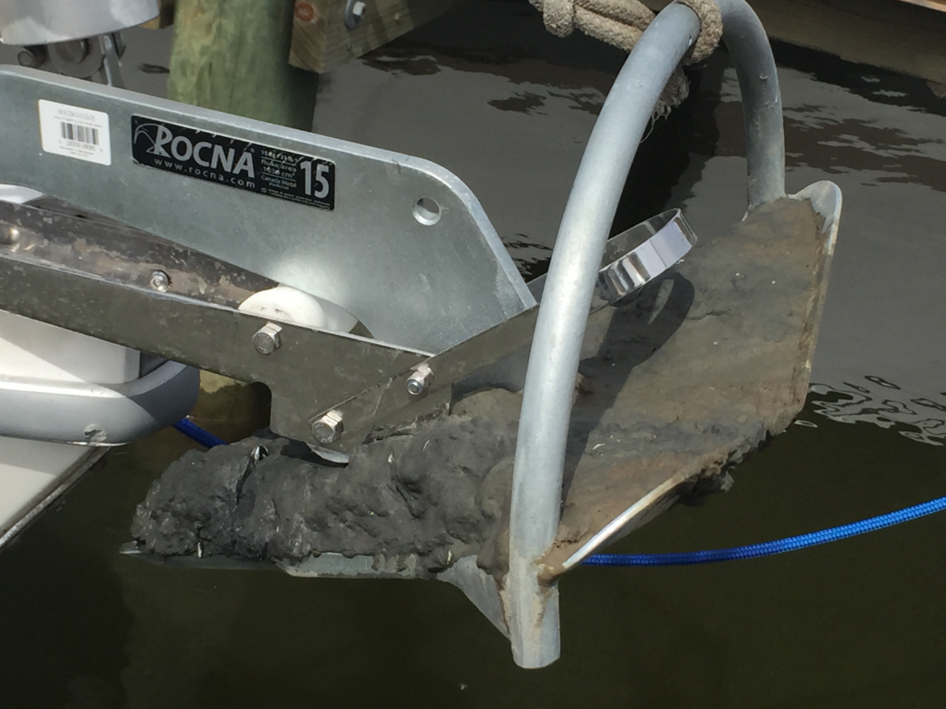

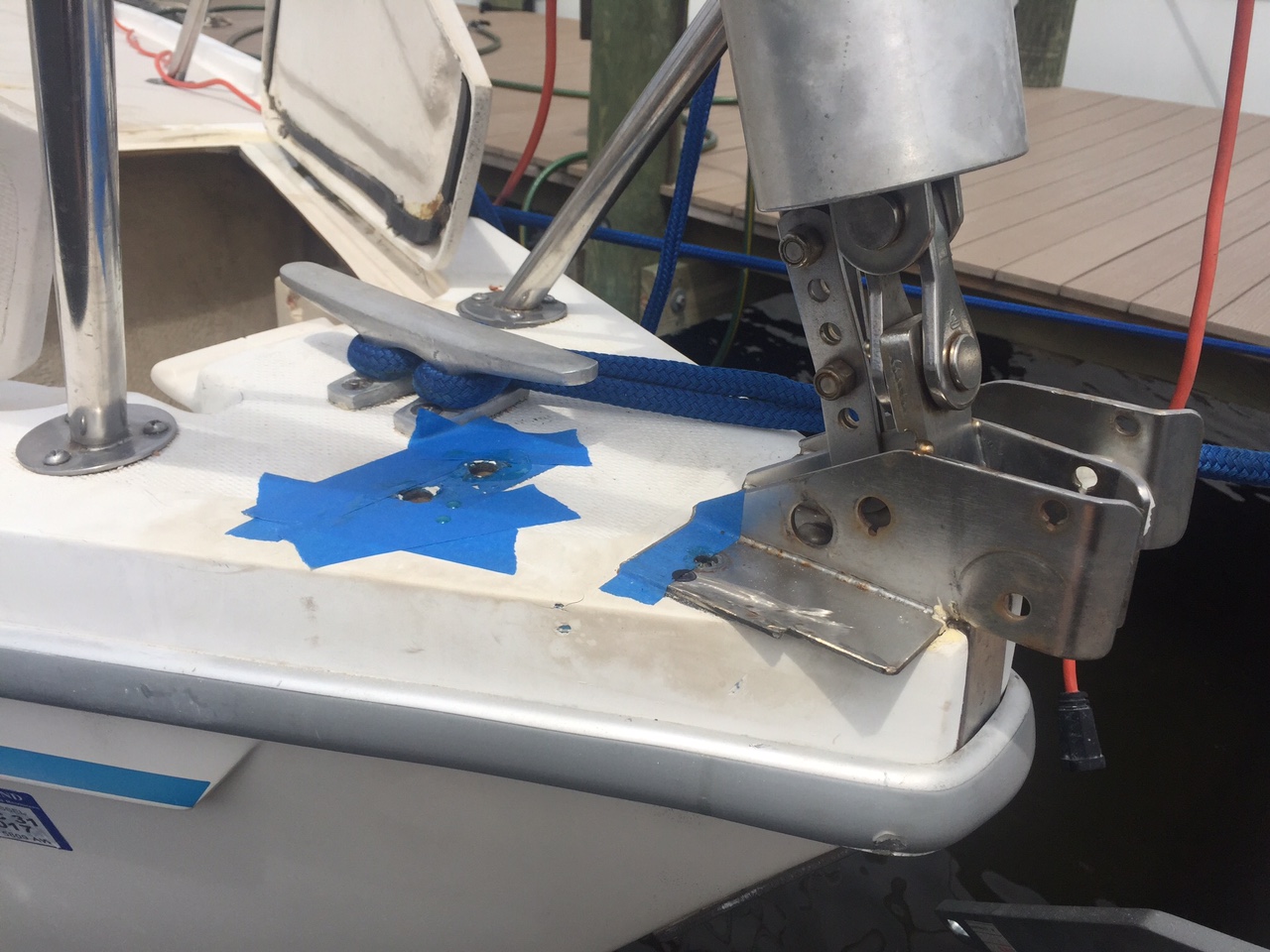

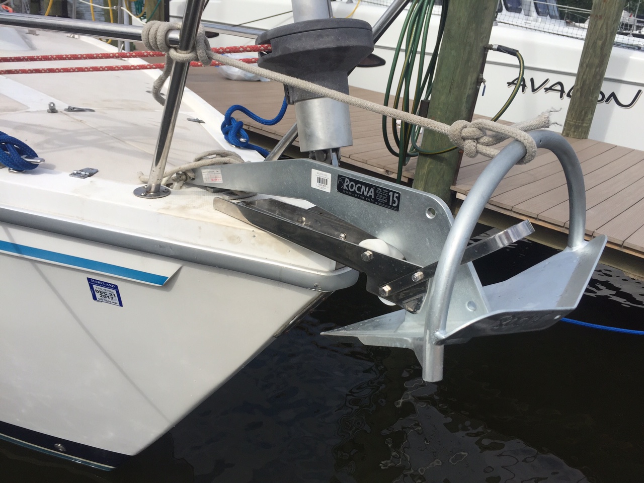

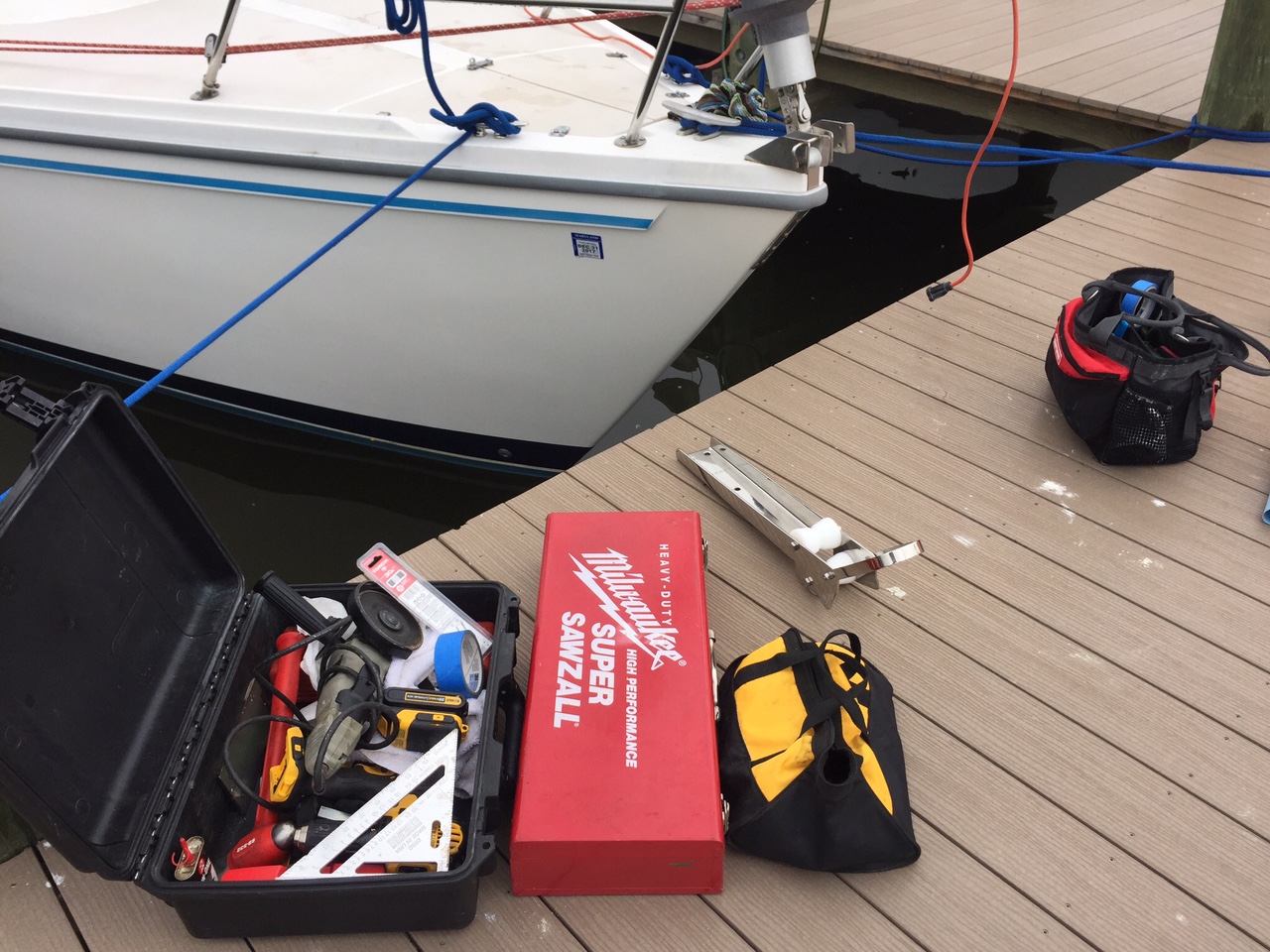

Beyond consuming three $15 Sawzaw blades, a few 13/32" bits, and pausing every 10 seconds to cool with wet towels, modifying the OEM anchor roller and installing a replacement anchor roller was a straight forward project.  4 hours in total including drilling and cutting the 3/16" SS316 backing plate.    The stains on the gel coat is cutting oil and was cleaned off later.  The ease of deployment, quick set and holding power of the Rocna is light years better than my prior setup.  I should have made the change earlier.
Russell Green
S/V "GoodwiII"  #759
1987 C36 MKI TR/WK M25XP
Moored: Deale, MD
